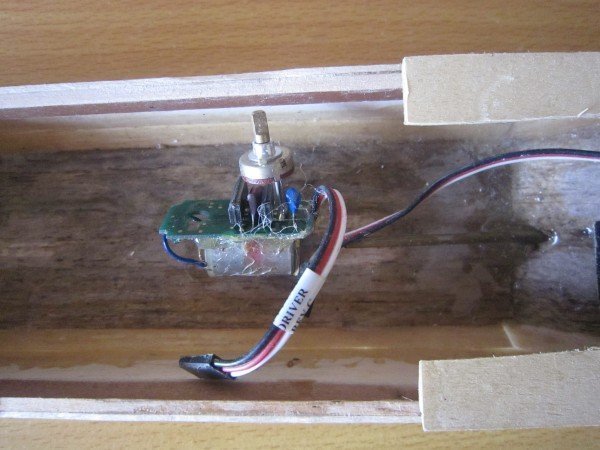

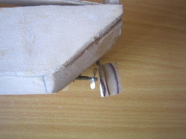

    Continuing on from my Intro,
    I've got the basic running gear set up, I had to go direct drive on the servo motor, with the tiny prop it was far too slow on the gearing in the initial post
    A standard cheap micro servo operates the rudder and a (I think) cd rom motor drives the pump, a home made affair similar in design to the old swampworks, with clear acrylic for the pump housing.
    Spent most of the day trialing the pump, could get it to prime easily with no outlet pipe but as soon as tubing was attached it wouldnt prime until the water was over halfway up the motor
    Nick

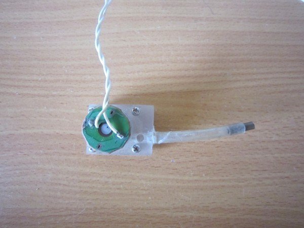

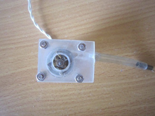

  9. nick_75au
    nick_75au New Member
    Mar 20, 2010
    7
    Pictures as ordered, Sir:p
    The pump has an ectra hole in the top view, but it obviously sprays water where I dont want it, It does work well as a bypass so the pump capacity is sort of near the flow rates in the rules. I want to make a smaller pump with less flow, p
    Nick
