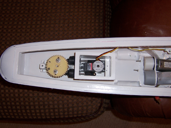

    Stern rudder box, will install the rudder gear when I put it through the hull.

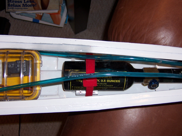

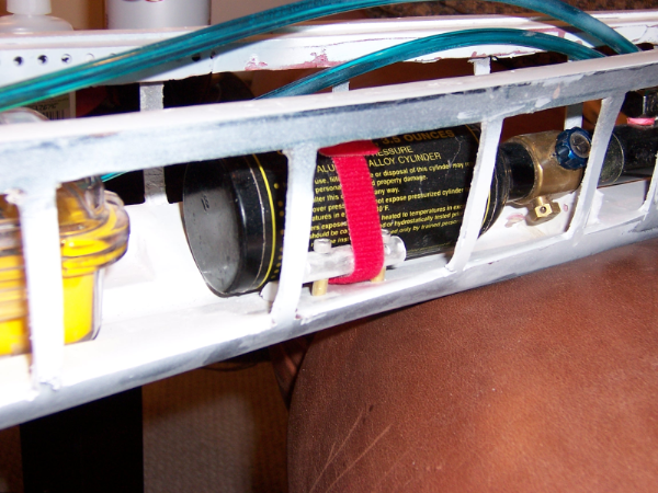

    Hold down for the bottle is done. Aluminum rod drilled and SS screws epoxied to the hull. Velcro will hold it in place.
    Simple hold down for the bottle.

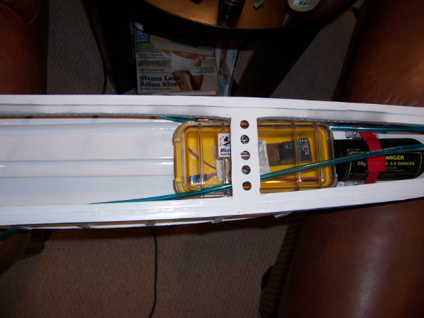

    This is where the box will set in the hull. Battery goes in behind it and sits on the rails.

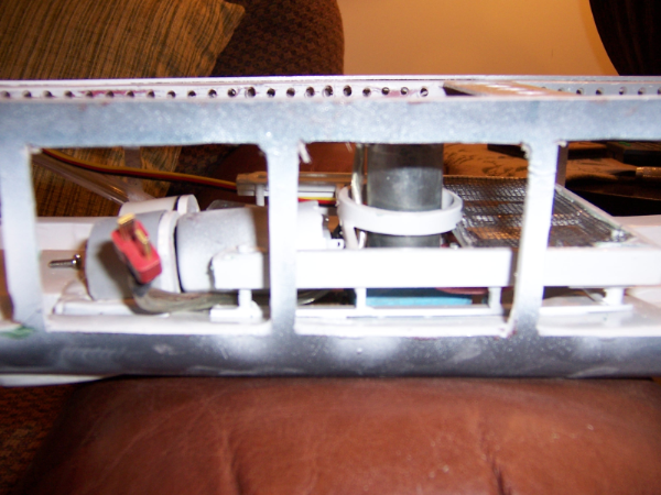

    Picture of the pump and screen. Top part comes off and the sides are attached to the hull bottom. Basically a double screen, no large pieces getting anywhere near the pump. Screen still needs to be added to the sides. Inside of the ship is painted with white epoxy paint, easy to wipe down after a battle.

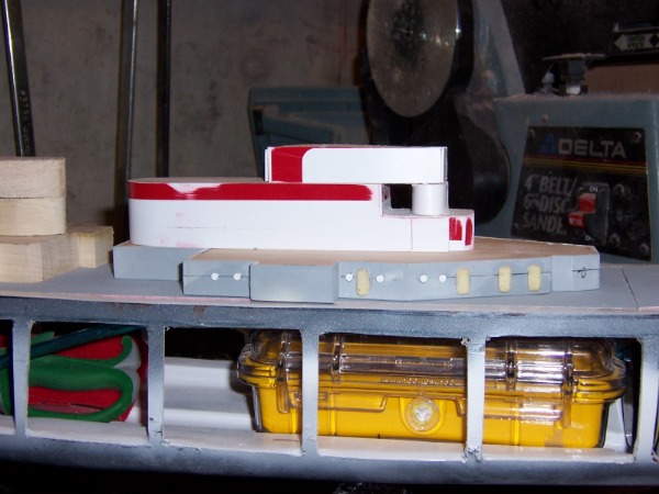

    Started on the masters for the superstructure. The super will be cast out of lightweight foam, no real give but easy to replace. Each deck will have it's own casting and a central rod(s) will connect them. So if the first level takes a beating, I can just remove the top levels, place the new first level, and then put them all back together again.
    Pine wood core wrapped with styrene for a smooth surface. Doors are cast and the portholes are plastic disks made with a punch and die set from harbour freight tools.
    Back super still needs to be cut to height and plastic installed. Turrets are done, next will be the barbets.
