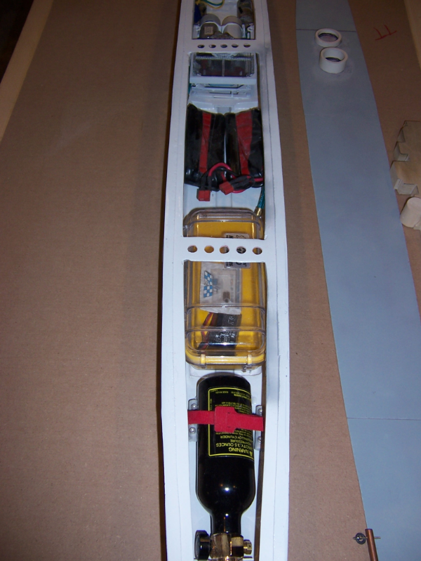

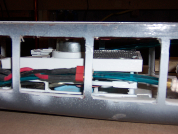

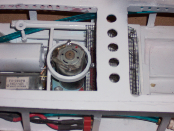

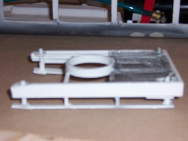

    Changes from the build

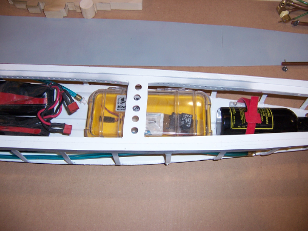

    This is the "old" box that would stop trash from getting to the pump. Screen was on the rear and sides (removed before pics).
    Cumbersome and way overkill.
    The box was great but takes up a lot of room and adds weight. Now that the electronics are waterproofed this is no longer needed.
    Batteries are very nice, but expensive. Trying to shoe horn in a larger battery (more on that later).

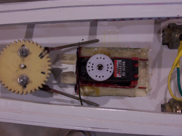

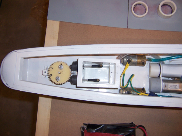

    Rudder box, this actually failed on the Aoba so it has been replaced with a mineral-oil servo.

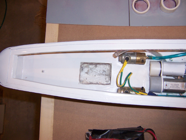

    What's left of the pump cover.
    Got to fill that hole and make a new holder for the servo. Using epoxy to fill the sides, will smooth out and paint.
    It's not very pretty right now. [:)]

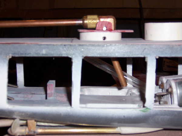

    Now working on the guns. First is to decide C or D turret. C would be great for long range sniping, but that is not my style. So D it is. I drilled out the base and made the bottom of the turret and will mount the guns to it. Then I can take off the turret and tweak the guns. The original idea was to make a hold bar in the base of the turret, but the guns set too low. I will make holder in the neck of the tee for the 1/8th bar.

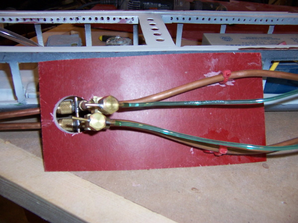

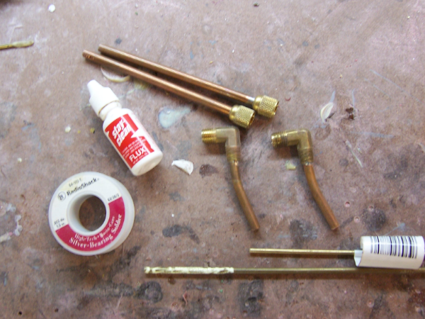

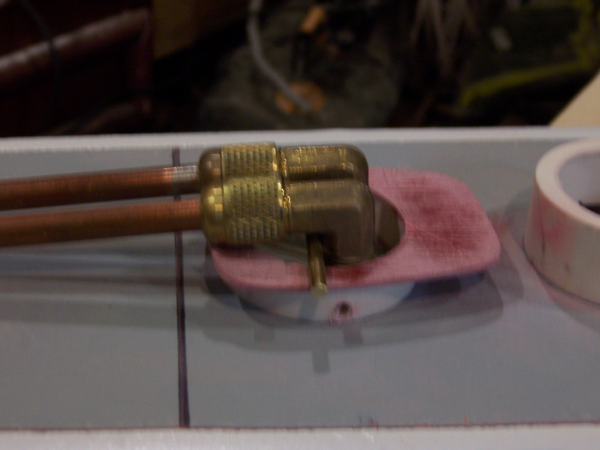

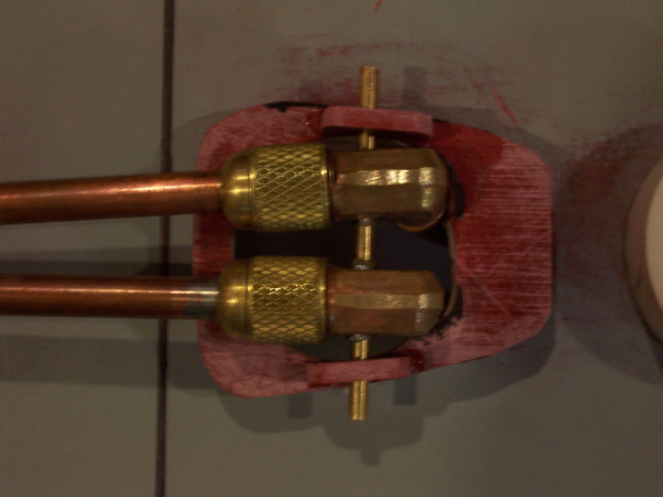

    Here's the gun parts and silver solder. I will have to cut the neck at the right angle and length.
    First I mount the guns and see how far down the uptube goes.
    You can see I added a small tube in the neck of the tee and the 1/8th rod passes through it.
    The gun is held to the upper deck by the tee and the magazines. The mounting brackets on the deck allow a zip tie to be used to secure the magazines. This makes for a rigid gun platform, but cut the zip ties and remove the 1/8th rod and you can do a quick lakeside repair.

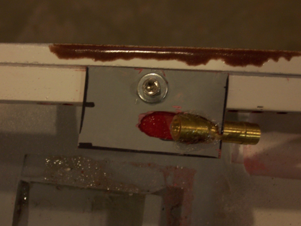

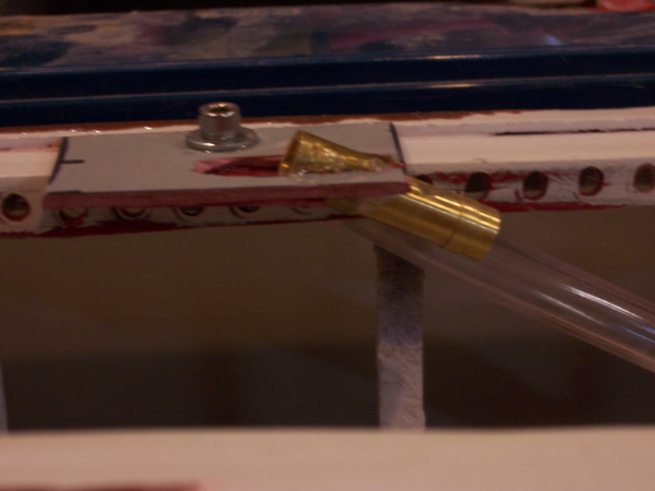

    This is the pump outlet. I like to make the outlet a permanent part of the deck so there is no slipping below and filling the hull (Been there, done that, got the shirt).[:)] The deck piece is attached to the subdeck with a stainless steel hex bolt (no rusting). The mail deck can still be removed and let the pump stay in place. Again, this makes for easy repair at lakeside. Thanks to Dave for the custom made outlet!

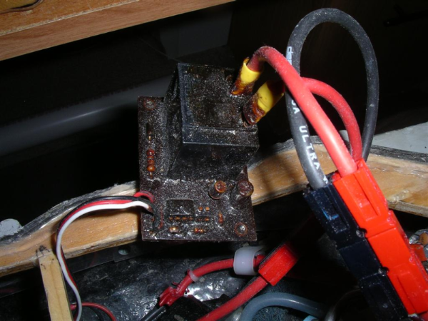

  18. SnipeHunter
    To waterproof TD boards just get all the connections set and the DIP switches in the corect positions and slather on a few coats of scotchkote.
    This is what my TD pump switch looks like.
  19. Lou
    How long does the coating last? Is this better than epoxy?
  20. SnipeHunter
    I dont know how long it lasts. It seems like its some sort of rubber/plastic type compound so it seems like it should last a long time.
    I like it more than epoxy for most jobs because it can be removed so you can change dip switches or whatever. If you have something you never need to touch, like a reciever or something, then I'd use epoxy.
