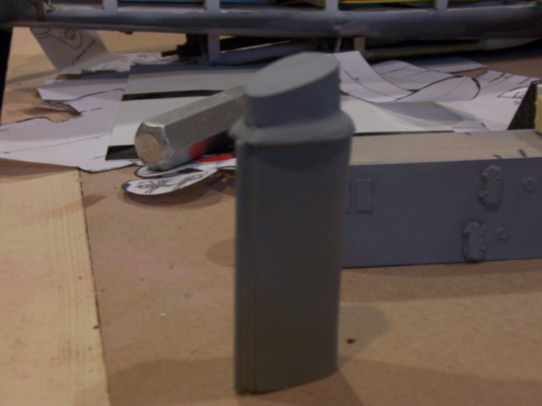

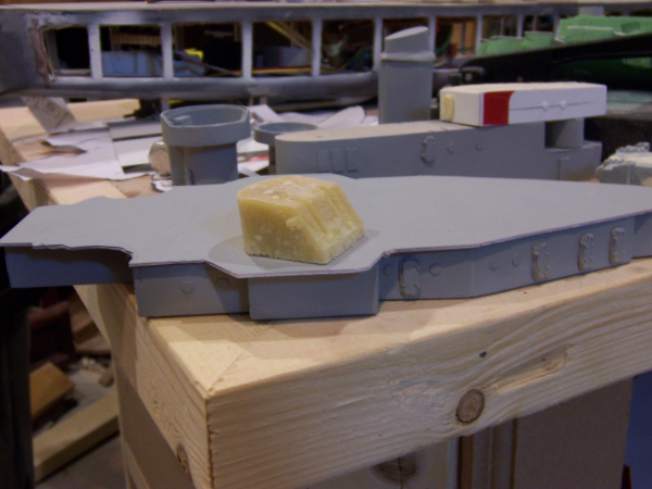

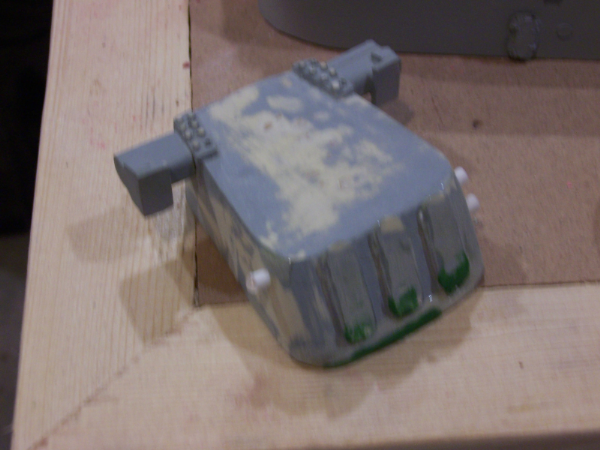

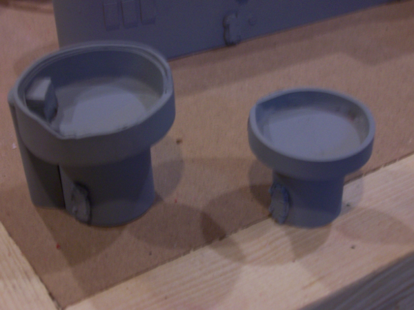

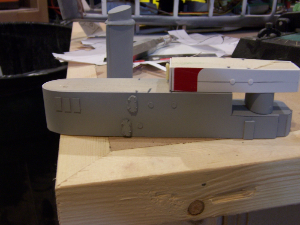

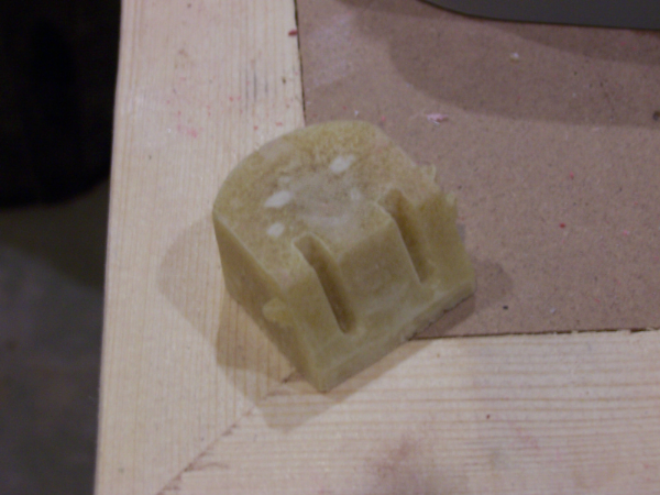

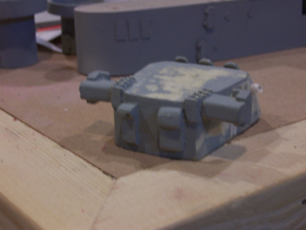

  14. Lou
    Progress on Super Structure
    Master main - still needs work
    Rear of main
    Foam secondary, same material the mains will be made out of.
    Portholes, doors, etc... This will be a single cast and the deck walkways added later. Just no way to cast at the same time.
    Funnel, more detail to be added.
    Gun tubs, still need to clean up and reshape for a better looking circle.
    Main level with top. This is ready to cast (top is placed on after casting.

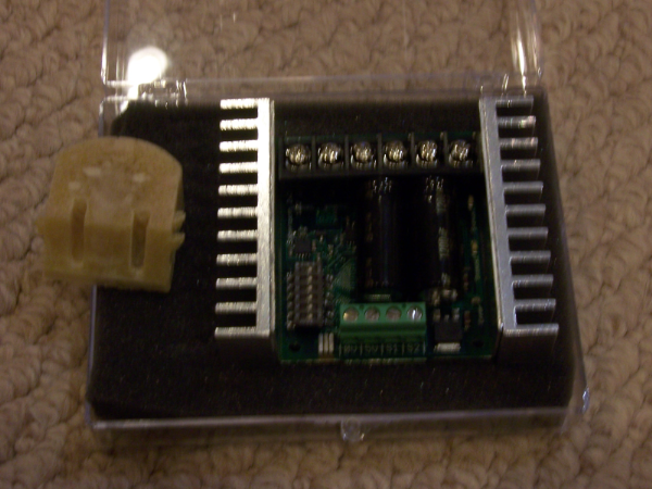

  15. Lou
    Got the speed control, it's larger than I expected but should do the job nicely. Will also fit into the next boat on the ways. Pictures later this week.
  16. Lou
    Here's the speed controller, 5 inch dual for size comparison.
