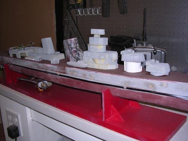

    It's been a while but it is time to finish up this build. Finally got the casting down, now I can make foam super structures.

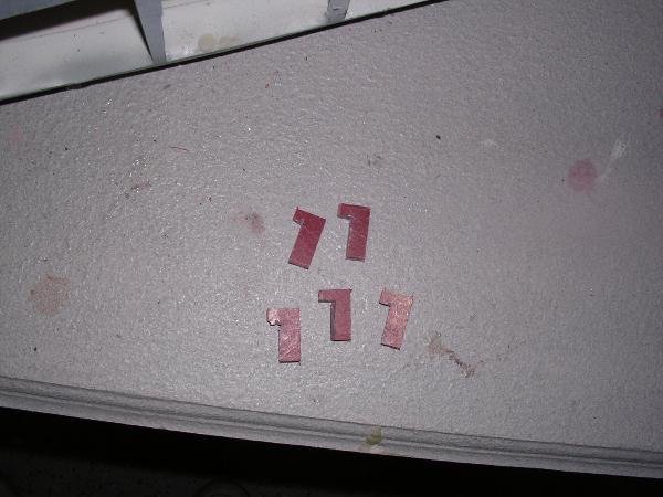

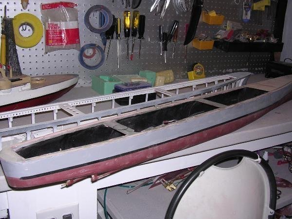

    Started work on the blast shield, using very thin Lexan from McMaster-Carr. This will allow less overall weight and provide protection to the internals. Made the brackets out of fiberglass board, they are installed every other rib and will have a threaded rod through them and attach to the blast sheild with a small nut and washer.

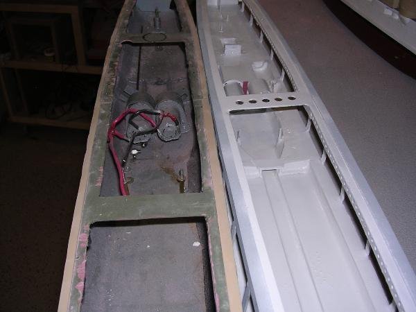

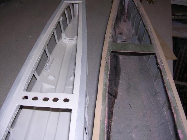

    Anyways, here is a side by side comparison of a first generation Cleveland and the new one:
    Another shot:
  7. BoomerBoy17
    Big difference. Experience will do that though.

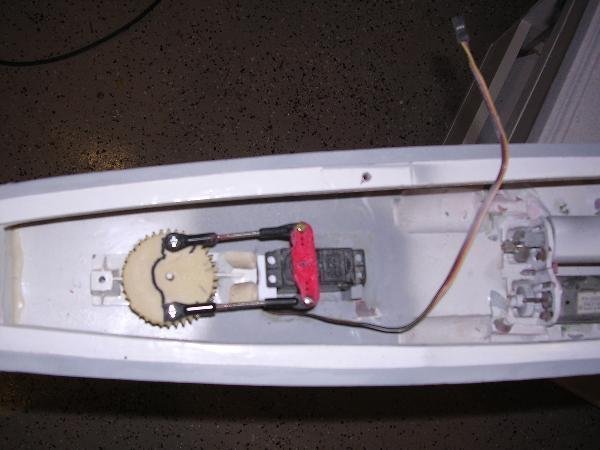

    Got the brackets installed, now starting the sheeting. Here's the updated look to the steering arrangement, I have removed the box and waterproofed the servo. Just missing the rudder and gear in the pic.

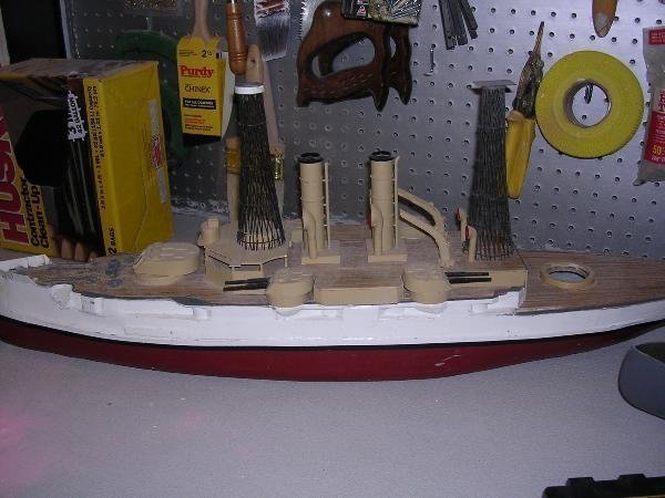

    This is a shot of the IJN Aoba with foam superstructure. Very lightweight and I can cast multiple copies so damage and weight is not an issue. I will be using this method on the Cleveland build.

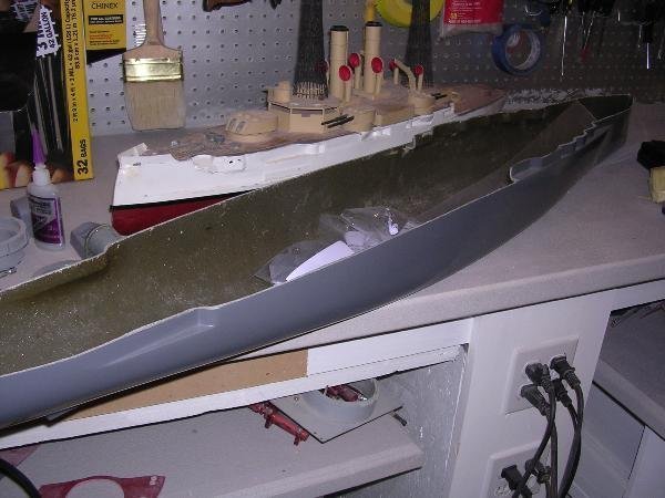

    Here's a picture of another ship in the dockyard that needs to go on a "Diet", the mighty Mississippi. Now that she can have 3 guns, it's finally worth finishing her this year.
    And in the vein of supporting a vendor, a ship in the dockyard:
