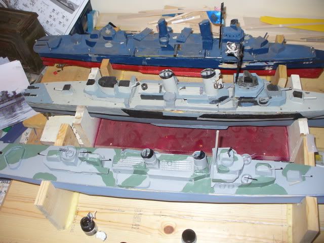

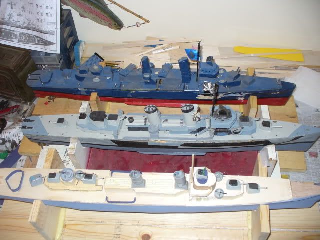

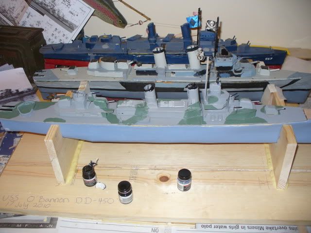

    Well, I finally had some time this week to continue work on the second Fletcher. I got a lot of the superstructure done tonight and should have it finished in a couple of days. I need to get some guns bought or built before I can really start going crazy with the internals, but I'm about ready to start getting it all set up and ready to go. This ship is the USS O'bannon and is an early fletcher, actually I believe number 2 or 3 launched so it has the round bridge and the high rear parts of the superstructure. I will be building this ship as it was when it fought in the Guadalcanal campaign. This ship fought from Guadalcanal until the end of the war in most of the major battles and did not have a single man killed. She won the Presidential Unit Citation and seventeen battle stars, and escorted the USS Missouri into Tokyo bay for the surender.

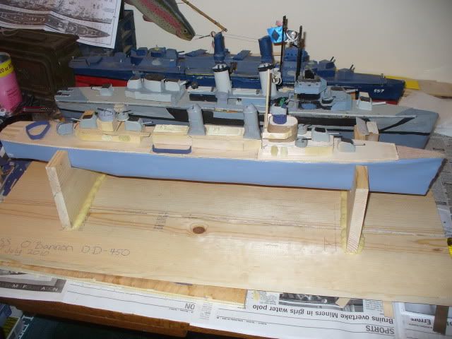

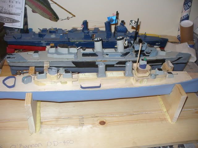

    The USS O'bannon had a totally differant camo then her sisters early in the war. It was called a modified Measure 12. I found only a few photos of it with camo, and reading it seems it only carried it for short time, but it's super cool looking and did use it during the time frame I'm going for.
    Although mine isn't a perfect copy of what the real ship had, it's close. I had 0 photos of the right side of the ship, and only pretty bad ones of the left. So what I can't see I'm making up and making it look about right.
    Here you can see the early style bridge compared the the later square bridge of the Kidd next to her.
    I am hoping to have the hull pretty much ready for paint tomorrow and then will finish the funky camo and have some cool photos.

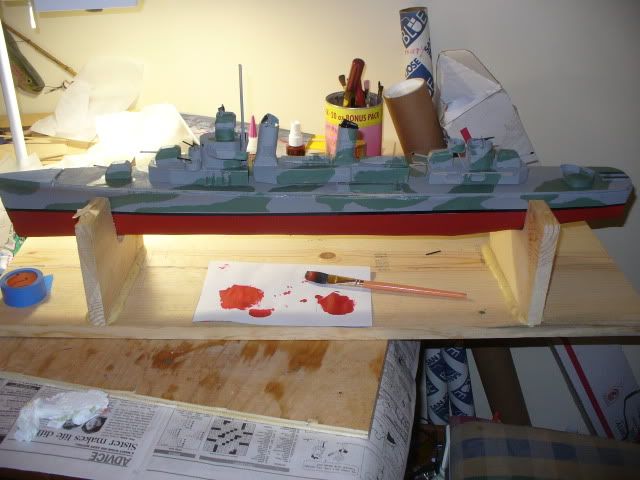

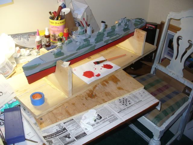

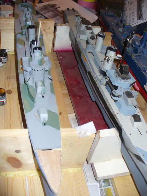

    A few more photos of the paint finished. I'm sure as I work on this ship fitting the internals next weekend I'll ding it up and have to touch it up, but for now it looks awesome. A few more details will be added once it's finished, but for now I think it looks really cool.
