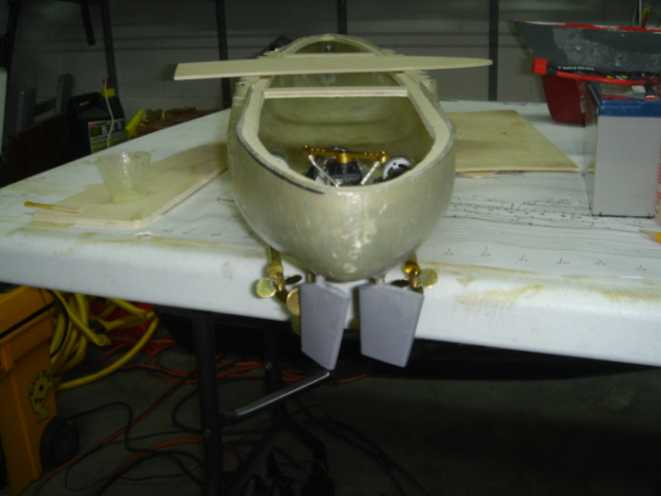

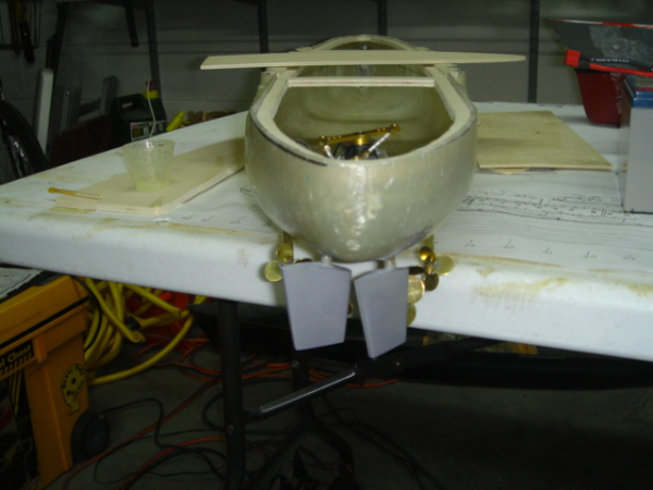

    In MWC, we cannot slow down or affect the speed of the props in any way to assist turning.
    What I do is turn the rudders different amounts, the rudder on the inside of the turn turns at about 50 to 60 deg, the outer rudder at 30 deg. As you can see in the pictures.
    The inside rudder acts as a drag force, while turning the ship, while the outer rudder keeps the ships speed up, since the water flow is not as restricted.
    I did not know if this would work as envisioned, some of the MWC old hands basically told me it would not work. But with testing in Rick's canal, it works great. Don and Rick were both amazed that it turns so well, and you can not see any slow down at all. Of course it has to slow down some, but its not noticable that we can tell.

    Dave, you don't change the speed of the props, but you have the rudders at different angles so one produces less drag than the other? It would be interesting to try setting the rudders to be parallel and seeing how that changes your performance.

    My Roma has the rudders turn the same amount, when you make a sharp turn, which it can do, the speed of the ship slows down to the point of stalling, its just turning, with little forward motion. And the speed of the turn is also slower. I see all the ships doing this on a tight turn.
    So while they go into a stall, my plan, if it works, is to just power around their turn, and since my turning circle is about 60% of theirs, My bow should be pointing at the forward side of the other ship at the end of my turn. Just right for me to rip off 3 or 4 shots with the triples, before I start into another turn.
    Again this is all theory, but we will see next weekend. Don and I will just practice some manuvering against each other.

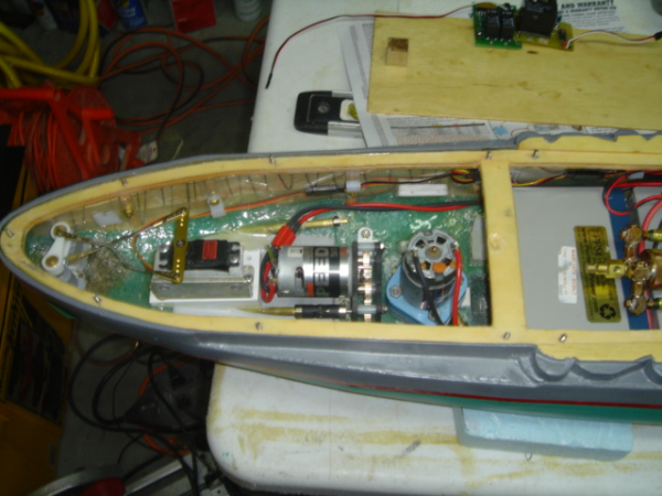

    Looking at my PE pictures I spent alot of time making sure the rudders gave me as much prop coverage as possible. I wanted the inner to be as close to 100%, the outer at 60 to 70%. I think I acheived my goal.
    I have a picture posted of it, but here it is again.
    It has dual throw arms, and by putting the 2 bends in the rods, when it pushes out, it goes further, than when it is pulled in. Both rods have the bends, the one at the angle it is you just do not see it.
