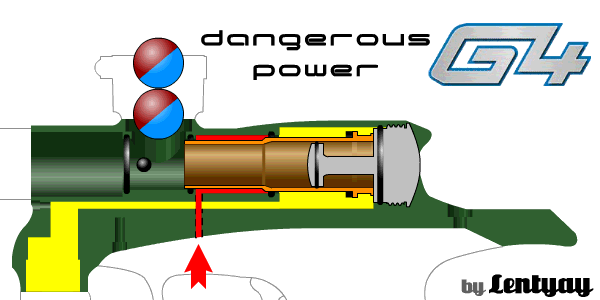

    For those wondering how "my" prototype valve should work.
    Just replace the red LP line with a return spring (at this stage the HP is on/off from a solenoid so the spring only functions as a return. In later stages it may be a 5v solenoid which would increase efficiency and RoF) [​IMG]

    It seems awfully complex to try and miniaturize down to fire .177 BBs. Most captains have enough trouble with our relatively simple o-ring breach piston interrupted cannons, I feel like you are over engineering and in this hobby that is rarely a good thing.
    If cost is a problem, which you stated just a few posts ago, do you really want to spend the time money and energy trying to r&d a new type of Cannon when you haven't even seen what traditional cannons do? Or built a functioning cannon?
    Once again, I'm not trying to rain on your parade here, I'm just trying to be a realist.

    Brilliant design, though it looks like it will require a machined piston/chamber(orange thingy) with smooth sides to function reliably.
