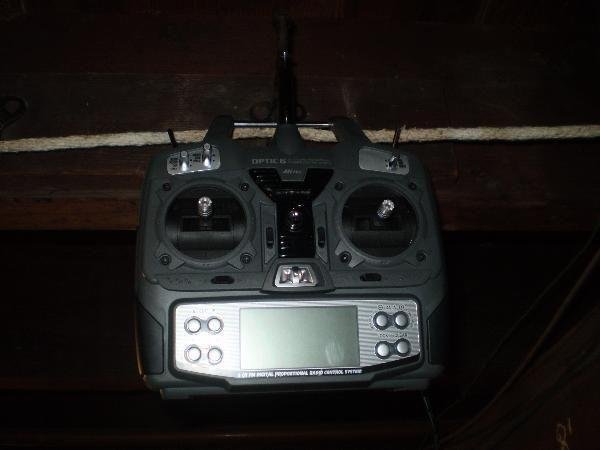

    Above you can see the radio I got for Kormoran. It's got a screen, lots of buttons, and was made for airplanes. That means I work on 72Mhz. Whatever. The hobby store guy tells me that crystals are cheap and easy to get. We'll see. The radio is a HiTec Optic 6. The guy told me it was a badass radio. I paid $100 for open box and w/o the servos. Did I get taken?

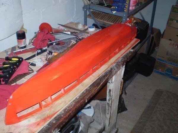

    Above you can see the girl. She's red!!!There's 2 coats on the wood, and 1 on the balsa, with a little overspray. I bought a little can of testors Gloss bright Red for below the waterline.

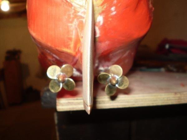

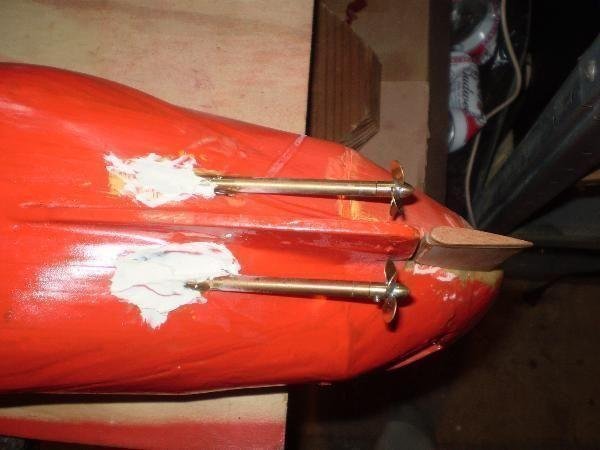

    Above you can see the 2 prop shafts w/ props attached. I used this great clear 2-part epoxy that came in a double-syringe with a self-mixing tip to secure the 2 shafts as evenly as possible. It worked out awesome! I wish I saved the pack to show you all, but I threw it out unfortunately, Over the clear epoxy went 2 coats of the obligatory Redi-Patch. There was a lot more sanding on this boat, more than I ever thought.

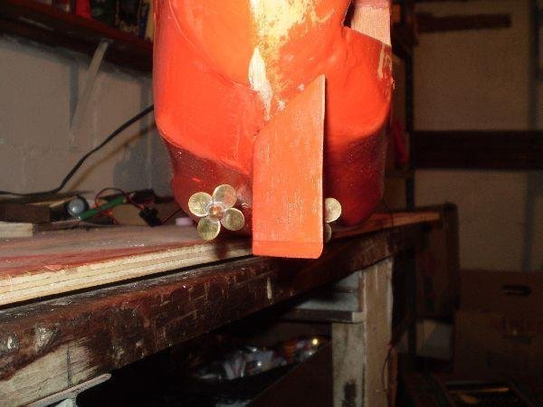

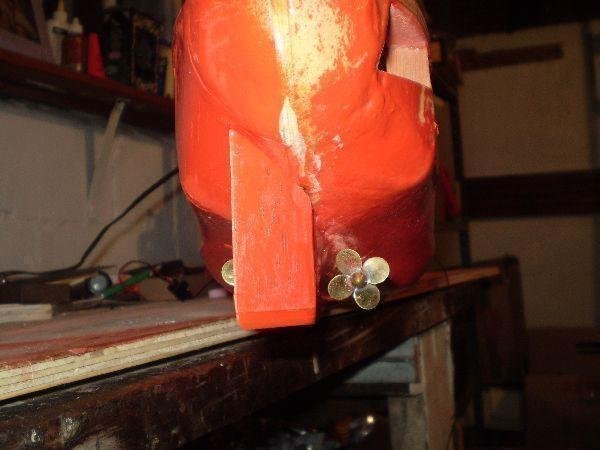

    Here's the 2 props and the rudder. I hope it looks that crooked because the table is off or I'm holding the camera crooked or something; It's not that bad in real life. Anyway, I got my order in from BC some months ago, and everything worked out great. As you can see, the props are beautiful, the shafts and shaft housings are spot-on, and the gearbox is smooth and tight. I have nothing but good to say about those guys. They thought that they took too long to fill my order, so they threw in a set of drag props for free. I prolly won't use the drag props, but I appreciate the thought. BC will be my next stop for stuff like pump and lifeboats and stuff.

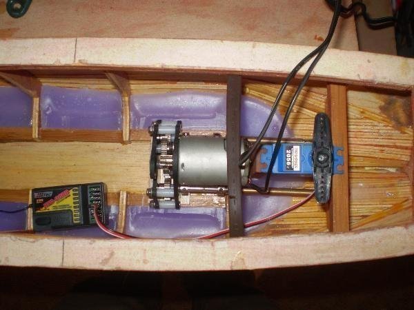

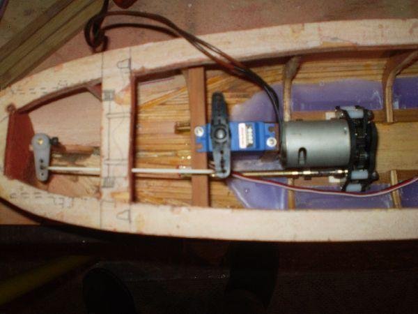

    Above you can see the motor, gearbox, rudder servo, and reciever. I will fabricate a waterproof box for the reciever and anything else that doesn't like water, and will prolly mount it as far forward as the reach of wires will allow. The guy at the hobby store told me that the speed controller gets it's power from the reciever, and then the motor gets it's power from the speed controller, but I think he might misunderstand what I'm doing, or is full of it. I think those little wires are too thin for what I'm doing.

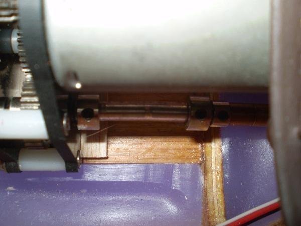

    Above you can see the flexible connection I made between the outputs from the gearbox to the prop shafts. I used a piece of 3/16" vinyl hose and a pair of "Duracollars" which are pretty much rings w/ an allen key screw to tighten whatever you've got. Last month, I machined a few pieces of brass tubing and aluminum rod and some bits of coat hangar that I was really proud of, but it turned out that once I epoxied the shafts in place, they were too stiff and made the motor work waaaay too hard. Sucks. So I scrapped my homemade dogbones and went with the vinyl hose. If the hose even lasts a single sortie, then it's ok. $1.19 a foot at ACE; A foot will last me a while.

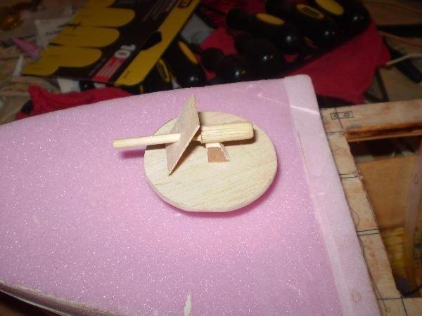

    This is the 75mm deck gun. The crew asked me for a gun shield, and it seemed lunacy to man the weapon without it. (The plans say that this gun didn't have a shield.) So there's a gun shield. We'll see how well it does in real deal combat.. I like to think that this is a pre-production model of the excellent Panzer V 75mm gun. If so, it won't just merely pierce a destroyer's armor, but rather, will go through the entire ship. There's supposed to be a pair of 20mm guns alongside the 75mm, but I haven't figured out a realistic way to build them yet.

    The ship is coming out nice. I questioned the small props too but then I remembered you were running big gun so the speed might be ok. The speed controller wiring goes to the reciever but it has a heavy wire set that does go to the motor. In a sense the ESC acts like a big on switch for motor power. You hook the ESC to battery power, reciever and to the motor.

    For the price of converting the 72MHz radio to 75MHz, you could have 2 (or 3) 75MHz or 2.4GHz radios, with servoes. Ship looks nice though.

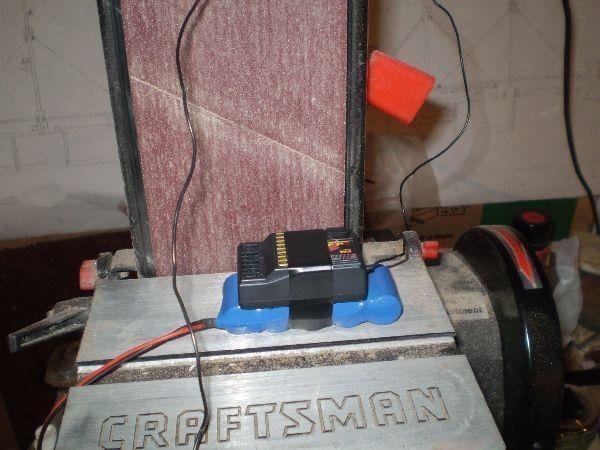

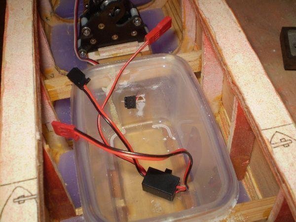

    Above is the reciever and battery. I taped them together since I don't forsee them being far apart for too long, and that they will both be in the waterproof compartment. It made the space arrangement better.

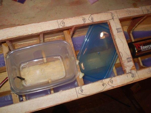

    Above is a pic of the watertight compartment. I snuck it out from above the oven when the wife wasn't looking. All penetrations into it will be fore and aft, sealed w/ clear silicone. If silicone proves unsatisfactory in testing, I guess I'll go with resin or epoxy or something.

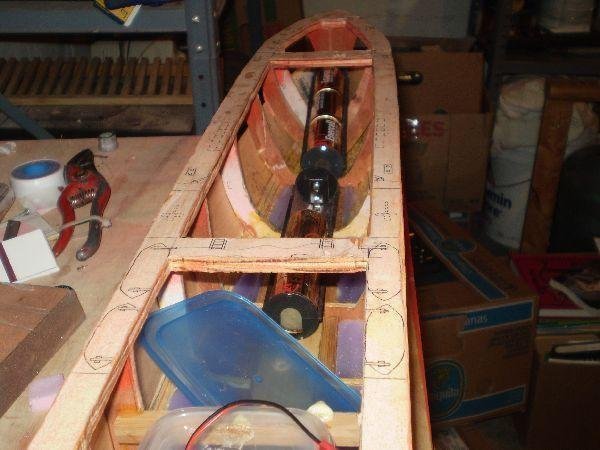

    Above is my general idea for battery placement. That's 2x3-cell D batteries for a total of 9 volts. Motor seems to like it. I hope they make rechargable battries in packs and capacity that I want. I haven't really investigated or fabricated yet.
