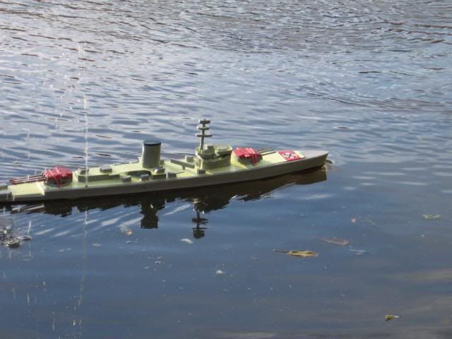

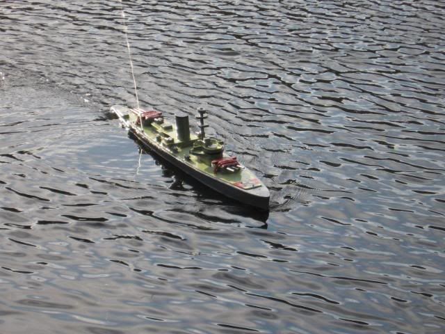

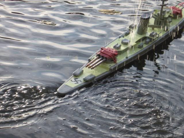

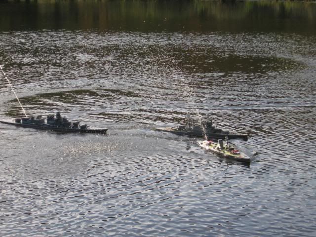

    Here comes some pics of Mike P.'s pocket terror.
