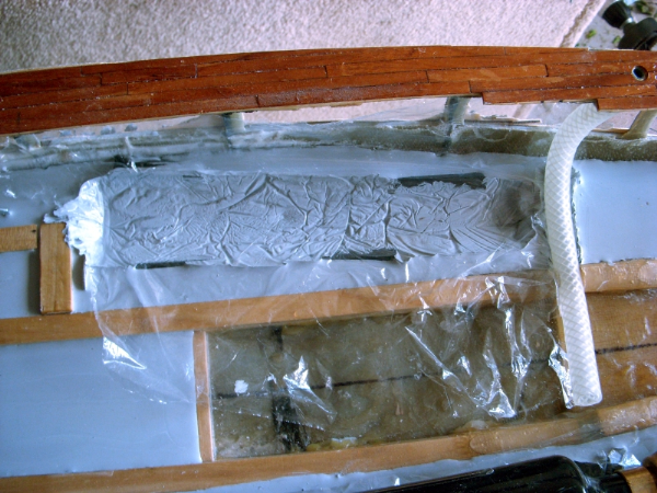

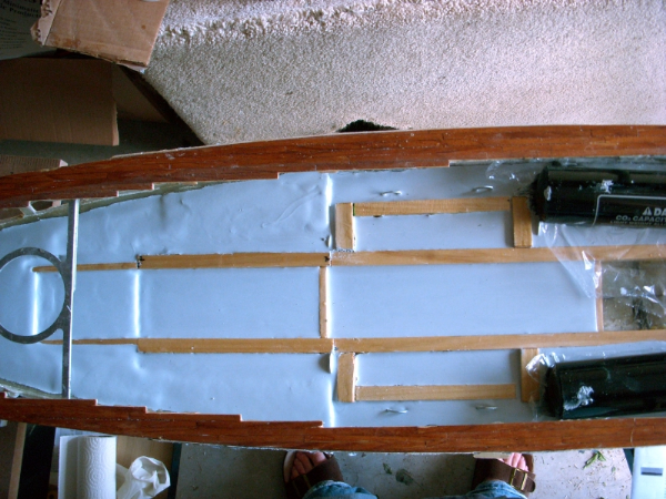

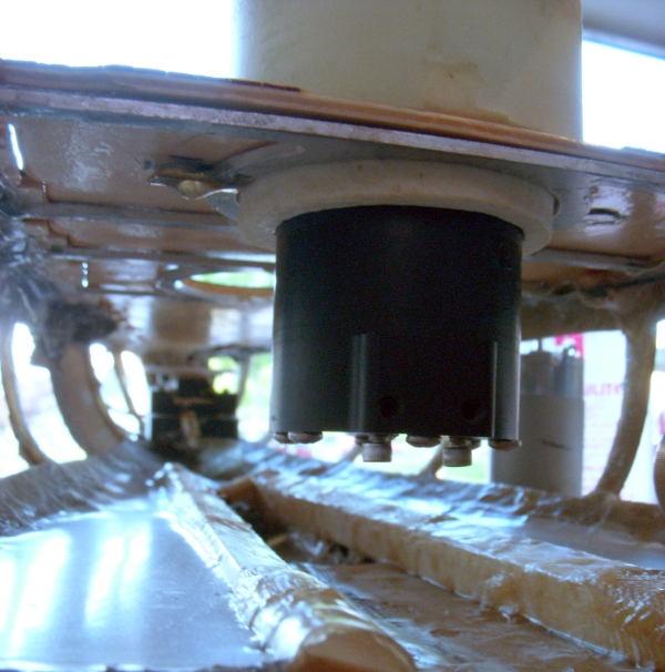

    OK, So it's been about a week & I thought I'd share with you what I've been doing all couped up in my garage.
    I am nearly finished with the waterchannel. WOOHOO! Took down right forever. But as I said before, I think its worth it. The last step is to shape it with concrete sealant, a whole lot of sealant. This stuff takes forever to dry apparently... As I poured it last weekend, and its still drying. It has a nice thick skin on it, but I can tell the insides are still liquid. Everyday, it seems to be getting tougher and tougher. The package says it will take a week to dry, and I assume since I'm using much more than a standard application it could take even longer. If I could do it again, I would do in in layers. I don't particularly care how long it takes, as long as it dries completely in the end.
    Must admit, I'm a little worried it won't dry completely. Guessing even if it doesn't it wouldn't be a big problem, as its tough enough right now for battle. And worse case scenario is it gets poked, but even then the goo won't come out (unless its a pretty big cut). Oh well. All I can do at this point is wait and hope.
    You gotta admit, though... It looks absolutely fabulous.

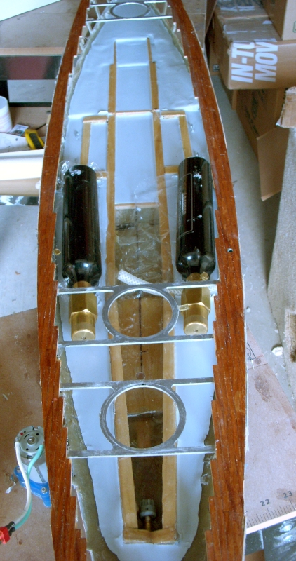

    Why are my CO2 tanks in the picture? ---> Because they are being molded with the sealant!
    They are each being held in place by 4 magnets & I must admit I really like how they are shaping up. The magnets are holding the CO2 tanks nice and snug... turn the boat upside down and shake it, those bottles aren't going anywhere. ;) Yet, grab ahold of one & pull... they come right off. *very niice*
    Ooh, since I didn't take any photos of the 'naked' CO2 bottles; I should mention they are angled so the CO2 stays on the bottom of the bottle. However, I think I will modify them for horizontal use just the same.
    I also wanted them as close to the bottom of the ship as possible for balancing reasons, so they actually needed to be molded directly into the waterchannel. What I did was I wrapped each tank (& the pump hose) up in saran wrap & poured the sealant.
    The result: a perfectly functional, bumpy finish. Which is quite OK, because one of the nice properties of the sealant is if I don't like a section I just cut off the offending parts & re-pour. So, I figure I'll let this dry; then I'll cut it until its smoother do a better job wrapping the bottles (or use some form of mold release) and try it again.

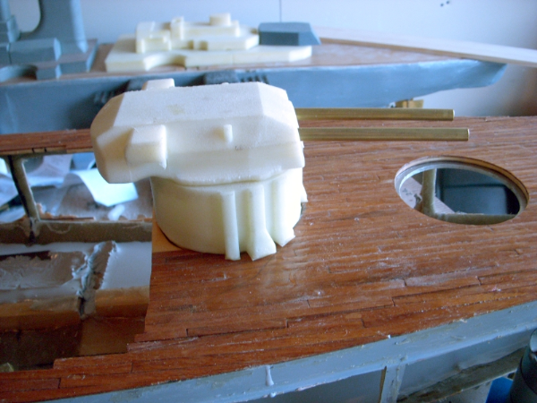

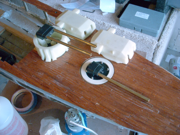

    I've also been casting the adapters for my new pancake cannons.
    I'll create another thread showing how I did that:
    Visit this site
    But anyway, here are the adapters:
    Notice how close the barbette is to the deck. Puurrfect.
  11. jadfer
    Looks great but how much does it weigh now? Also is this for fast gun with two tanks? I see what looks like your pump outlet hose and it looks bigger than typical fast gun. Its really looking good.
  12. JustinScott
    JustinScott Well-Known Member
    2,258
    Last time I weighed it I had some 10 lbs to spare. That was before the sealant though, but that seems pretty light actually. I can weigh it tomorrow, but I think I'm still good.
    Two tanks for fast gun, yes. Not going to run out of CO2 + it balances better that just one in the middle.
    The outlet looks big because it is on that side, if you look down the hole you will see the standard compression outlet. Don't worry, not trying to break any rules! :)

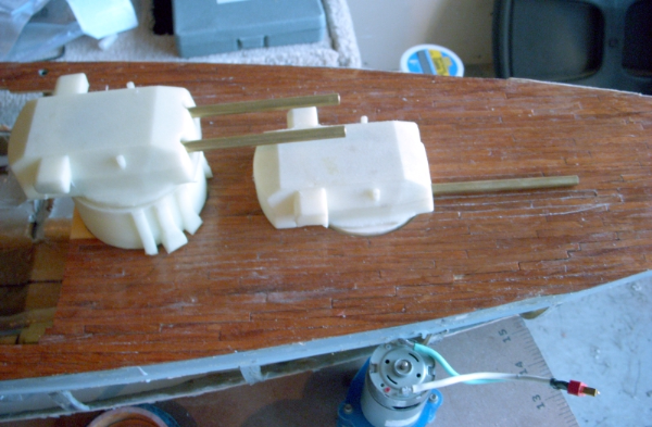

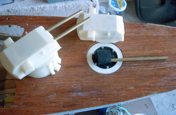

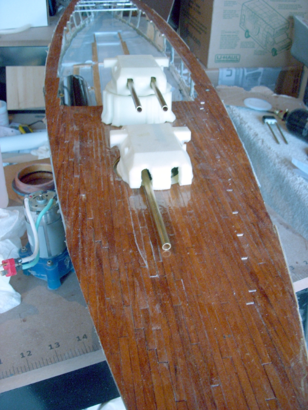

    So I then moved on to the D-Turret... I used the same mold, just only the bottom part. (Two piece mold)
    BTW, you can see the new 'compressed' top for the pancake cannons... They let the barrels be mounted a lot closer to the deck, and send the shells out much closer together hopefully to provide a tear in the opponent instead of just two holes.
    The reason the D-turret has only one barrel is because Greg was out of pipe & I haven't gotten around to buying any. But don't worry, my aft cannon will be a twin.
    Just try to tell me those cannons don't look SICK!!! [:0]
