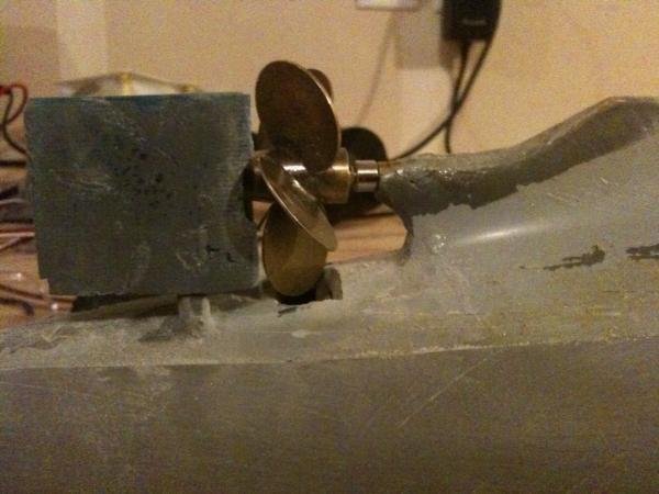

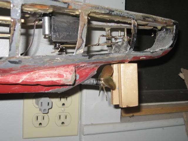

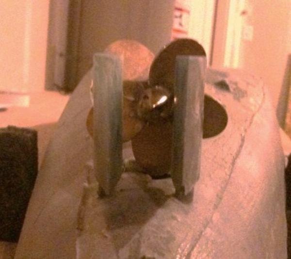

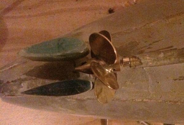

    After I destroyed my original prop during seatrials; I ordered a "bismark prop' from strikemodels... not really thinking twice about what they would ultimately send me. When it came in the mail from stikemodels; I simply held it in my hand and laughed; I believe my words where "OMG; this must be some sort of joke... That can't fit on MY boat!"
    So its been sitting on my shelf for a week while I tried to decide what to do with it. Strike of course offered to replace it free of charge with something smaller. But still; it was 'very tempting'; especially once Iceman said he is using something similar in his T. Finally tonight I decided I would stick with the really really big prop. 2" 5blade.
    When I dig out the fiberglass to fill the hole under..err above the prop I will extend the bottom of the boat so it won't sit on the prop... It only hangs over like 1/8".
