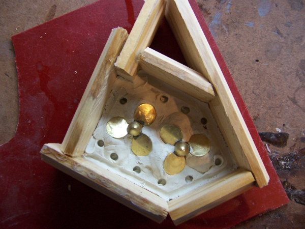

  12. Lou
    It can be appearances and the thought of "someone is not following the rules". With everything else, why make this another area that captains get sore about (rudder shape, flatting hull for props, etc..).
    Outlaw disks and have props on shafts (again you can make your own, doesn't need to be printed). If you want to keep disks, then the maximum size and shape is the same as the drive prop(s) - (disk shall be no thicker than 1/8th).
  13. jadfer
    Prop shop burned down.. I cant duplicate my prop.. its a tragedy of epic proportions!!
  14. Lou
    Because you cannot cast your own plastic copies for non-drive shafts? Come on Johnny, you can do it. Build a box, fill half with clay. Spray mold release and fill with mold material. Wait 12 hours, flip it and repeat.
    If it helps I will post a "how-to" with materials.
  15. NickMyers
    are you using a pressure pot or vacuum chamber when you do castings with thin features like the blades?
  16. thegeek
    I do use pressure to force the plastic into the thin sections, props with thin blades have a %50 hit ratio even with pressure. Disks however don't require pressure or special stuff, a fender washer will do quite well.
