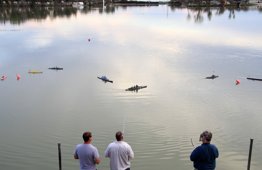

    The photo below shows 3 of the club-owned loaner cargo ships in action. These ships will typically last 15 minutes without pumps, and much, much longer (maybe too long) with them. The reason is that the skins are duct tape, and the tape doesn't splinter and split open, the way balsa tends to do. In this case, the 3 convoy ships are being run by 3 NAMBA race captains. Our battles were interspesered with their scheduled races. The race captains had a ball, believe it or not. This becomes an excellent way to introduce combat to guys who ordinarily compete in races, but may never havce seen combat. Since they are already NAMBA members, there's no paperwork to do.
