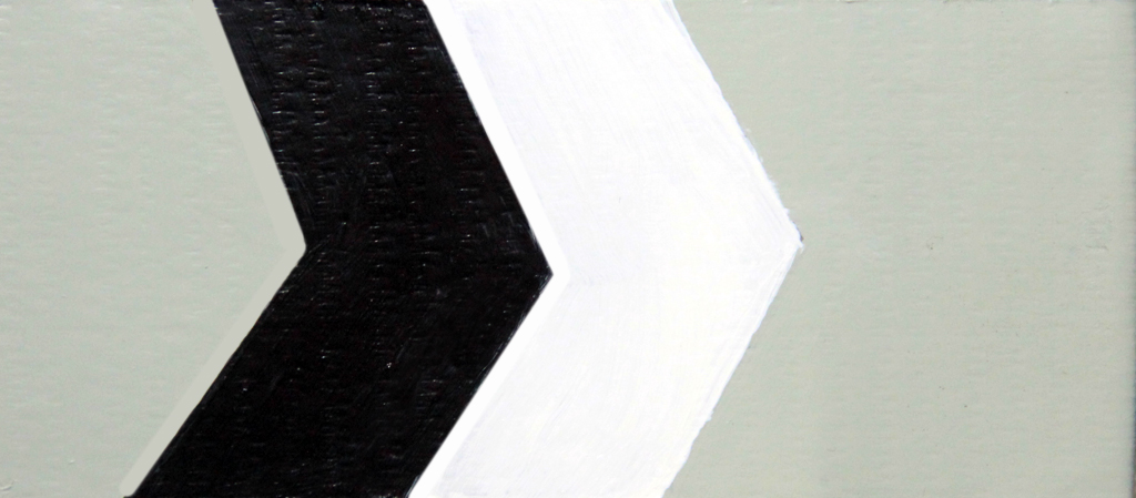

    Why are we saying this duct tape skinning would mean giving up cool paint jobs? I did an experiment today. This is ordinary gray duct tape painted with acrylic paint. It definitely wanted a coat of primer, and yes: you can see the texture of the tape underneath it, but who cares?
    It works for me.
    Rob

    nice. I wonder how it holds up over time and usage. If it's good enough to last through a whole battle day, then I'm happy. I know other people are less picky about their paint jobs, but I couldn't imagine sailing Scharnhorst into battle without putting on her war paint, first:

    I haven't used painted duct tape in battle, yet, so I can't answer your question at the moment. I'll paint a convoy ship with it for this weekend. (WWCC is having two days of combat at Lake Minden this Saturday and Sunday.) Then I'll let you know.
