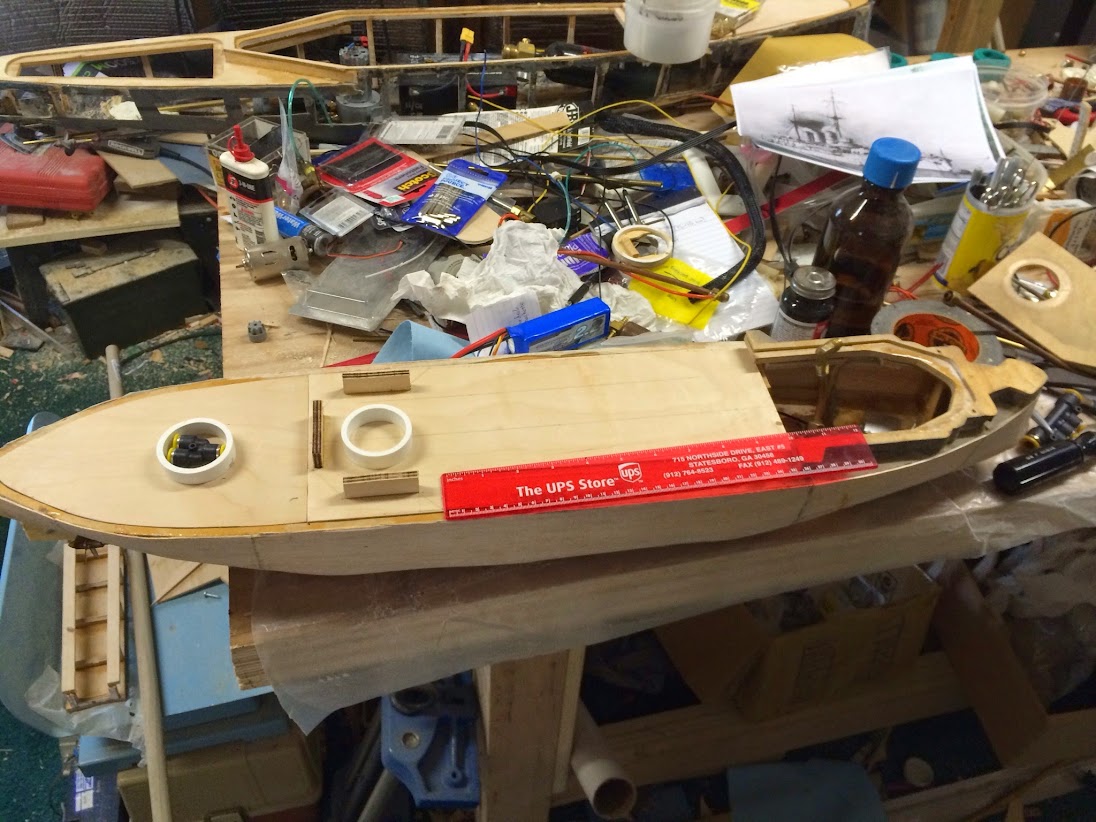

    So I'm going to Nats after all. I tell Steve that I can bring Lil Scharnie. He says 'ugh. Allies are already outnumbered like two to one.' Hmmm. Didn't I just recently get Evstafi driving like she should by moving the props closer together, etc? Russian is allied! So, I got busy in the shop hunting down all the parts I've got for Evie to throw her on the water. But then I remembered... CRAP! The area covered by the red ruler, aft of the step, is a stringer, and when I originally built her, I had thought that area was main deck! This must be modified. At first, I was unhappy about de-sheeting the middle of the hull, but as I pushed on the balsa, I realized that it was far to brittle to take to Nats anyhow, so it'd all need unsheeted.
    Closer view of the area... you can see where the layout line for the step, where the casement deck stringer becomes the main deck (that 45-degree line). You can also see where a silver sharpie was used to indicate where I had to trim to.
    This trimming was accomplished by a sanding drum and cutting wheel on my Dremel. You can see the angle that I initially beveled it to, about 45 degrees. I then removed more material from the bottom, but the key things are 1) it's 1/8" on the outside, and 2) a BB hitting just below the stringer will go right in. The first meets the letter of the rules, the second meets the intent. So I'm covered.
