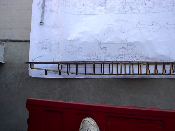

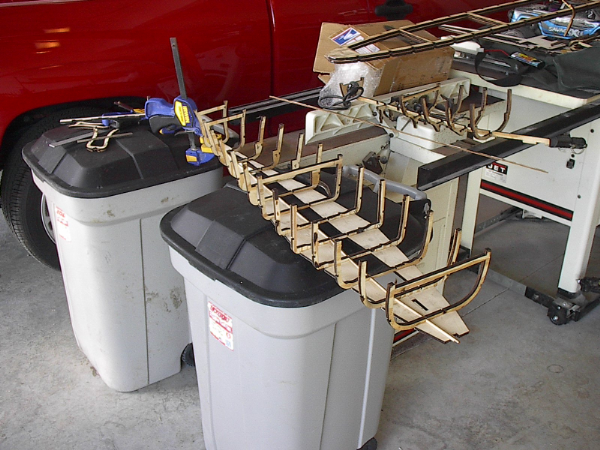

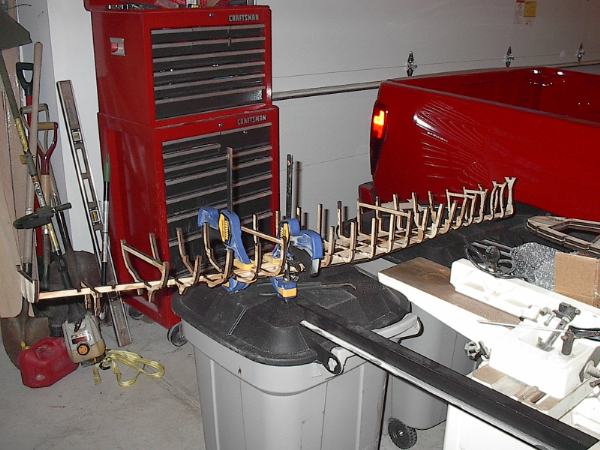

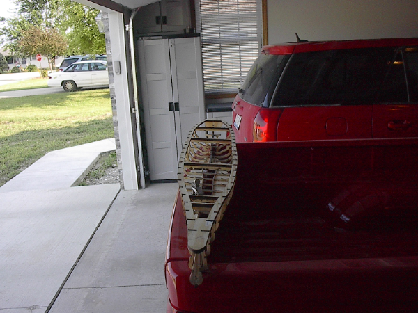

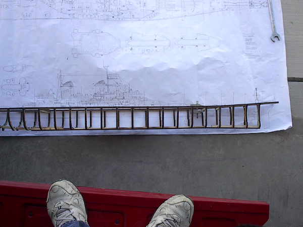

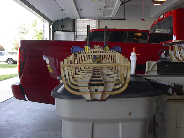

    Here's A few pics
    As I mentioned earlier in this post, the skegs are a little wierd, and the Goff plans really don't match the plans on the Missouri site in this area real well, at least in my opinion. It is a little hard to tell though, since on the Big Mo site, it is hard to conceptualize exactly where everything fits. Again, if it were printed out to scale, things would be easier to decipher.
    The raised bow is a little bit of a pain too. As you can see, I went with a baseboard type construction, but even if using a keel, the strength of the deck wants to flex the keel or baseboard down. I plan on cutting some kerfs in the deck to help it flex, and reinforcing the baseboard before attaching the deck permenatly.
    To do it over again, I would probably go with the double keel construction, but the jury is still out on that one. I went baseboard, and cut the water channel through it, to maximize interior space. I'll 'glass over the hole when the time comes.
    I accidently cut a couple of ribs from an outdated version of my CAD file, so I have to remake them before I can get the deck on. If that real life thing would just let up for awhile, I could get going again[^]

  6. Gettysburg114th
    Cannonman,
    That looks very nice. Are you going to mount the hull in a jig when you start laying out the stringers? Again, very nice job.
  7. Cannonman
    Apr 9, 2008
    879
    Hermitage, Tn
    I haven't decided how I'm going to approach it. Once I get the rest of the ribs, and the baseboard reinforced, and the cap rail/ deck kerfed to flex, I'll see how it seems like it's going to go. I do have a very mild twist in it now. Mostly from me being a fool and allowing the weight of the clamp to hang off to one side while glue dried. Of course, the glue dried, and "locked in" the twist. I did use essentially the crappiest glue I could find, so I could easily break it apart if need be, since I'm a first time builder and all. The twist is so mild I don't think that is necessary.
    Actually I was hoping I could clamp the baseboard flat on my table saw while the cap rail is drying to hold it straight. The notches you see on the ouside of the ribs are to hold the stringer, which is there just to give the sheeting a little more to hold to. Hopefully things will stay straight enough that I don't have to try to come up with a fixture to hold it that way, but we will see when the time comes.

  10. Powder Monkey
    What is the black on the Ribs?
    I would go with a jig system and make it as straight as you can now once you glass it is over and you want it to be as good as you can get it you don’t want poor performance later

  15. Cannonman
    Apr 9, 2008
    879
    Hermitage, Tn
    Actually I used a weaker glue so if I needed to break some of the joints and make changes or such it would be easier, and figured I can strengthen all of the joints with epoxy later if things work out, but I guess it does also make disposal easier if things go awry[V]
    Monk, I had to do a double take when I saw the pic. of your tool box!!!!
    I thought "Man, I don't remember taking that picture!"
    The black on the ribs is a "residue". They were laser cut, and the black is sort of a soot left over from the process. I tried to sand it off, but it was kind of persistant, and I didn't want to alter the geometry any, so I didn't sand very hard.
  16. Powder Monkey
    LOL me too all but the middle box they don’t make our box any more had to settle on all red [:(]
    As far as the choice on glue smart move. I always use CA but small amounts till I’m done. when you Glass it that’s when it will all get locked in. my son had to change his ribs 4 times today LOL things we found wrong from first build and than trying to rush [:0]
    So far it looks great keep up the good work
