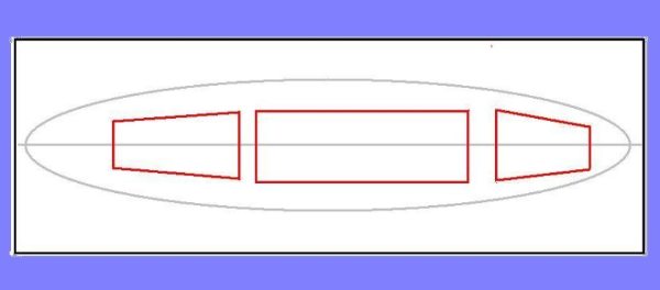

    Marking the outline
    First, get a fullsized template from your plans. I usually photocopy a plan, tape the sheets
    together, and cut it out. I have also traced the hull outline on large sheets of mylar that
    I got in an art store.
    Use a black permanent marker to draw a centerline on a white melamine shelf. Then
    trace the outline of the deck onto the shelf.
    Next, determine where you want your hatches and take measurements.
    There is no need to draw the entire hatch. You can just mark the start and end points
    on the shelf if you want.

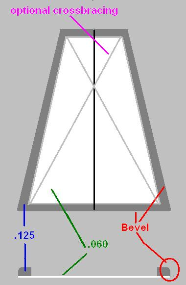

    Making the hatches
    Now make the hatches. My method is to cut the hatch in .060 styrene,
    Be sure to mark the center of the hatches. Run another length of .060 styrene, or even better, .125 styrene,along the outer edge of the hatch to form a lip.
    A solid piece of .125 styrene also works very well. This is good if weight is not a factor and if the deck hatch is on a flat part of the deck (ie no sheer)
    I have also used acrylic for hatches. If using acrylic then a simple sheet without the extra layer along the edge is fine.
    The outside edge of the hatch is then beveled to make it easier to get the hatch out of the
    deck later. This can be done by sanding but styrene quarter round works very well for this.
    If the hatch is large then you can run some styrene strips diagonally across the hatch
    to stiffen it. I have made hatches up to 14" long using styrene, but I am not sure if
    larger hatches would be practical.

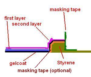

    Now position the hatches (upside down) directly on the melamine shelf alinging with the
    centerline markings and the reference points on the shelf.
    Place weights on the hatches to keep them in place. The hatches should lie flat on the
    shelf. You can, if you want, apply some masking tape along the inside edge of
    the hatch lip, with one edge of the tape unattached and sticking in the air. This will
    act as a barrier to keep the gel-coat and resin from flowing over the edge of the lip.
    Brush on a coat of gelcoat to the entire area of the deck making sure that the entire outline of the deck is covered. Apply the gelcoat directly on the hatch covering the bevel and up on the lip. Be careful not to let the gelcoat flow over the
    cover the other side of the lip, or it will make hatch removel difficult.
    You can apply the gelcoat directly to the styrene. If won't dissolve it (at least
    it hasn't dissolved the stuff I use). If you are uncomfortable doing this, a layer of
    masking tape on the hatch lip should help, and it will ease the removal of the hatch later.
    Be careful not let the tape wrap around to the top (the part touching the melamine) of the
    hatch as it will lift the hatch off the shelf.
    A light touch with the brush is nice - try to avoid forcing gelcoat under the hatch.
    When the gelcoat has set you can apply the first layer of fibreglass.
    Cut the cloth into stips of various widths.
    It is a good idea to make some to exactly fit the gaps between the hatches.
    Now apply the resin and FG cloth to the deck. Do a small area at a time.
    Brush on a thin layer of resin and then apply the FG cloth. The first layer should
    run along the edges of the hatches, but not mount the lip. Don't overlap the pieces of cloth.
    The second layer is now applied. The FG should be applied so that the areas betwen the
    the pieces of the first layer are covered with the pieces of the second. The second layer
    should run up onto and cover the lip of hatch. Again, be careful not to let the resin run over
    the other side of the lip.
    Run some extra layers bewteen the hatches. You can glass in a brass rod across the deck to
    stiffen it if the deck is wide, or if it will carry the weight of the superstructure.

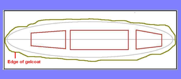

    Removing the new deck, and extracting the hatches
    When the FG has set you can remove it from the melamine shelf. It will simply pop off.
    Lift a corner of the deck initially by slipping an exacto blade under one edge.
    Once that is loose a screwdriver can be used.
    The outline of the hull drawn with the permanent marker will have been picked up by the
    gelcoat and can be used to trim the deck to fit the hull.
