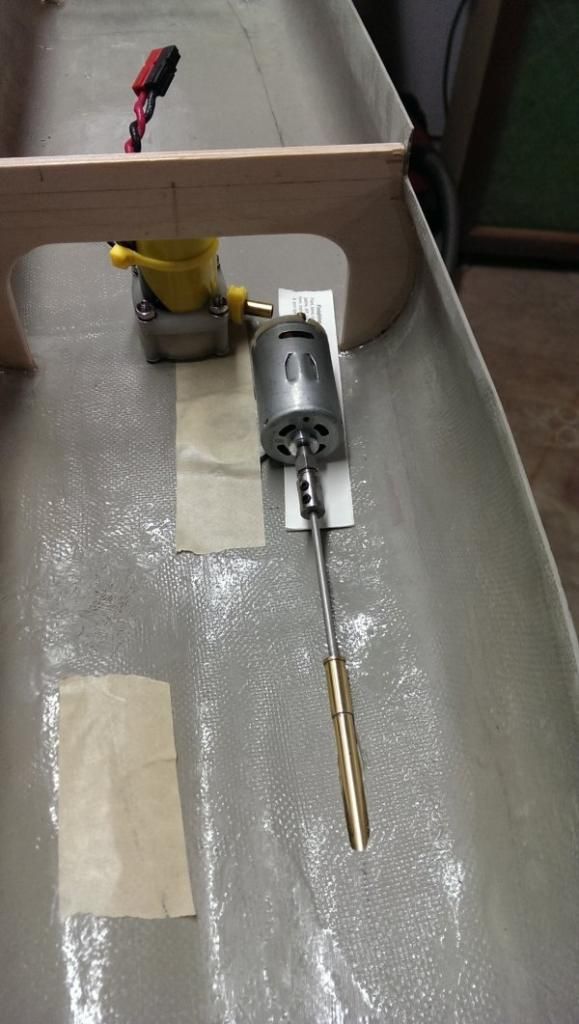

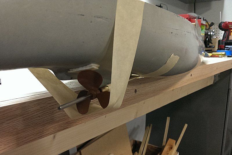

    My method for placing prop shafts is to first figure out where you want your props and then work back from there. I usually stick the props to the hull with a couple of layers of foam double sided tape to space the props from the hull about an 1/8". With the hull sitting upside down on the bench, I eyeball and mark where the motors will be inside the hull (looking straight down on the hull). Draw a line from the center of the prop to the center of the motor on the bottom of the boat (as best you can). Now looking at the hull from the side, eyeball where the motor will be in from this view. Eyeball where the imaginary line goes from the center of the prop to the center of the motor. Mark that line on the bottom where the prop shaft and stuffing tube will penetrate. Now I cut a slot that will fit the shaft from the prop to the motor. You can now temporally mount the motor and prop with the shaft connecting them. Now its an easy enough process to enlarge the hole for fit the stuffing tube. If you take your time and do it right, you won't have to cut huge holes in the bottom of your boat that will need gobs of Bondo to fix. It's best to try to keep the motor, shaft, and props in one straight line (if you can). This reduces wear on whatever universal joint you may use between the motor and shaft (dogbone, etc). If you get the alignment perfect enough, you don't need a universal joint.
    Rudder locations are marked once your props are set in place. You want the rudders as close to the props as possible and inline with the shafts.
