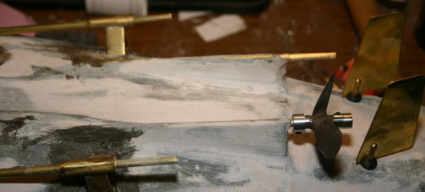

    Here are some photos I took last year after the hull was shaped... Sorry the photos are so far away. I will try to post more photos when I get the chance.

    It can be done, by streching in "the right direction"... but to tell the truth I'm not quite happy with the atlantic bow on the NJ, it curves a little, but not enough.. I will reshape it next year... Shouldn't be too hard, now that I know to pay special attention.
    The skegs were formed later with the kitty hair, this let me engrain the prop tubes into the 'glass itself.
    What you are looking at is unfinished, of course. But it highlights different stages. The "green" is unsanded kitty hair, added when I installed the wing props. The pink is sanded (& bondo'd I think), but as you can see... it could use another coat of the hair. I will add more after I've engrained the watercooling tubes, no reason to until then.
    Unlike wood where if you screw it up, you have to start over; with kitty hair, you can always add more wherever you need it. It is basically a mush that you can shape after it dries and it is supposed to be just as tough as fiberglass.
    For completeness, after I'm finished with the shaping I plan on putting a full coat of fiberglass (cloth & resin) over the whole ship just incase the kitty hair isn't as strong per sq inch as fiberglass. --> I don't want thousands of little BB dents on my hull.
    As far as lifting the boat and swinging it wildly... it doesn't to bend or flex. I've loaded it to 35lbs so far (because that's all the weight I have yet)... but it didn't flex at all.

    I put in the tubes & shafts as I was adding the skegs. They were the "framework". Kitty hair is available from home depot or your local hardware store. I think it is called "fiberglass filler", MAKE SURE YOU DON'T GET BONDO automotive filler! However, bondo glass seems to be OK.
