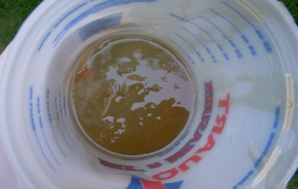

    Rule #6: Gunky resin is not your friend.
    If your resin starts looking like this... DUMP IT!! It has already 'turned'; using it will only lead to a mess.
