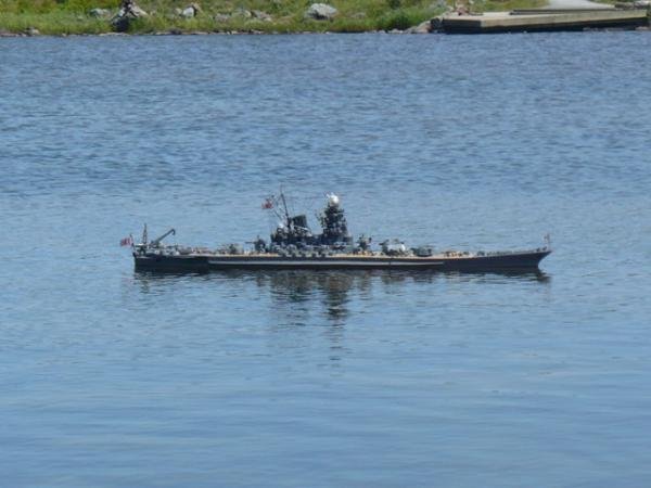

    There she is !!! Theerre she is!!!! Not so wounded as we were led to believe. So much the better..... FIRE!!
  9. NASAAN101
    2,504
    God She's huge!!! but she's a great ship tho!!!
    5,751
    It's a beast. Almost as long as the MO but much fatter. I will be getting it back to the look of the ship in this photo soon.
