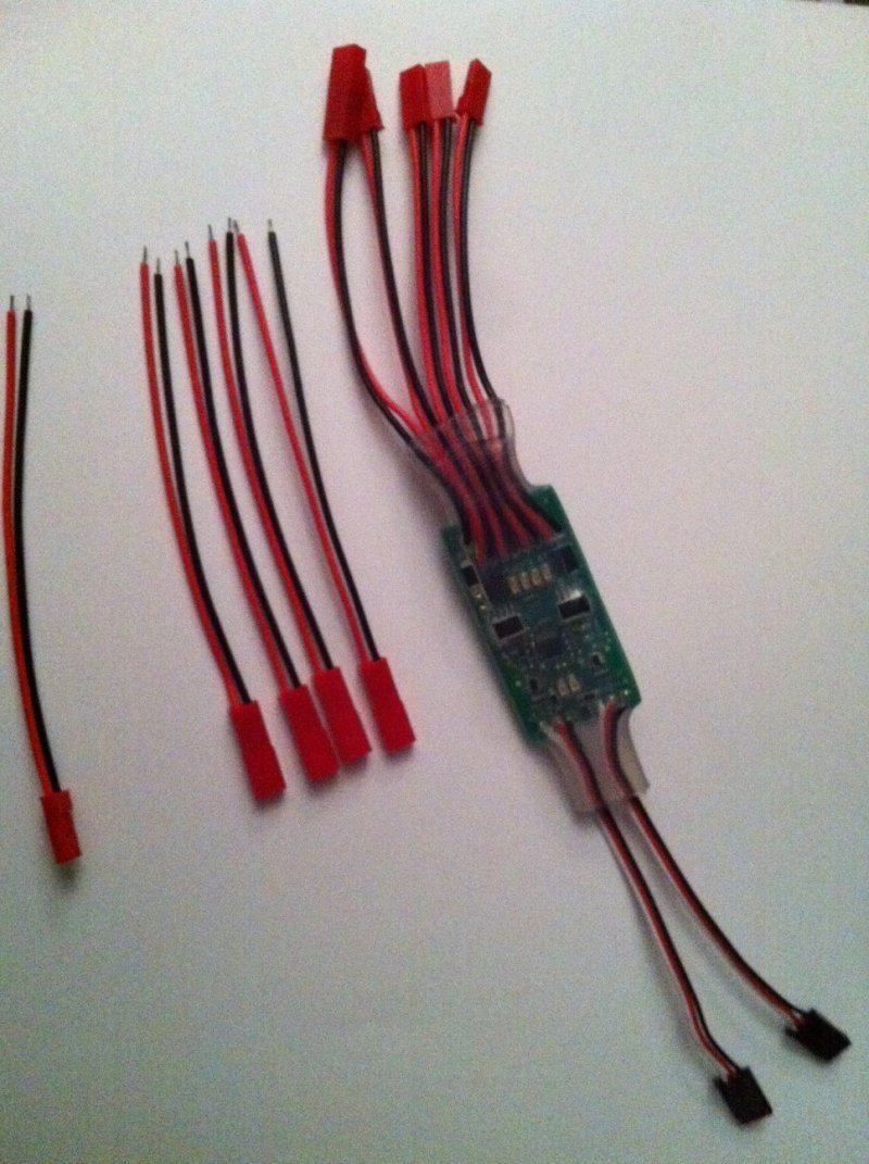

    Here it is. The Strike Models firing board. It uses 2 channels from receiver to make 4 firing channels for solenoids. I forget the amperage rating but I remember it was more than adequate. It also uses an external voltage supply for said firing channels. Good for 12v solenoids:) I believe he said it works with virtually all radios and the channel engages at 50% throw. It came with conformal coating on the board then the whole thing was encapsulated in double layer shrink wrap. Meaning it has a thick clear jacket with an inner liner that melts and conforms to components. I will try to get Stephen to give me all the specs again. I also hope I can post a "review" soon.

    The board is really nice. How much do they cost?
  8. Kun2112
    It is a marine shrink wrap with hot-glue on the inside. I think they are $65--or were in June.

    Thanks Mike, I had been curious about that for some time. I can tell you from experience that the 'shrink and seal' shrink tubing I have been using is not waterproof. It seems there is always a place where it doesnt reach. My suggestion to Strike is to provide on the side and allow you to put it on after several coats of conformal coating or skotchcote or epoxy. Then to put it back on.
    As far as the burned out board issue, I was asking Snipehunter if the boards that burned out at MWC Nats (I am assuming it was Steve) had waterproofing on them and/or just the shrink wrap.
  12. SnipeHunter
    I'd rather they just get supplied without any heat shrink as I'm just going to cut it off and throw it anyway anyway so I can waterproof it properly. Really Strike should just supply them as boards with no coating or shrink and let the user waterproof them as desired. It seems to work well for other firing boards.
    I dont know if the strike boards actually burned out or if they just went wonky and didnt work again till a good drying. (I believe it was Ty that was using them.) Either way the "Conformal coating" and "waterproof shrink wrap" were ineffective.
    Steve's boards fried, I thought that was more Steve being Steve than a waterproofing issue. (They all fried so it was probably a reversed voltage or connecting the wrong battery or a short somewhere or something like that.)

    Stephen at Strike indicated that he put two layers of a conformal coating on the board and then the tubing.The ends appear to be compressed with pliers of some sort to force the melted tubing liner inbetween the wires. The length of tubing to wire overlap is also comforting in its own right. I honestly can't remember the individual unit cost. Around $40-$50 or so.

    To remove the shrink tubing just cut down one edge carefully with an xacto knife. I bet the glue will peel off.

    Most versions of melting glue are usually more cohesive than adhesive. That is not an absolute just a trend I've noticed. If it does prove to be rather adhesive and leaves bits stuck on there... No big deal. I'll just skotchkote over those bits and call it good.
