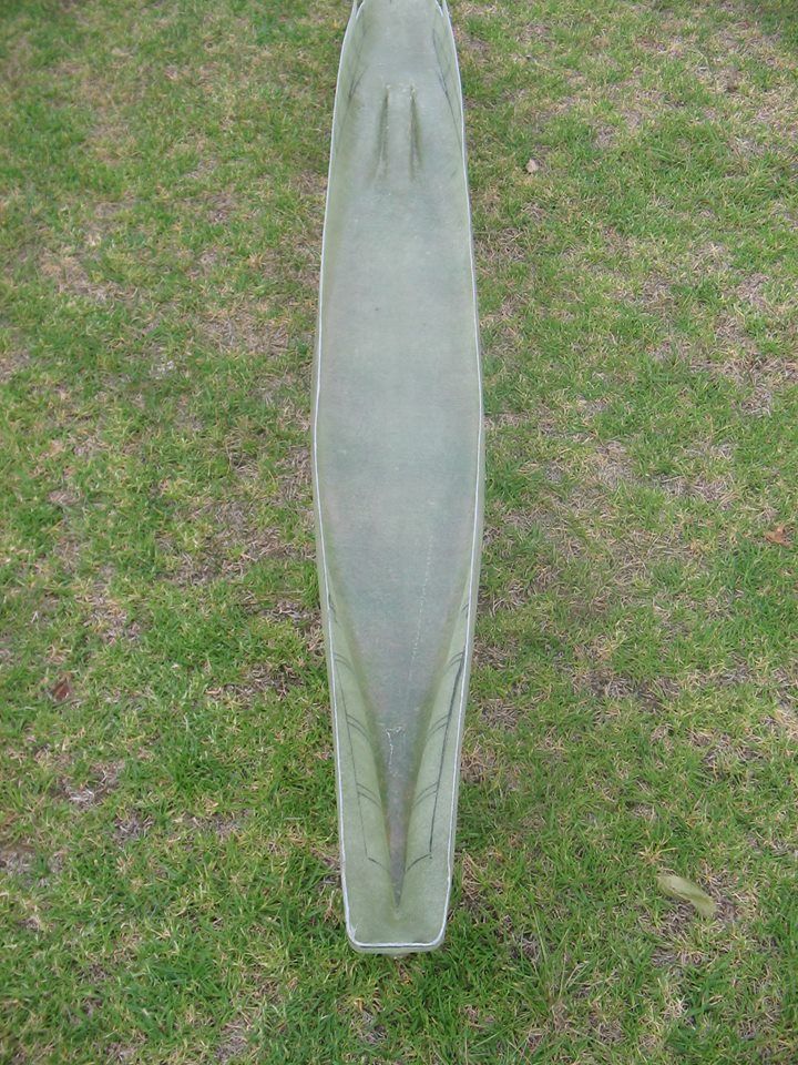

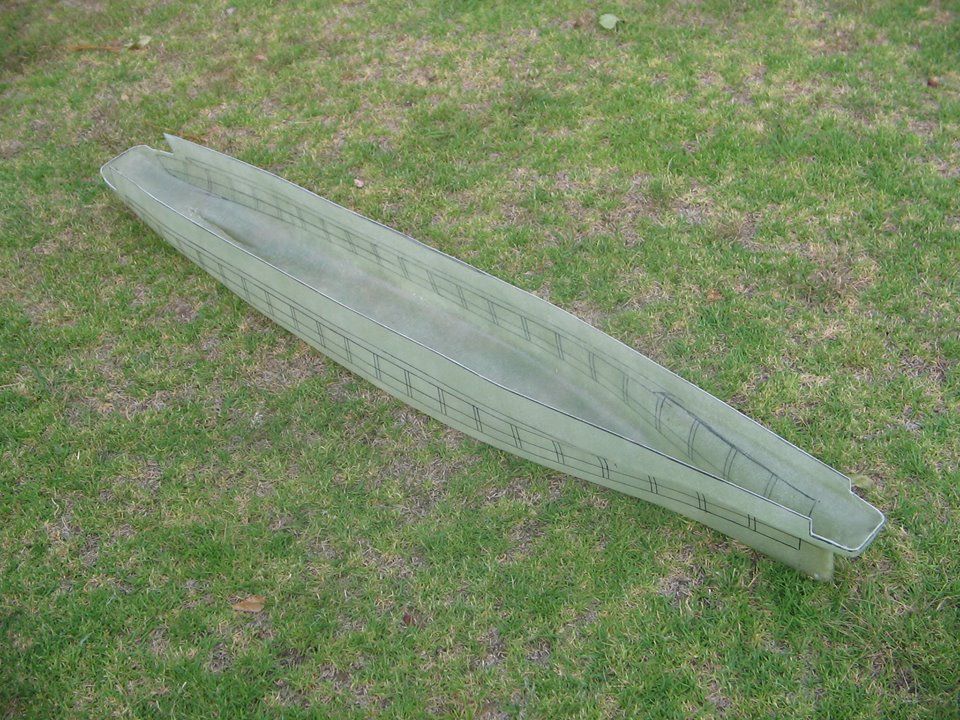

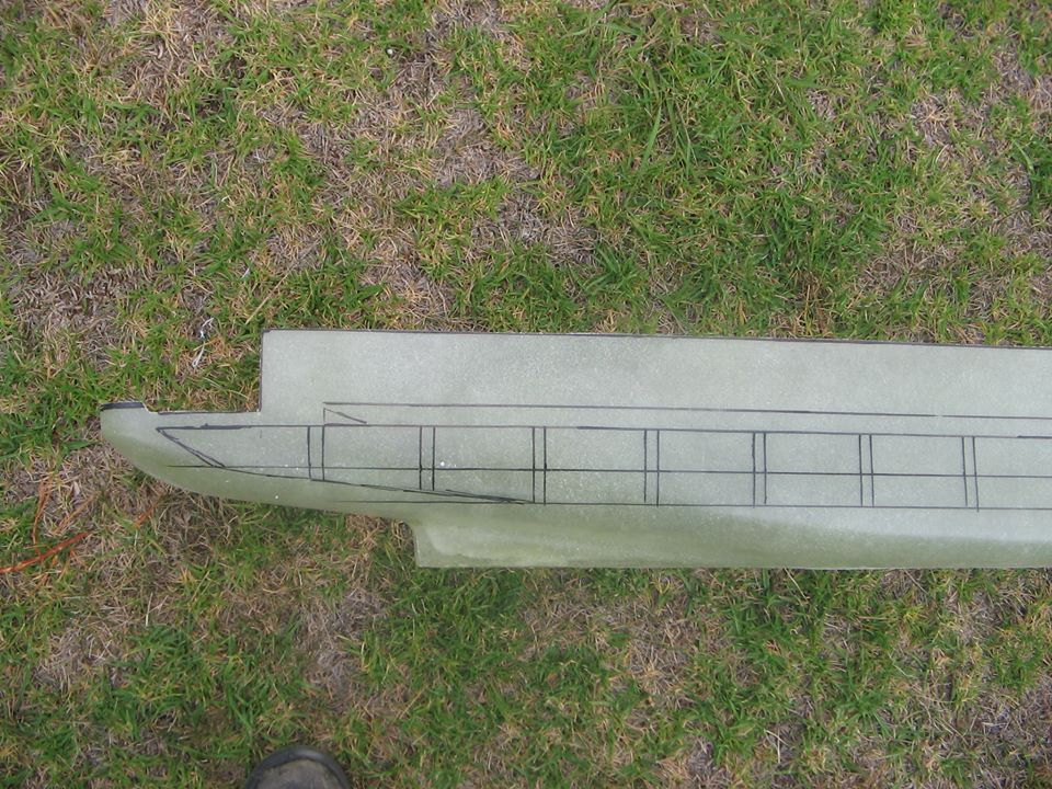

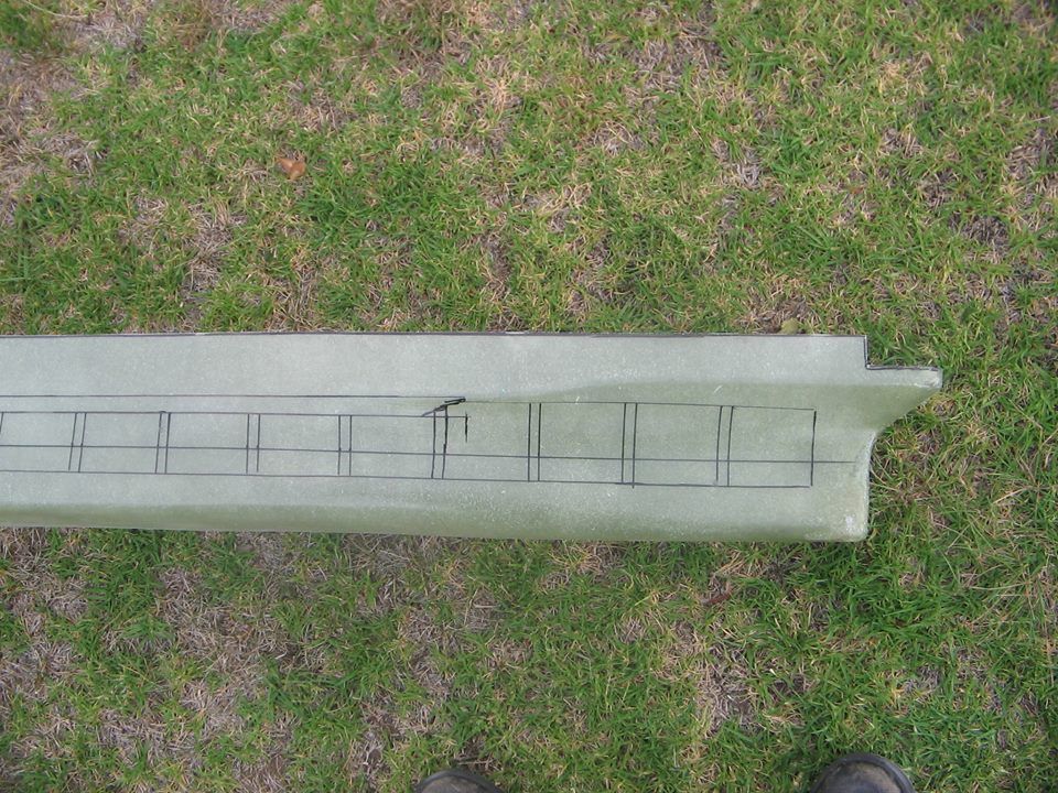

    An update from micheal at dreadnought hull is laid and will be shipped by next weekend a fine chance too get some close ups of his fine work and i hear a whisper that tony scott from new castle will be post some pic of a completed midway for you guys too feast your eyes on.

    I'll fix these so that they're in the post when I get home. Army firewall stops me from doing certain things in the interface.
  20. CURT
    OMG. I want one. Rats I made a promise to the wife I have to get my other projects built first...hmmmm need a staff of elves or I got it! Minions!!
