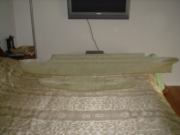

    I have the Radetzky hull sitting in my garage, I plan on making it after I finish my Kumano. In region 3 we are willing to test it early, so it will have 3 guns as a test bed, if it does not pass I will just take 1 gun out, and change the outlet, so no big issues.
    For the original poster, I had Michael Raue in Australia make my hull for me, he had to make the mold for mine, so he can now make additional hull's to sell now. If you need his contact info, let me know.
    Here is a picture of it, with the Titanic in the background.
