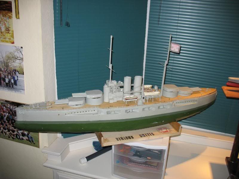

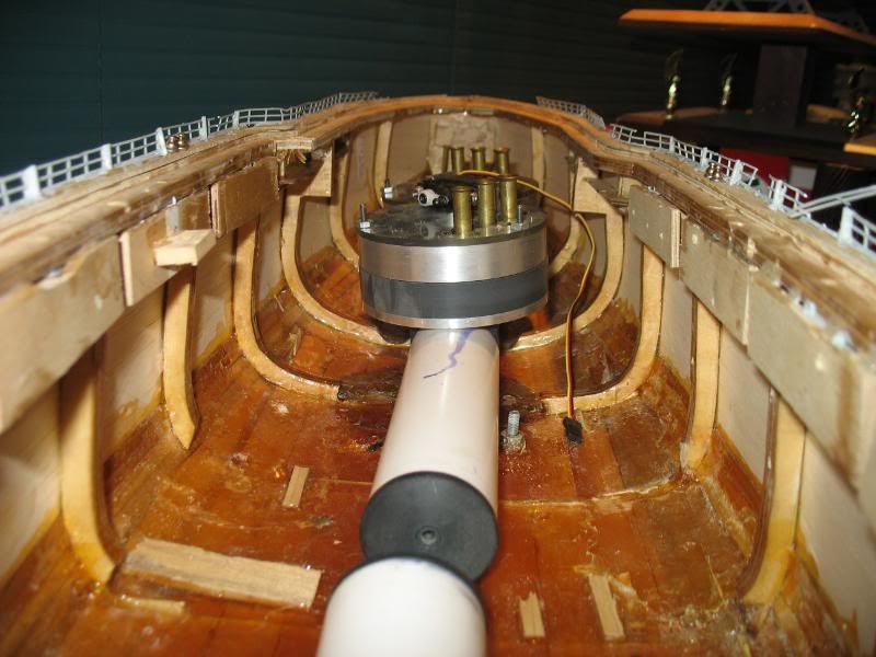

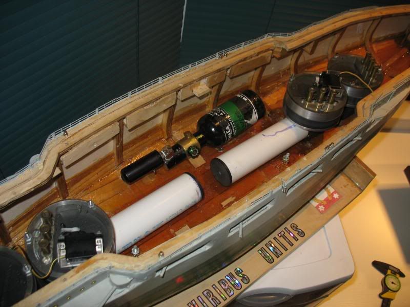

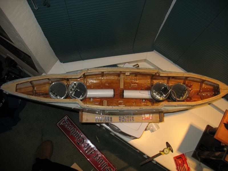

    This is MY Viribus Unitis, with the gun layout that I would recommend for a rookie builder. Two TANDEM BDE triples, with the accumulators pointing amidships, and one 9oz or 12oz CO2 bottle on either side of center. The 4-oz bottle is provided for size reference only. There is plenty of room elsewhere for motors, batteries, and electronics, if you know what gear to use. It probably would NOT have room for the Fire Control Computer and solenoid firing mechanisms, but those further increase the cost and complexity.
    PS: don't expect to see this ship sailing any time soon. The hull construction is fully four years outdated and completely lacks any attempt at damage control. Once my transports are done, I will begin construction on two NEW VU's, with more modern construction and electronics.
