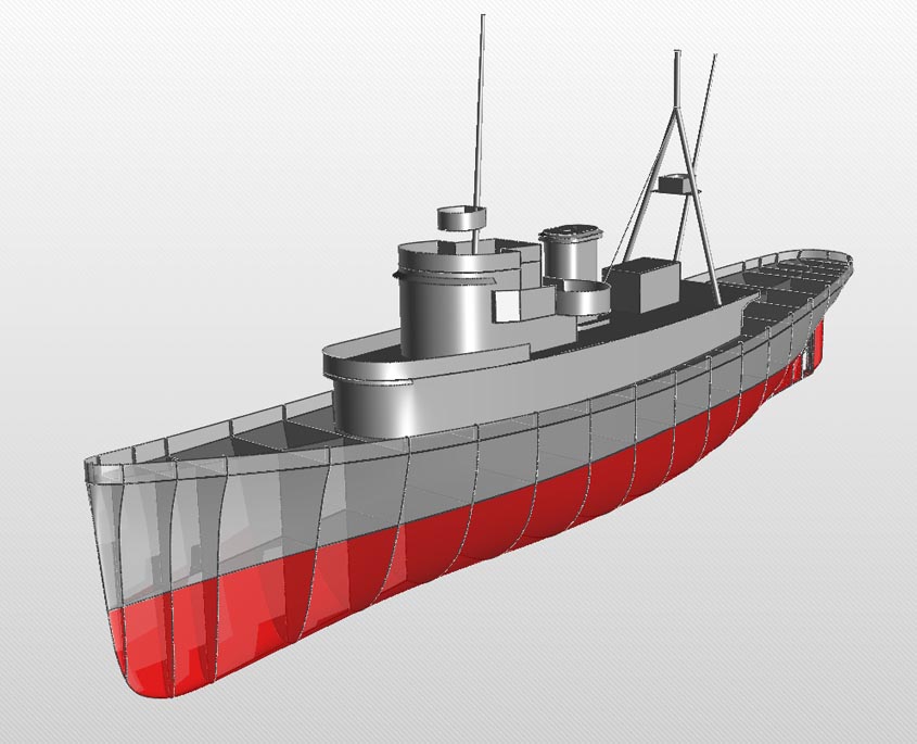

  18. wfirebaugh
    wfirebaugh Well-Known Member
    Aug 8, 2013
    524
    El Paso Texas, USA
    AT-64 - 65 have the same high pointy aft while AT-66 and all the later ships of the class have a low square aft section. I am going to design the ship as the early ship design. I am debating on having both aft sections to let the builder choose.

  20. wfirebaugh
    Aug 8, 2013
    524
    El Paso Texas, USA
    A few days ago I started in Photoshop Taking Screen captures of the model to build a PDF. Resizing and measurements are made easy in my opinion. There really isn't a really good way to pull things out of Delftship, only real way I think it would work is if I used the Paperkoura program that takes a 3D model and breakes it down for a paper model to be built.
