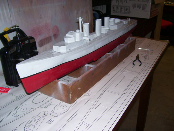

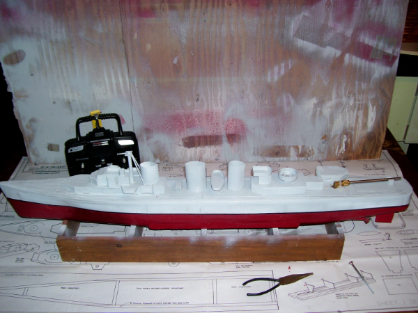

    Here's a few updated pictures of HMS Abdiel. She didn't make it on the water today but she was finished up except for a few very minor things, she had another float test in the bathtub and her waterline needs to be moved down about 1/4". I'm happy with how she came together, I wish there was a more accurate hull available for the class though but for my first build it worked ok.

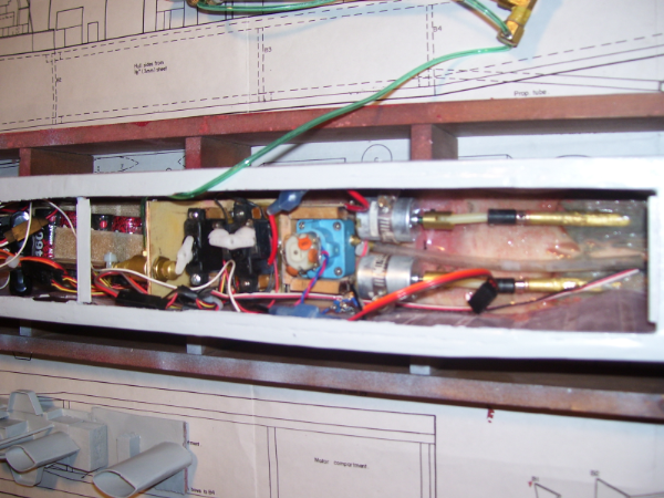

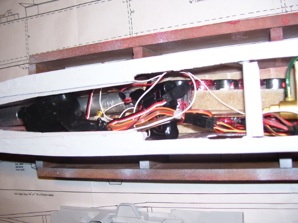

    As you can see I have to make an opening in the deck for the pump outlet as well as bundle and tie wrap the wiring to make it neater. The forward main mast is a little oversized as the deans mini-whip will be run up through it. Then it's just a little bit of fill for some areas of the superstructure(such as where the forward superstructure meets the deck)and a quick touch up of paint.

    The hull is fiberglass and is from BSY in Oz. The weight of the ship is 4.65lbs(max is 4.88). She uses a standard servo for the rudder, 2 micro servos for throttle and firing valve. The motors are 280's from BC, the pump is a micro one from BC, the battery pack is a NIHM 4600mah then in the bow is the Palmer Lite reg and 12g co2 adapter, the receiver battery is just a standard Futaba 700mah.

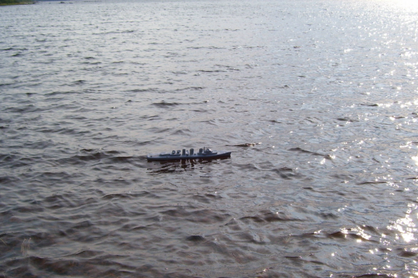

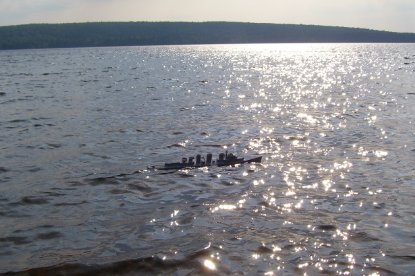

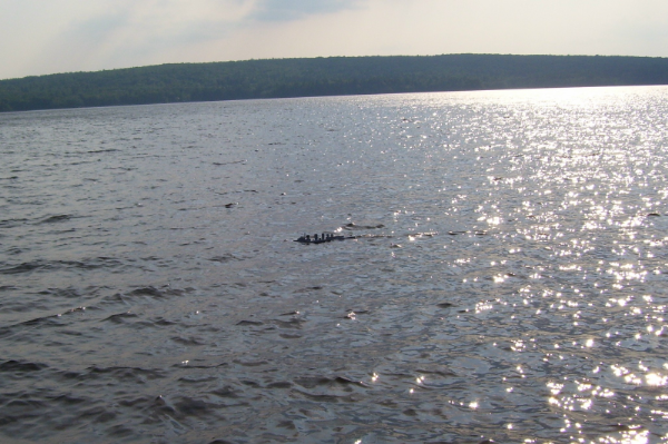

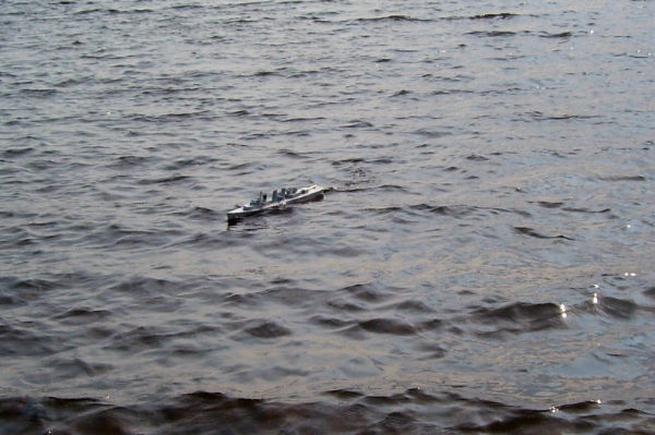

    Here's a few shots of HMS Abdiel on the water. The pictures aren't the best, but I was sailing with one hand and taking pictures with the other. The water was a bit choppy as you can tell by the picture with her nose buried.

    The pictures I just posted are in sequence(Bottom Page 2). I started off, little farther, hard to port,crash through the waves then bringing her closer to shore. I went about 15ft going through the chop and didn't notice my pump fire up,so brought it into shore thinking maybe I had a malfunction, but the deck seal held up.
