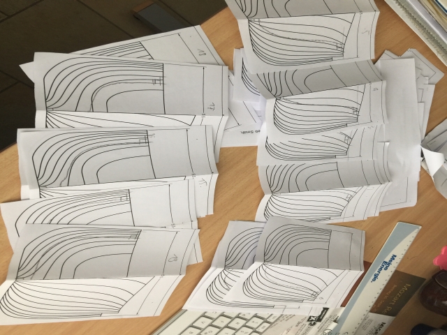

    Hello everybody, and greetings from the other side of the Great Pond!
    I've been wandering around on this website for nearly a year now and by spring I made the decision to build my own combat boat and to open up on this hobby in Europe. I began to translate the IRCWCC rules into German (and to modify them with ideas from Treaty etc...) and looked around for a good, easy ship to build. First, mainly after reading Mike's Béarn thread, I liked the idea of a Normandie-class BB,
    then I tended towards a pre-dread, and after finding Tugboats SB-101 Édgar Quinet thread, that was my ship of choice, before I finally, once and for all, decided for the Suffren (to avoid the same fate as a certain AdmiralBangerBang...;)).
    I startet with Beaver's beautiful rib templates and Tugboat's wonderful lessons on how to use them.

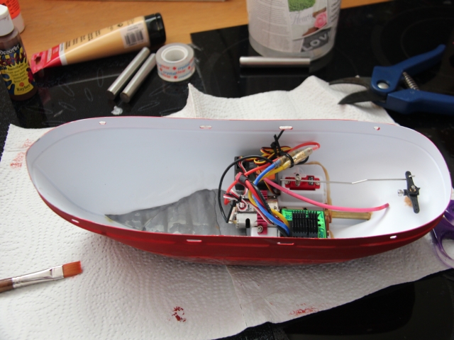

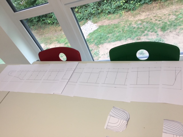

  5. Logan Gyre
    Logan Gyre Member
    May 15, 2018
    64
    Switzerland

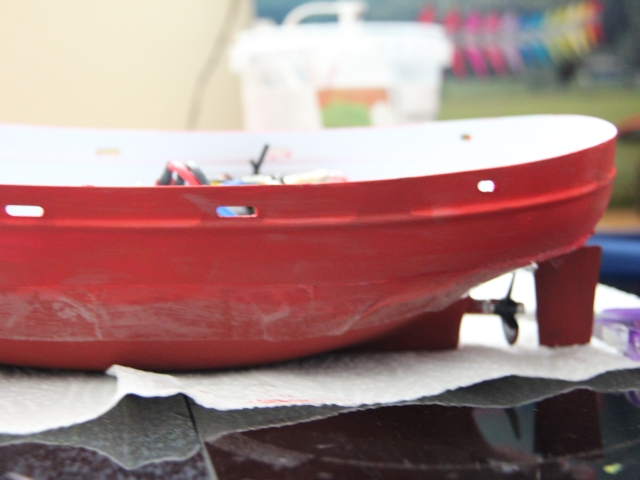

    Actually a fishing trawler, but I might rebuild it as a tugboat to take care of out-of-control ships.
  6. Logan Gyre
    Logan Gyre Member
    May 15, 2018
    64
    Switzerland

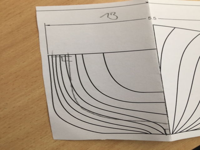

    Little question on keels: can I put the bow and stern keels in from above?
  7. Beaver
    Do you mean cutting the notches so the ribs slide on to the bottom of the keel instead of on top?
  8. Logan Gyre
    Logan Gyre Member
    May 15, 2018
    64
    Switzerland
    Yes, because the first three ribs or so are very slim in the bottom.

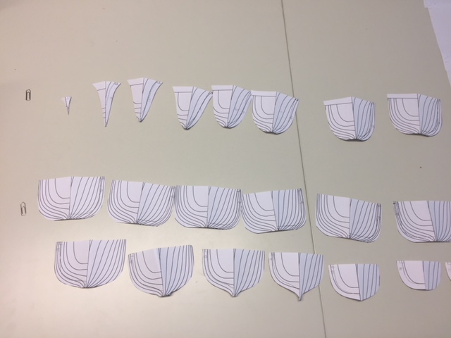

  9. Logan Gyre
    Logan Gyre Member
    May 15, 2018
    64
    Switzerland
    All the templates laid out. Saw availiable from next week on.
    Beaver and froggyfrenchman like this.

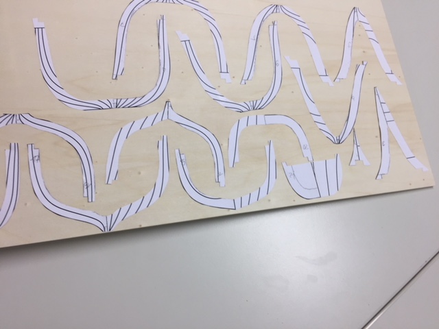

  10. Logan Gyre
    Logan Gyre Member
    May 15, 2018
    64
    Switzerland

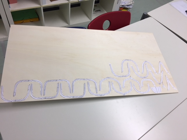

    Wood arrived, ribs ready to saw.
    Opinions?

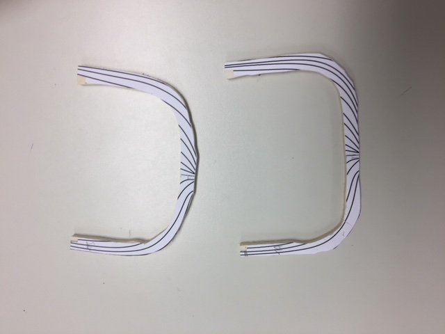

    First two ribs nearly done.
    SteveT44 likes this.

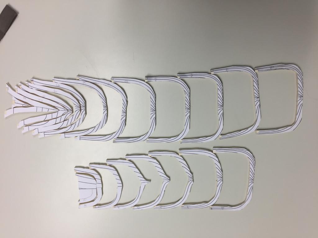

  12. Logan Gyre
    Logan Gyre Member
    May 15, 2018
    64
    Switzerland
    Aannnd...
    The rest.
    NickMyers, froggyfrenchman and Beaver like this.

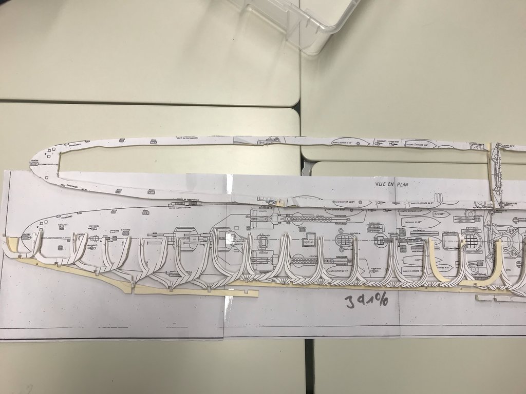

  15. Logan Gyre
    Logan Gyre Member
    May 15, 2018
    64
    Switzerland

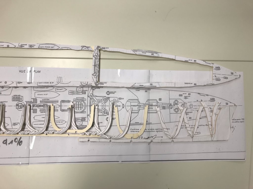

    Continuous production of sawdust, here are the results:
    Little problem I found: The combined length of the subdecks and the keels is off by nearly an inch.
  16. warspiteIRC
    warspiteIRC RIP
    Aug 17, 2008
    756
    Annapolis, MD
    How about the width compared with the deck? You have two choices: 1) redo the deck pieces or 2) modify the existing ones.
  17. Logan Gyre
    Logan Gyre Member
    May 15, 2018
    64
    Switzerland
    Don't know about the beam, but it seems more like the keels are too long rather than the decks being too short.
  18. Maxspin
    Maxspin -->> C T D <<--
    Jul 30, 2014
    634
    Yelm, Washington
    I went back and read Caleb’s post for the Suffren plans. There is some overlap in the plans because they are on multiple pages.
    We know that Suffren is 53.5 inches long “IRCWCC Ships List”. Measure your keel to determine if it is correct.
  19. Beaver
    The side profiles do not overlap. The midship hull profile defines three rib stations but the side profile should be the combined length of the ship.
  20. Logan Gyre
    Logan Gyre Member
    May 15, 2018
    64
    Switzerland
    Measured again, Beam is OK, both subdecks and keels are off slightly, probably because of printer inaccuracy
