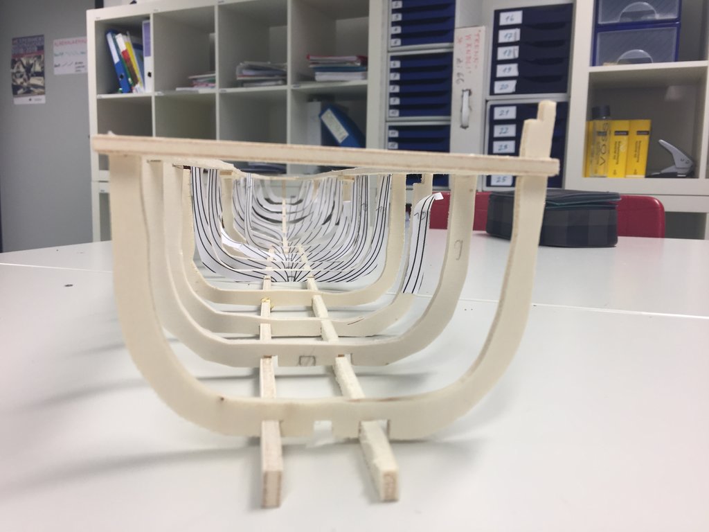

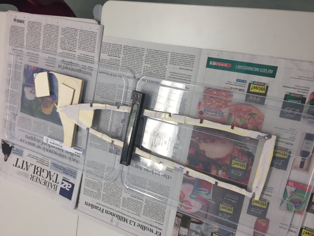

    Lengthened and notched the subdeck

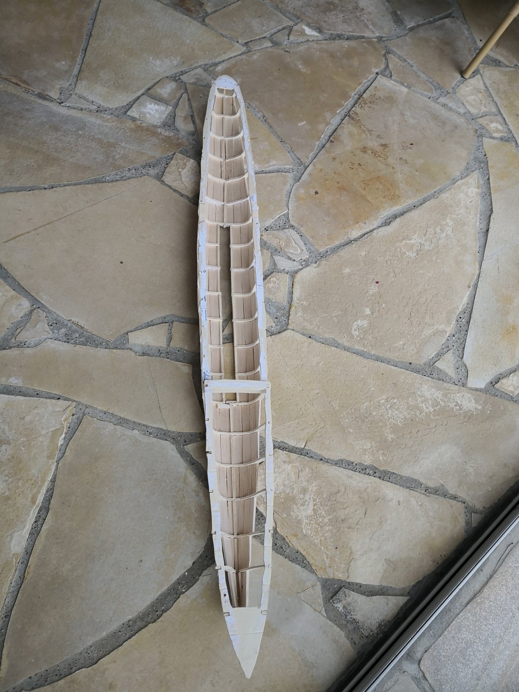

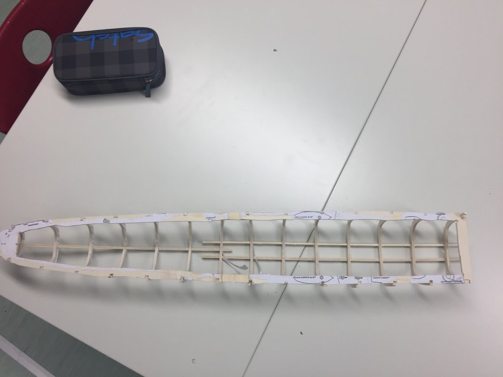

    Today the Suffren, after having all the notches adjusted, was assembled and finally looked like a ship!
    Next up will be to bend the forward subdeck and to glue the thing into one piece. Hope to have that done by next month to be ready for balsa blocking and fiberglassing once it’s warm enough.

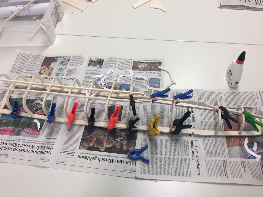

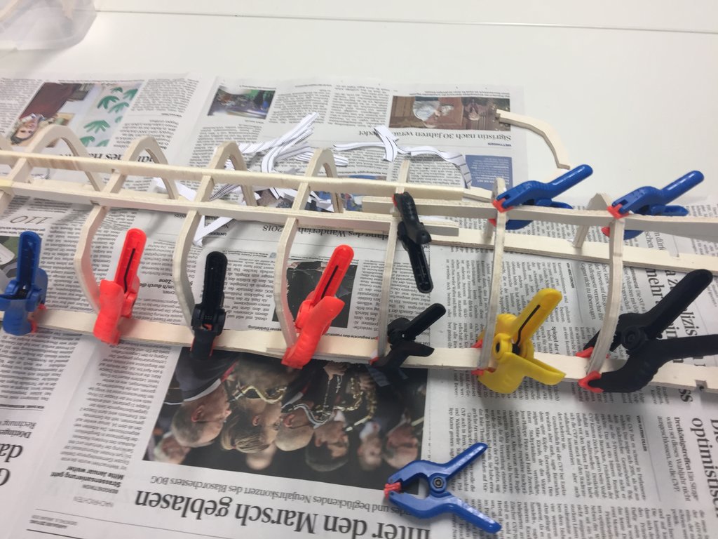

    Pics of the rear part of the subdeck assembled and halfway glued.
  5. Logan Gyre
    Logan Gyre Member
    May 15, 2018
    64
    Switzerland
    Continued glueing today,the number of clamps needed for a ship is astonishing!
    In some more detail.
    Also wettened and suspended the subdeck for a nice bend.

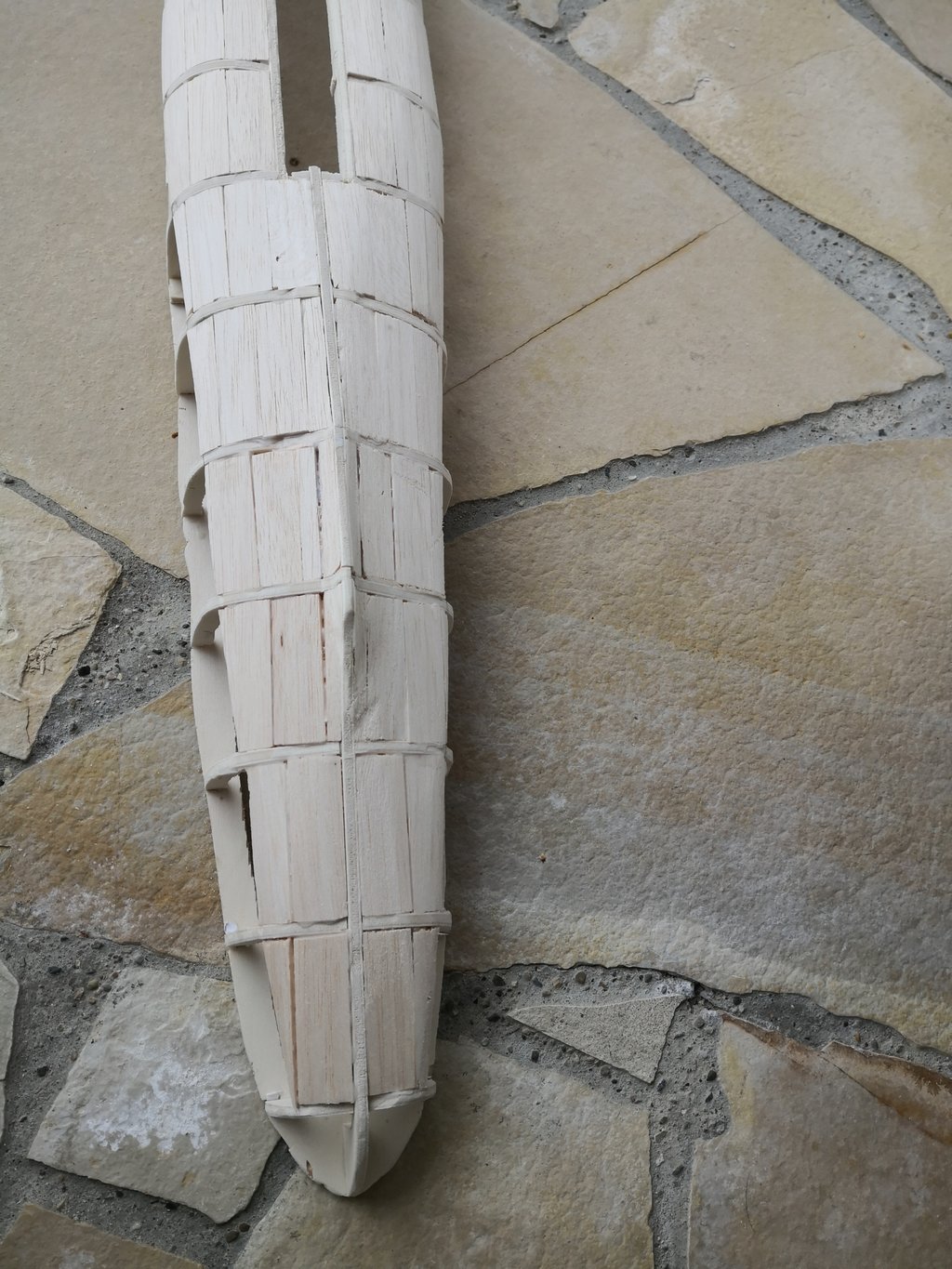

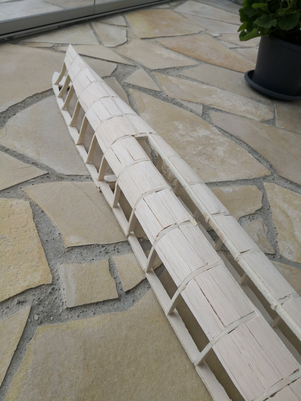

    I started glueing balsa blocks into the lower hull sections (no pics, unfortunately) and made some nice progress in the 45o stern area.

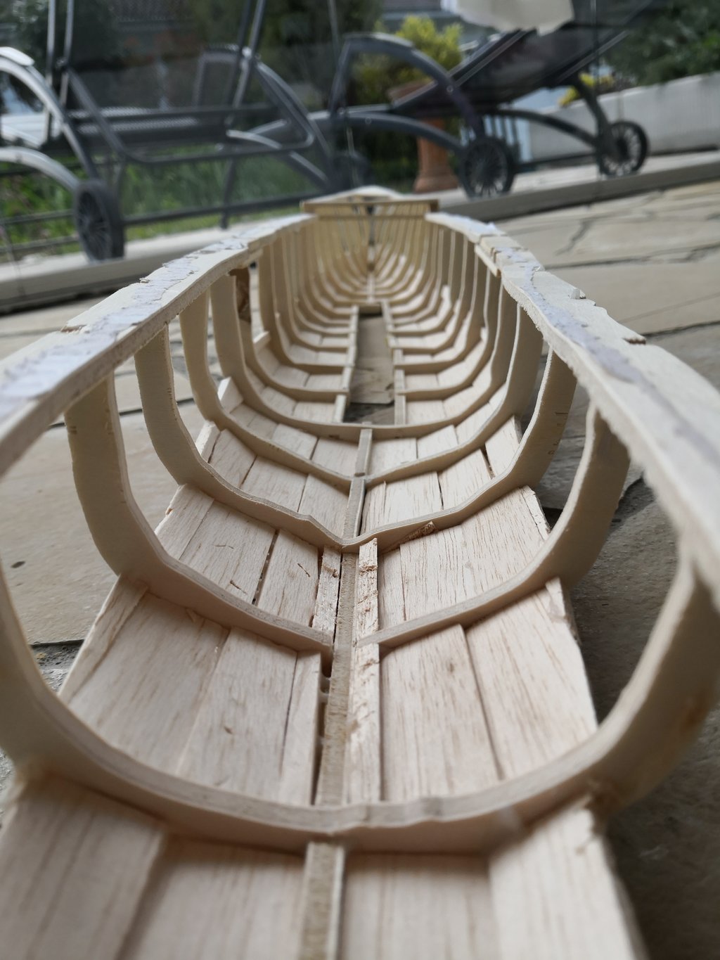

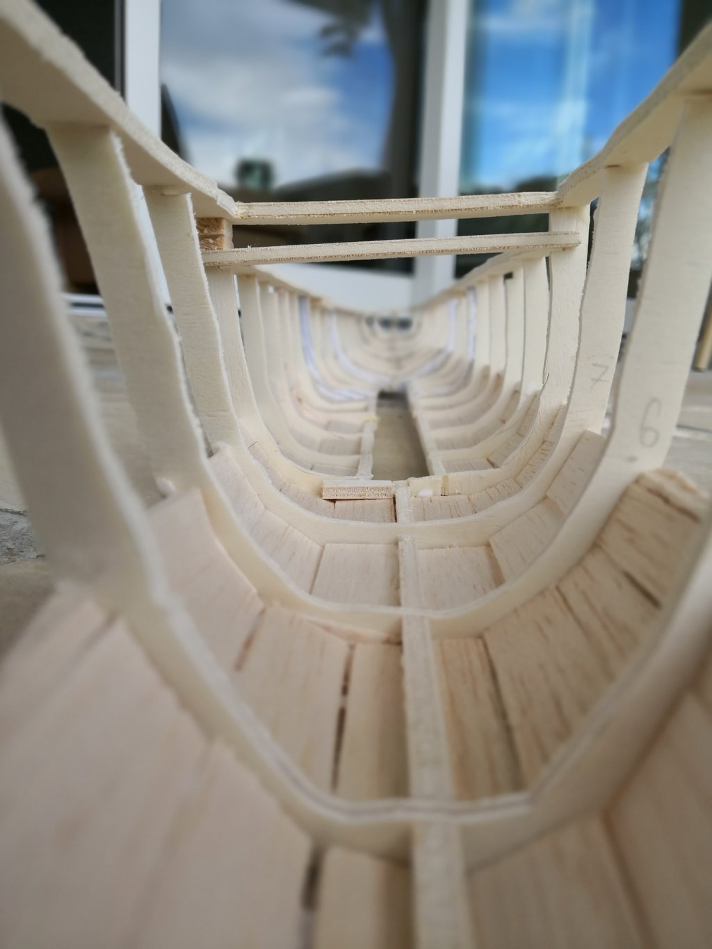

    Blocked the whole ship and sanded it down.

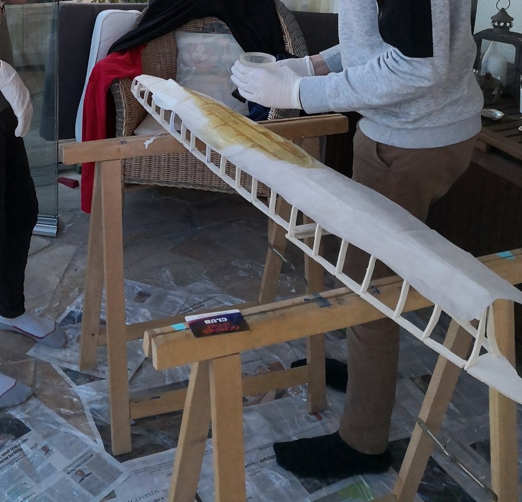

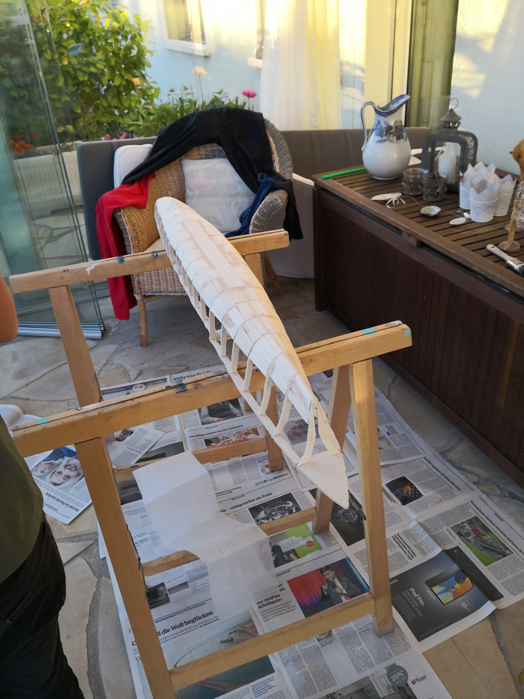

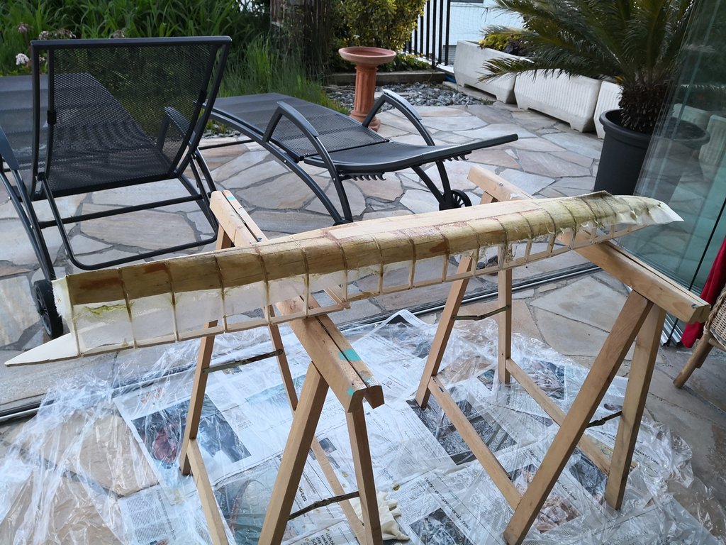

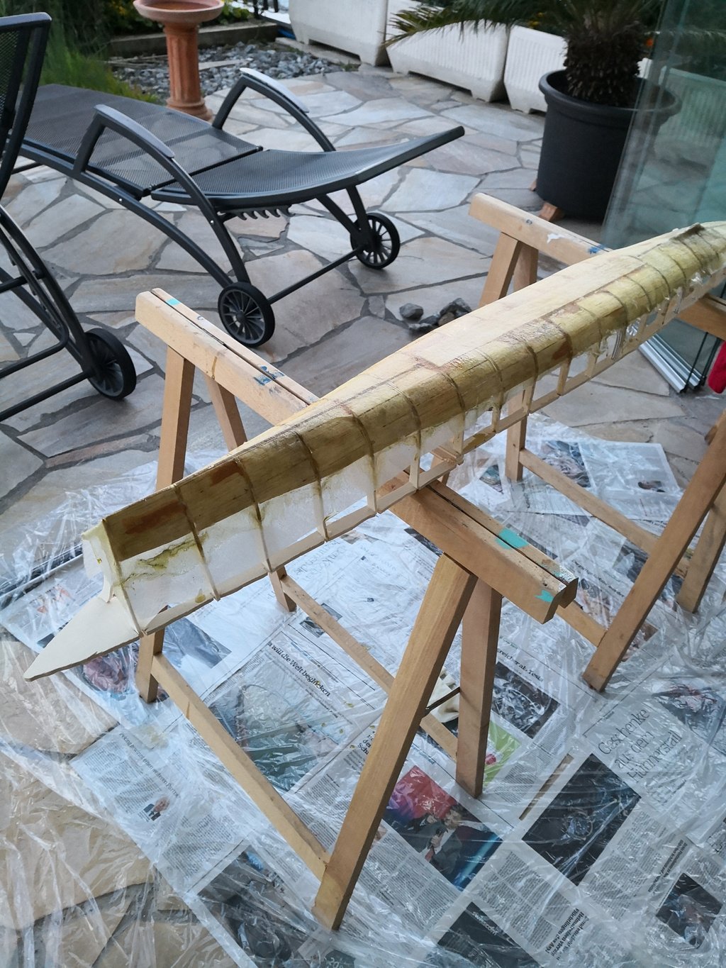

    Just fiberglassed the ship, curing out now.
    All set up
    Applying resin

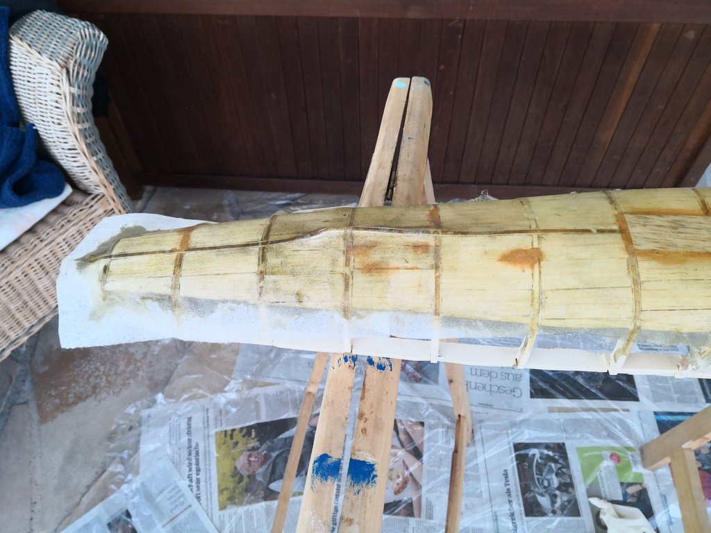

    Finished hull, curing out
    This part where the keel pokes out was a bit complicated
    I'll see how it turned out tomorrow.
