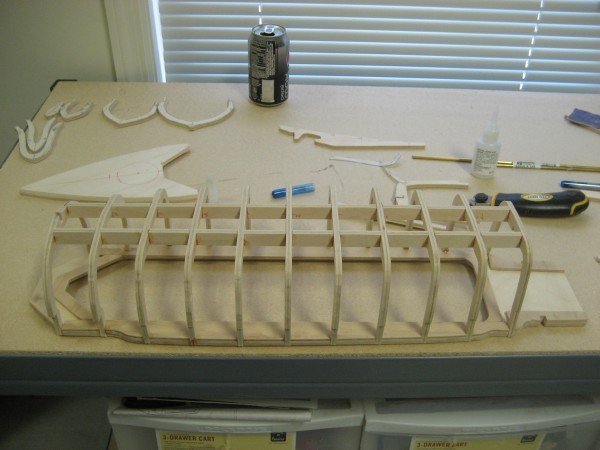

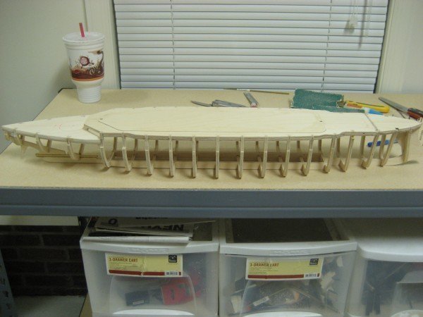

  2. mike5334

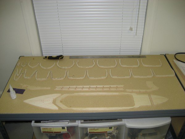

    The center hull framed up. I went with a 3/8" subdeck this time around instead of my normal deck built up from 1/8" wood.

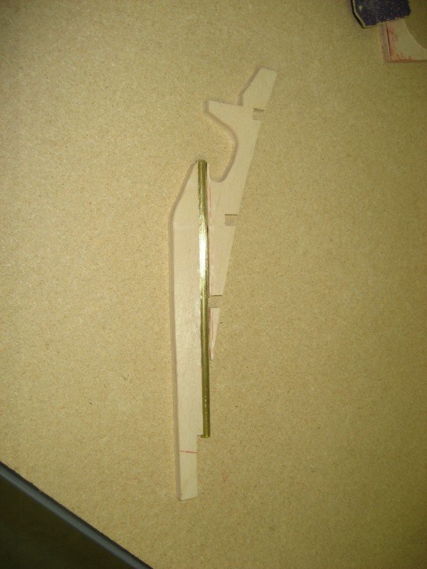

    The rear keel section gets the stuffing tube stuffed into it. heh

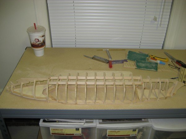

  3. mike5334
    Bow and stern framed up.
  4. mike5334

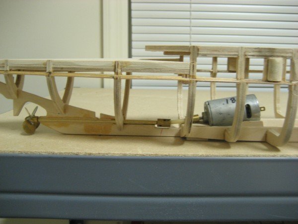

    A stringer is installed for the step in the hull side. Although I could have made the stern solid from the subdeck down to the stringer (the gap is smaller than a BB), I wanted the ship to be perfectly legal above and beyond the rules. The rear casement has yet to be installed.

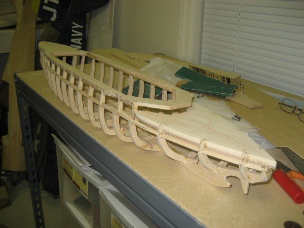

  11. mike5334
    I'm sure I have a set of the Danton plans tucked away too. Heh.
    There is plenty of room between the aft turret and the prop shaft for a pair of cannons. The motor will be located about 3 inches behind the aft turret. I may do some creative magazine bending, but at the moment straight mags should work fine.
    About the only thing that isn't planned yet is what batteries to use. I'm leaning towards Lipo at the moment to save weight and get capacity for a brushless pump motor. If all else fails, the ship will have a high capacity NiMH battery pack.
    Last night, the right side stringer was installed and the left front casement finished. Basswood blocks were glued to the bow for later shaping. After the stringers and casements are done, the plan is to install the rudder post and linkages, as well as test mount the cannons. I would like to try to get as much done inside the ship before glueing in the balsa hull bottom ... the inside of the ship is small!

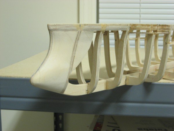

  13. mike5334
    Those bow fins were on a few French ships. I'm pretty sure the Bearn plans had one on it, and I know the Suffern plans had one as well.

  15. mike5334
    Nope. Just a little fin that stuck down from the bow of the ship.

  17. mike5334
    The nose blocks are sanded into a fairly pleasing bow shape.

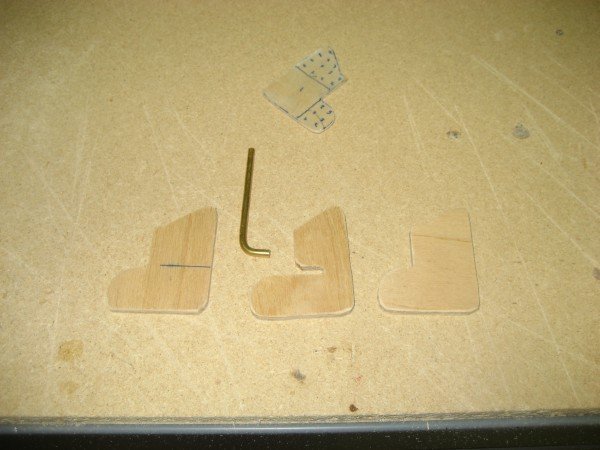

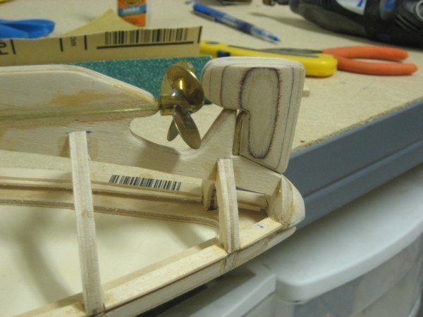

  18. mike5334
    Rudder pieces. Rudder is made by stacking two outer plates on a center core plate then sanded to shape.
    Rough sanded rudder test fitted into place to check free mocement. After a good sanding with 220 grit, the rudder will get varnished with teh rest of the ship.
