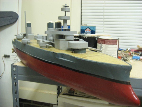

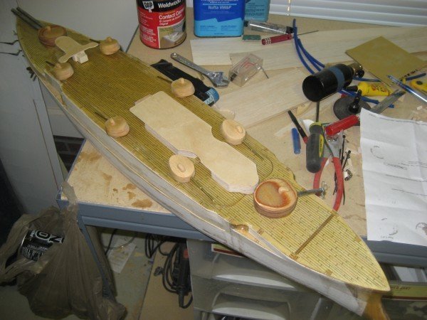

  6. mike5334
    Some of the 1st level superstructure work, secondary turrets, and main turrets. The mains were very easy to make.

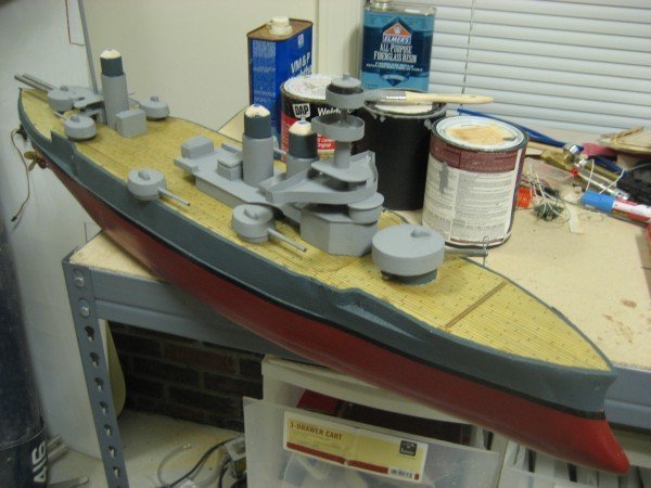

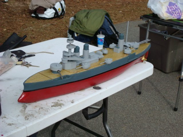

  7. mike5334
    Welp, the exterior work is 95% completed. Still some touch up painting needed on the stacks and the deck hold downs installed. BC is going to get an order next week for something like 14 lifeboats and launches ... the Verite had a LOT of those! That'll finish the deck detail as far as I want to go (Unless someone knows where I can find some prefabbed deck railings).
    Inside, I've still yet to finish and test the wiring. Everything else is in place. I've taken Friday off from work to finish the ship in time for the Region 3 BB Fest this weekend. I'll post final pictures from that event early next week. :)
    Until then, enjoy a couple bench pictures of the FN Verite.

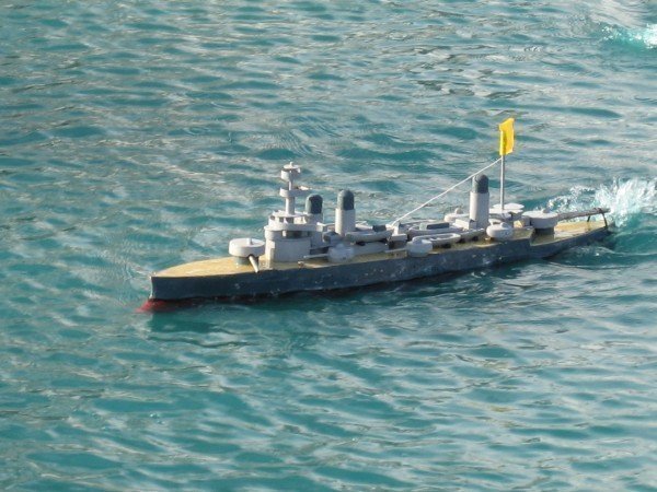

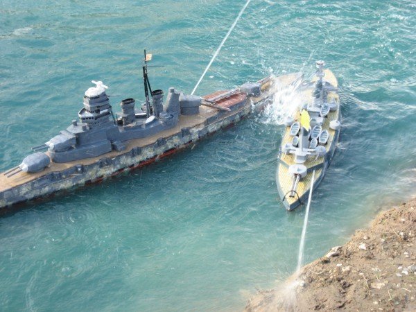

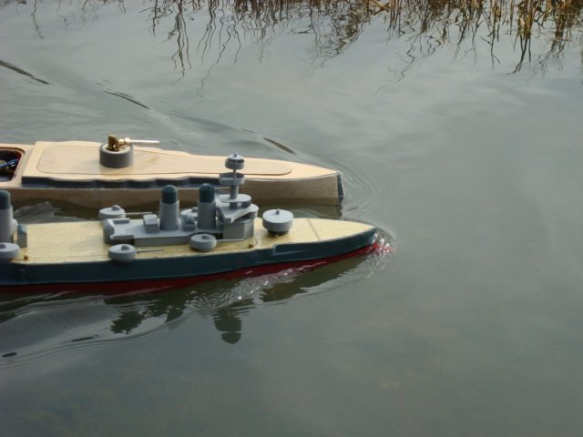

  18. mike5334

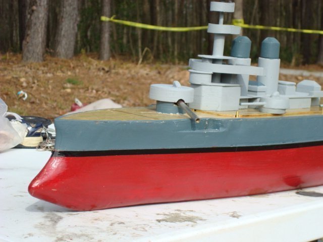

    Ok, a few final pictures to close out this build thread. :)
    While battling with others, there is always the element of compromise. Sometimes, one has to give ...
    ... and take. :)
    All in all, I am very pleased with the Verite. It turns rather well due to it's small size, even though it only has a single rudder. During the Bruhaha, it did sink multiple times mostly because the captain kept trying to battle it like a battleship. Heh. But after working out a couple mechanical issues and changing my battling style a little, the ship proved to be a tough little thing during the last battle by emptying all magazines and surviving it's 5 in both sorties.
    The little ship is a blast to battle with!
