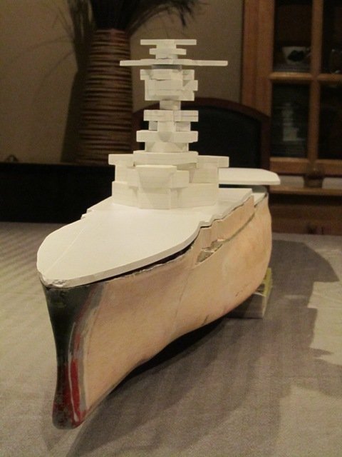

    on the tirpitz, i expoxed the foam pieces togeather and also ran a brass rod thru them. this worked very well with a large stack up. also have a place for a flag on top to now
