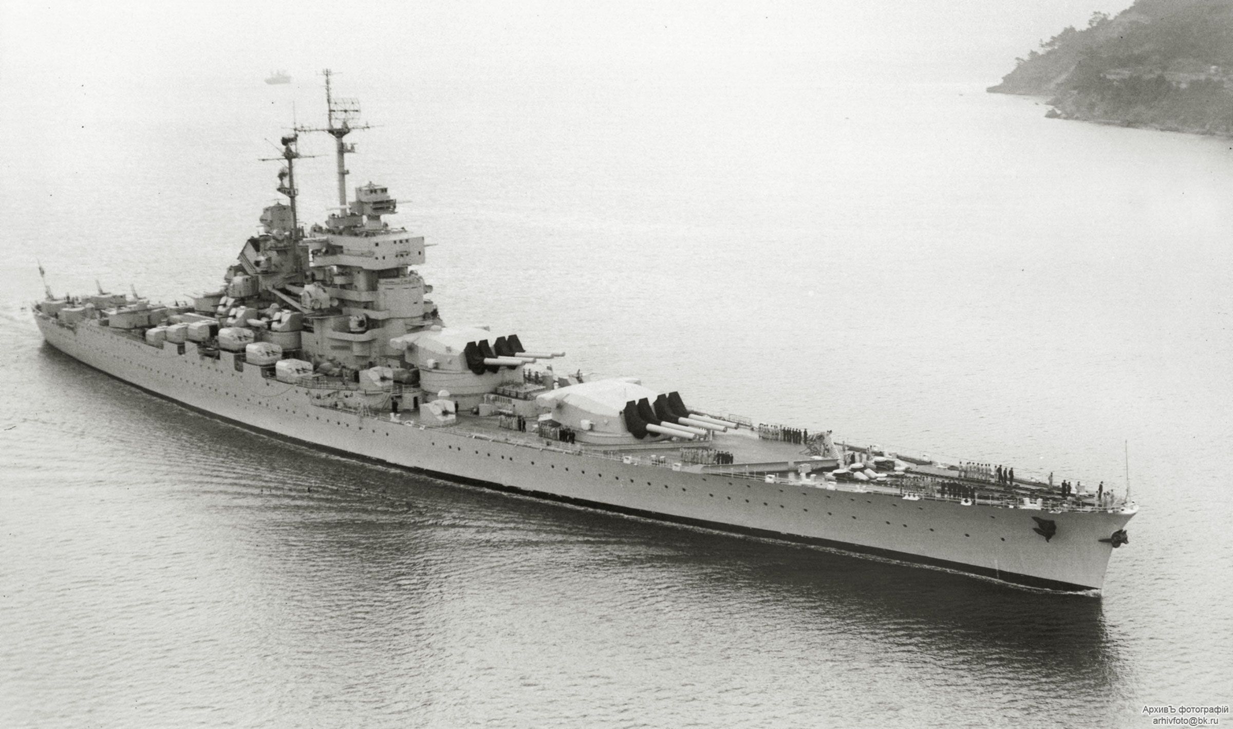

    So Dave, I am just getting confused. What is the difference between the ship in the diagram's deck step and the Jean Bart's deck step up to B turret? Let alone the fact that making that whole area hard would violate rule 11 which states maximum allowable subdeck+deck thickness? If the weatherdeck is the weatherdeck, why do deck steps count? I would imagine that this works the same. The major difference between the ship in the diagram's B turret and Jean Bart's would be that the upper deck area on Jean Bart is technically part of the hull, it's shown on hull drawings, it comes all the way out to the ship's edge. On the diagram ship, the weather deck surrounds that raised superstructure area very clearly. JB the weather deck ends at frame 10 with the deck step upward, and then steps back down at frame 4 for the stern. I am not trying to argue as I am the novice here, I am just confused by the multiple interpretations I am getting about the same rule.

    My only major concern would be that on the actual ship, and the model by extension, Jean Bart/Richelieu/Dunkerque there is absolutely no horizontal deck "around" that raised area. Example:

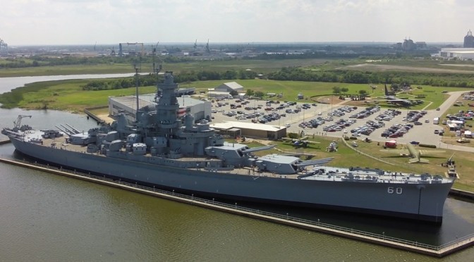

    USS Alabama:
    You can clearly see a small deck area that continues the weather deck around the ship's 01 superstructure level. In this instance, that is definitely considered superstructure.
    Jean Bart. There is no horizontal deck surface that continues the weather deck aft. The weather deck ends. But the weather deck can't end, it must continue the whole length of the ship. So the weather deck would logically "step up" and become pont chateau where B turret is located. At the aft end of the ship, the deck steps back down. That raised area is even shown in the vertical hull drawings as part of the hull frames.
    I just want to be 100% sure, because you know how the IRC works. If Jean Bart ends up being some wunderbote (which I *extremely* doubt haha) everyone will examine it with microscopes and find all sorts of stuff to cry legality about. Doubly so if others will be building from my drawings, I want to make 110% sure that their hulls will be legal as per the rules as written 9/2018. I don't want anyone spending their time, money, and energy building off of my plans only to have their boats be "wrong".

    To counter the above, if you look at the ship's actual vertical frame drawing you can see that the hull extends up to pont chateau.
