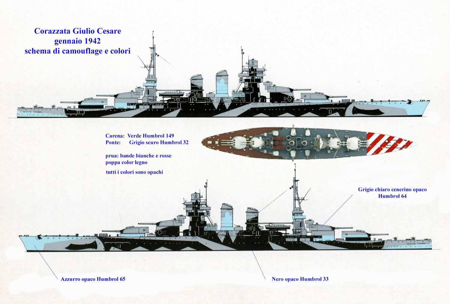

    So for the following post, I am throwing up some pictures of the design I hope to use.
