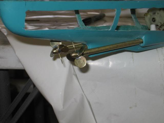

    Its 70 feet in reality, same as Fred's Boston, only shorter. Yea, they look great with the struts on, they are in a great position.

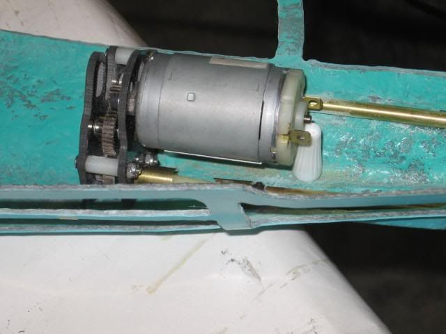

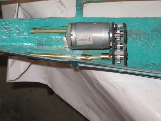

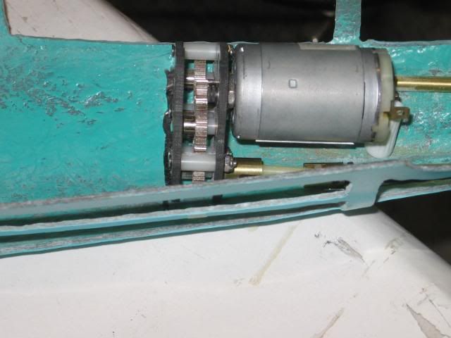

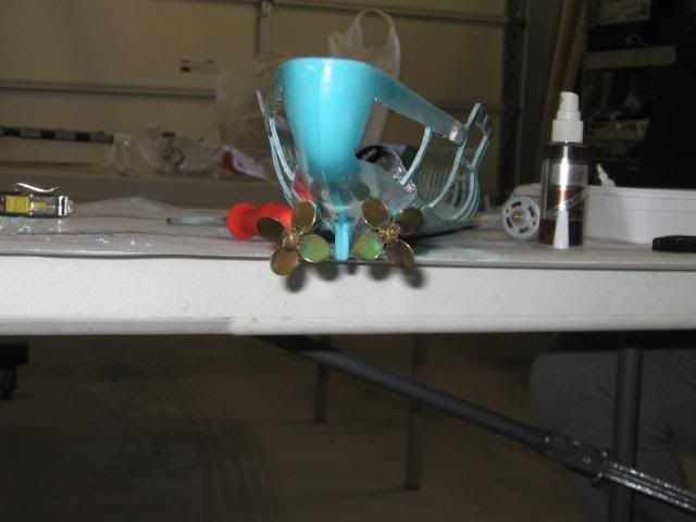

    Pictures as promised
  3. BoomerBoy17
    Looks great Rob, thanks a ton. I'd like to thank you for turning my hull-with-a-lot-of-wholes-in-it to a ship- with-the-ability-to-move.

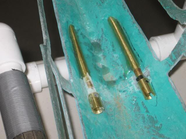

    Pics of the rudder post too to come soon, but not too soon : )
  4. BoomerBoy17
    Hey, what about a small piece of PVC, the same i used for my ship-holder thingy, as my motor mount. It will be protected, with armor in the way of flying bbs, is water proof, easy to shape and easy to drill. Also, work on the SS should begin soon.
  5. djranier
    I think I like how Mike M did his mount for that gearbox the best. He used a wood block that fit between the shafts, and mounted under the motor, so that the motor fit snugly into a recessed area of the block of wood, and then drilled holes thru the sides of it for tiewraps. Then he just tie wrapped the motor to the mount with 2 tiewraps.
    His worked great, was easy to get out when needed. Just make it as tall as needed so that the gearbox lower corners touch the hull, that way the circular torque will not be able to turn the gearbox over. Which by the way would not be good.

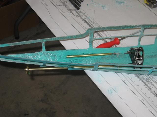

  15. BoomerBoy17
    The rudder post is already in, and i have the servo. so i just need to pick the gears, install them, and find a way to make sure that the rudder doesnt fall out the bottom of my boat.
