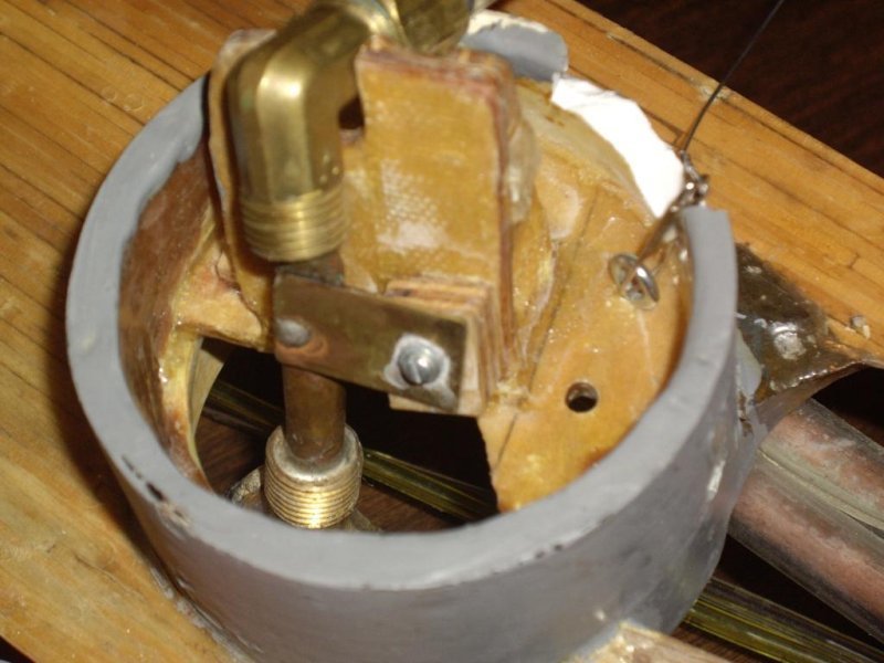

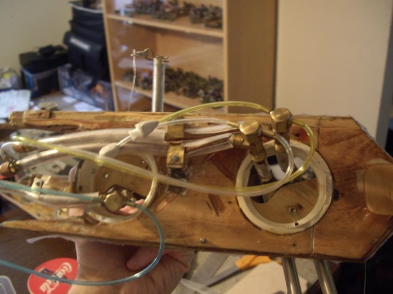

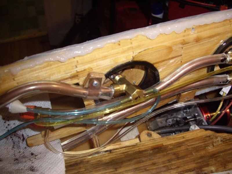

  3. SnipeHunter
    Here are some pictures of how I mount my guns. I solder little tabs to the mag and upfeed and then screw those into wood blocks that are epoxied to the deck.

    Good idea Snipe, I like the way you do this...
    Necro! Chris, do you solder the tabs on whilst soldering the other parts, or afterwards? I get problems with post-soldering soldering where things come loose... but I'd like to use your method on my I-boat rebuild.
  8. SnipeHunter
    I do it after all the other parts. I normally leave the guns to last since they are the least important system. I add the tabs after I see how I need to fit the guns and know where they will be close to the deck which makes everything easier.
    As for soldering the tabs on without everything else coming loose. It isn't the easiest thing to do, prepping the area correctly helps a lot. Use a decent torch. But the real trick is to heat sink the parts you don't want to come loose! I typically take some paper towel, wet it with cold water and wrap that around the T or Elbow that I don't want to desolder. Heat the tab first and apply solder to that and then stick it onto the mag, continue applying heat until you get a good joint. It's a little tricky but results in a rather strong mount. (I typically bend barrels before my mounts break, well I did until I shortened the barrels so they don't overhang...)
