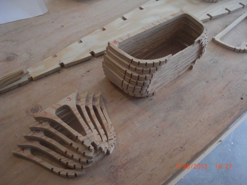

    The plans from Strike and the plans from Goff do not really account for the armor belt, at least not in the sense that I've been educated by tallented builders on how it is to be built. Keep that in mind, if you want the armor belt to show. So I'm having to use the 10% or 1/4" rule that allows the ship to be wider, at least for the extra spacing I need to add to the ribs to accomodate the armor belt. Alot of extra work, but I figure that once I add the armor belt stringer (3/8" wide by 1/8" deep) and set that into the ribs about 1/4", and then below that, beef up the rib with 1/8" x 3/8" wide aircraft plywood to where the first stringer for the Non-Penetrable region starts, and then go with balsa for that area and down to the baseplate, to make it easier to bend. Then insert my 1/4" x 1/8" stringers sideways to beef up that non-penetrable area, and everything should go fine from there. Then I can add the upper armor over the cap rail and the bit below it and cover the armor belt stringer, and then overlay the main armor belt on top of it (the stringer and the 1/8" armor above the belt - Big Gun Armor thickness for the 12" belt) and the beefed up ribs. Thank goodness that I used a 3/8" piece (accidentally) for the baseplate...that extra spacing in the ribs will now work for the thicker baseplate. Overall, it should make for a stonger and more permanent build...which is a good thing, and more accurate too. The deck will remain normal size. That should look nice and sharp.
    Notched ribs as they are now...actually, I added the notch for the Armor Belt after this picture.
