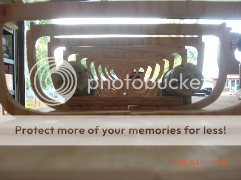

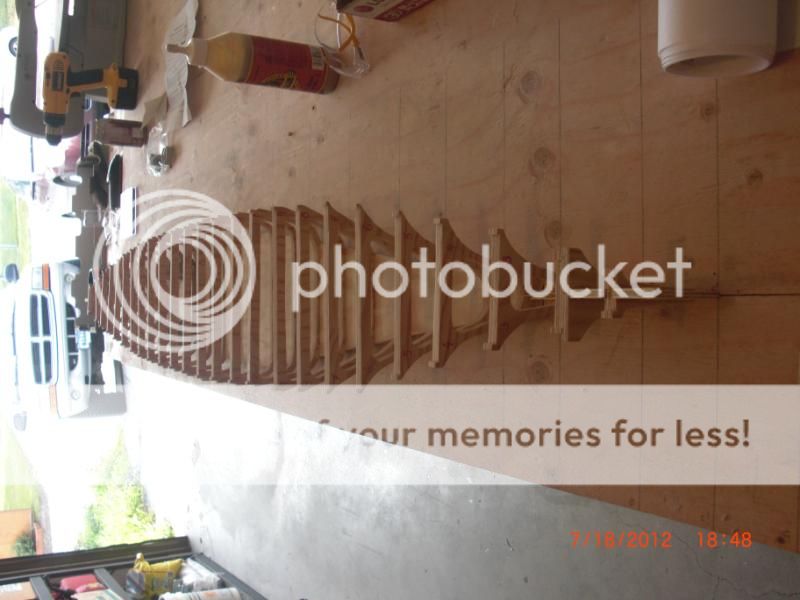

  4. Quintanius
    Quintanius Member
    Jun 19, 2012
    137

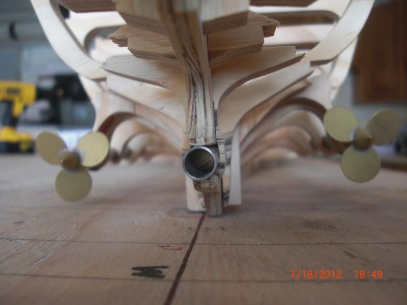

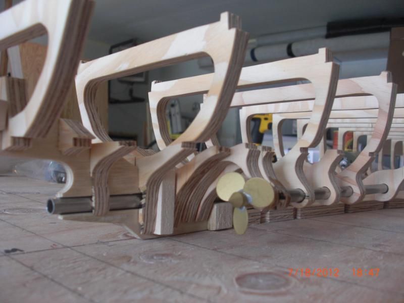

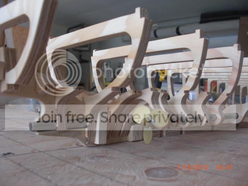

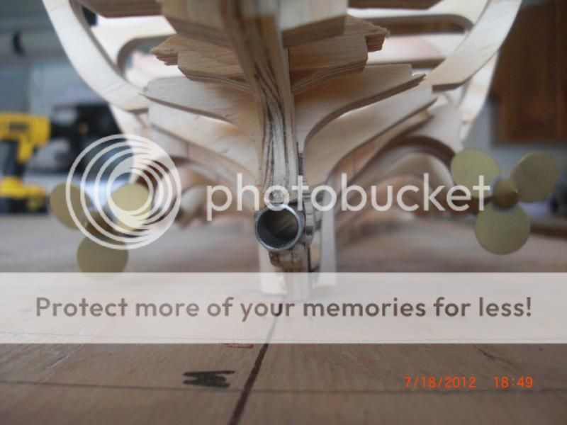

    Some pics showing my progress on the steel stuffing tubes:
