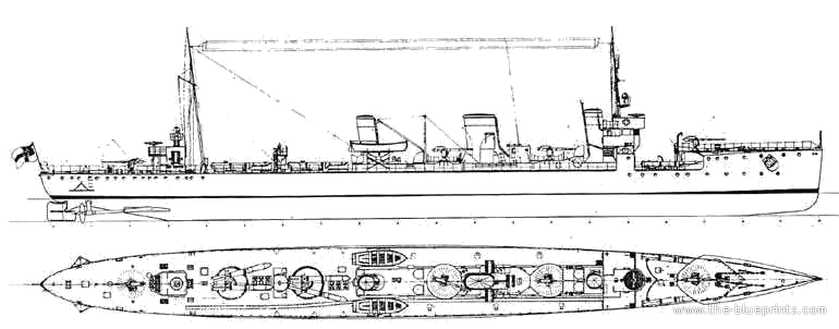

    My first destroyer was a USS Benson Class in the Big Gun class system. She was armed with one of two forward firing turrets (BB's), one rear firing turrets and four right side single shot torpedo tubes. That was a lot of stuff crammed in a very small space but she had some serious hitting power in a ridiculously small platform.
    My smallest ship was the WWI SM B-110 Torpedo Boat armed with two single forward firing torpedo tubes which are located just behind the turtle-back bow on what was known as a "wet-deck" main deck. Below are two examples of this type of ship.
    Even with the allowable increase in hull depth allowed in the Big Gun Rules this little sucker was a tough build. This was a FAAAAST little ship running 36 to 37 knots. It was low in the water, very hard to hit and much feared as it could swoop in nail a larger ship with two torpedoes and dash away. It only had the two single torpedo shots and then had to return to harbor to be reloaded, pump up the single small reservoir tank and then back out into the fray. The down side was that there was no room for any sort of bilge pump system so a single bb would take her to the bottom...if someone were to get in a lucky shot. All servos were stripped down to the bare essential and a battery system that barely supported more than a couple of attack runs before they had to be switched out.
    The only way to build something like this and get it to work is to totally seal the deck and hull to absolutely ensure that no water could enter from the deck and superstructure. This is a very WET DECK torpedo boat!! In fact one of the complaints from defending skippers was that were wasn't anything to shoot at because it was so small and fast, but remember what I mentioned before....ONE BB and she was gonner! It never happened under my command, but it was a very limited operational ship. A lot of fun as well as a huge challenge to build and run. That....and several folks told me that it couldn't be done.
