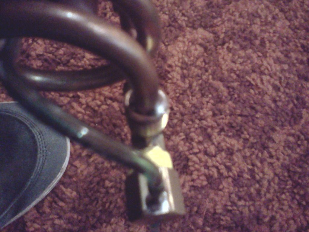

    I have to thank Curt for most of the help with my project. He just told me how to tweak my cannons now im happier than a kid on christmas day and i cant wait to shoot up my old ship models haha. and I thank you all for helping me out all this way it means alot knowing that somone is there to help you when you need it, and i hope to return the favor some day thank you ALL again.
    the bismarck i am hoping to get FULLY finished this weekend. all i need to do is wire up all the servos fix my lights, find that pesky leak in the hull which i think is comiming from the rudders or the coming out from the inside of the stuffing tube which i think its not due to how much lube i got in it. oh one last thing thank probably anyone could answer this for me i have a small opening in my cannon where they did not full soder around it. and it is shotting out a good amout of co2 when i fire. how can i fix this (im not good at sodering).
    sorry for poor quality, it was on cell fone.
  7. DarrenScott
    Solder. It's the only way to be sure, and it's not really difficult.

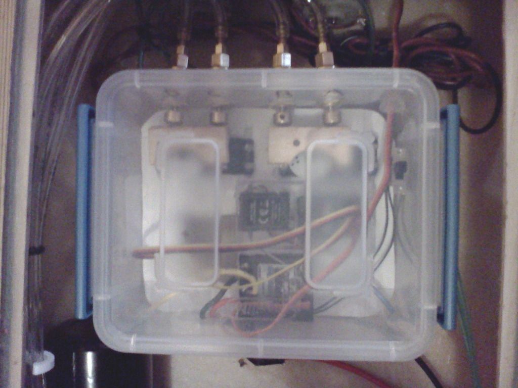

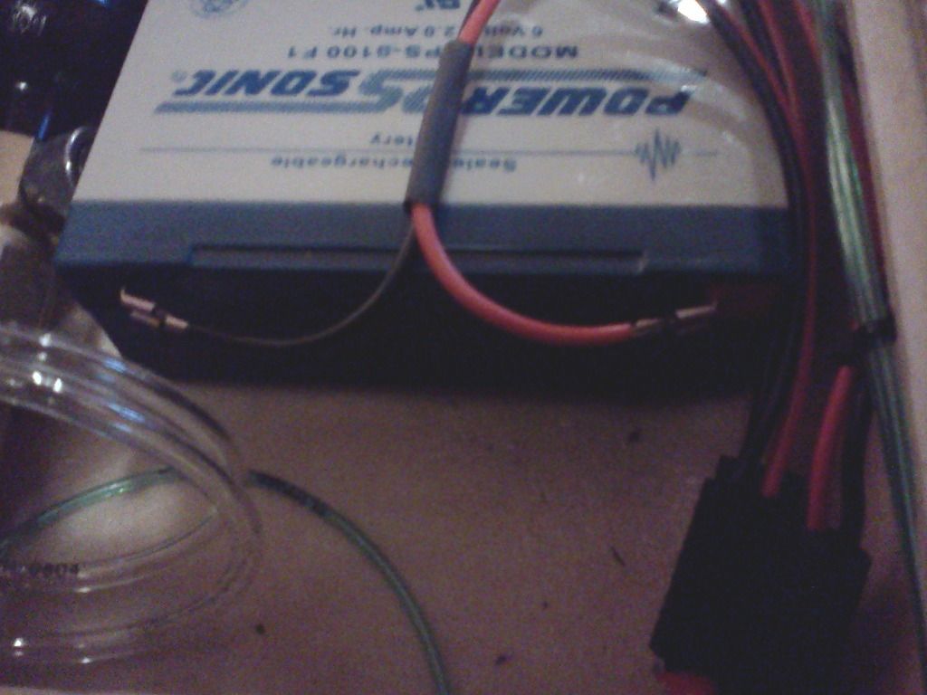

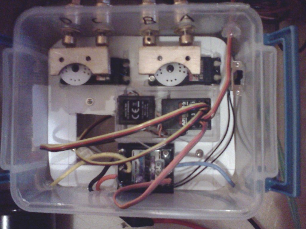

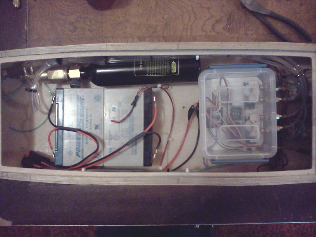

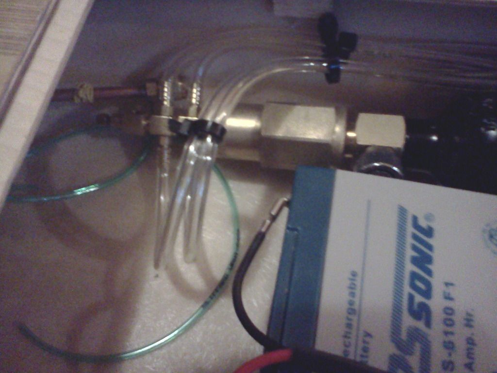

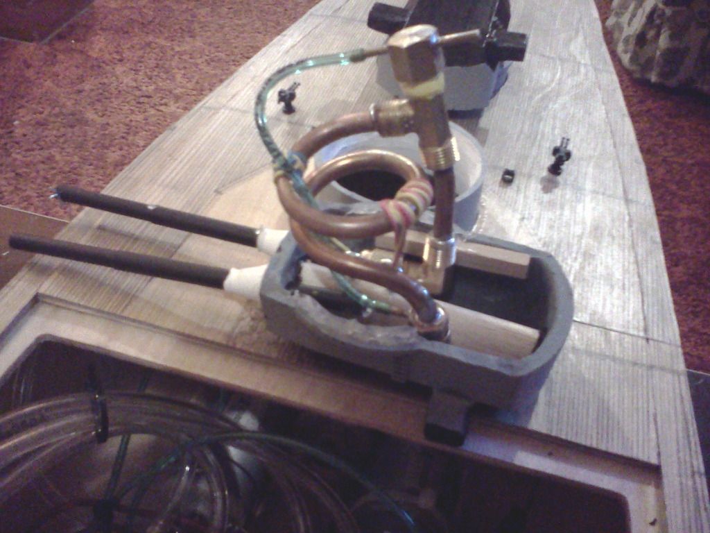

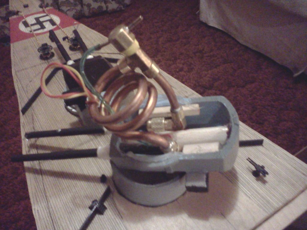

    Here are some pictures of what i got goin on, still need to paint fine details.
    any questions feel free to ask i will gladly answer.
    (my coiled turret set up)

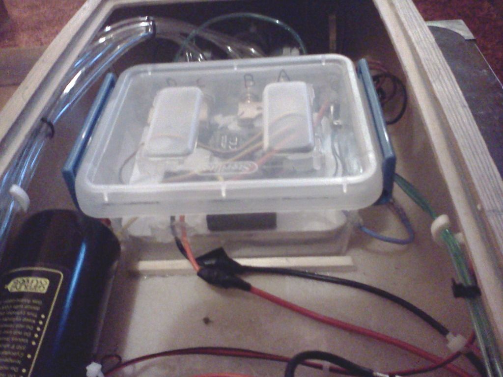

    Radio Room also fire control

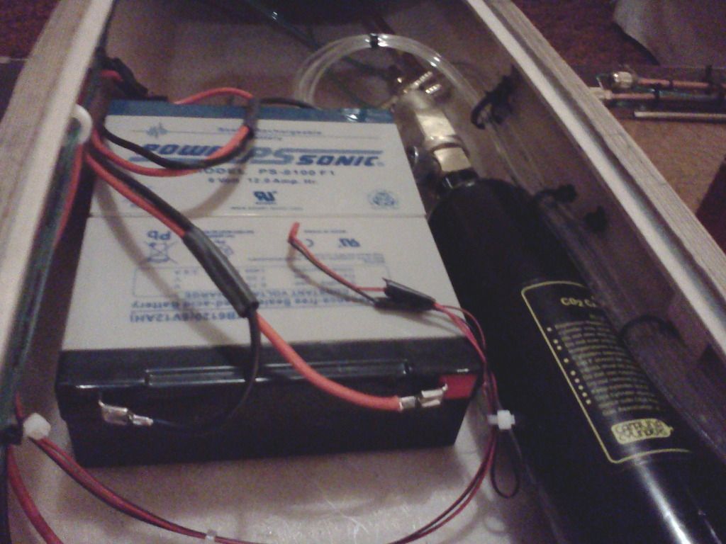

    co2 setup and battery arangment. (still figuring out weight distribution)
    And here is everything
  16. NASAAN101

  17. Jay Jennings
    One thing you may want to consider is taking the ESC out of the box as it can generate quiet a bit of heat. I have several of the same ESC, they are waterproof and I put all of mine in the water channeling to help keep them cool.
    The boat looks awesome and there is always room for another Axis Captain.
  18. gunsnrosesx
    gunsnrosesx Member
    Sep 11, 2011
    413
    which would be great to battle her but i cant as she is a show boat and i didn't wanna cut into the hull. now i will be most likely ordering the lotzow for my battler. and thank you for the advice i will do that now.
  19. DarrenScott
    Very good call with the ESC, it will heat the air in the box, causing it to expand. This isn't bad in itself, as excess pressure will find a way out, but if you get sunk the air cools rapidly, and combined with the outside water pressure, you'll get water ingress, or at worst, the box may implode. Not good.
