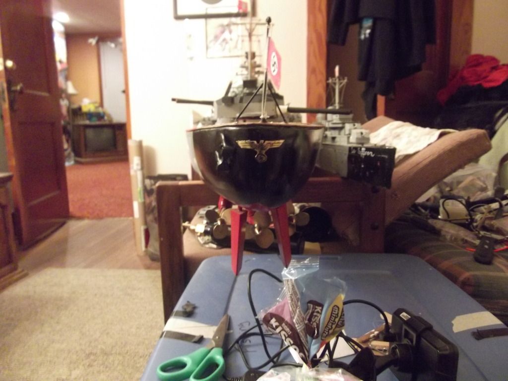

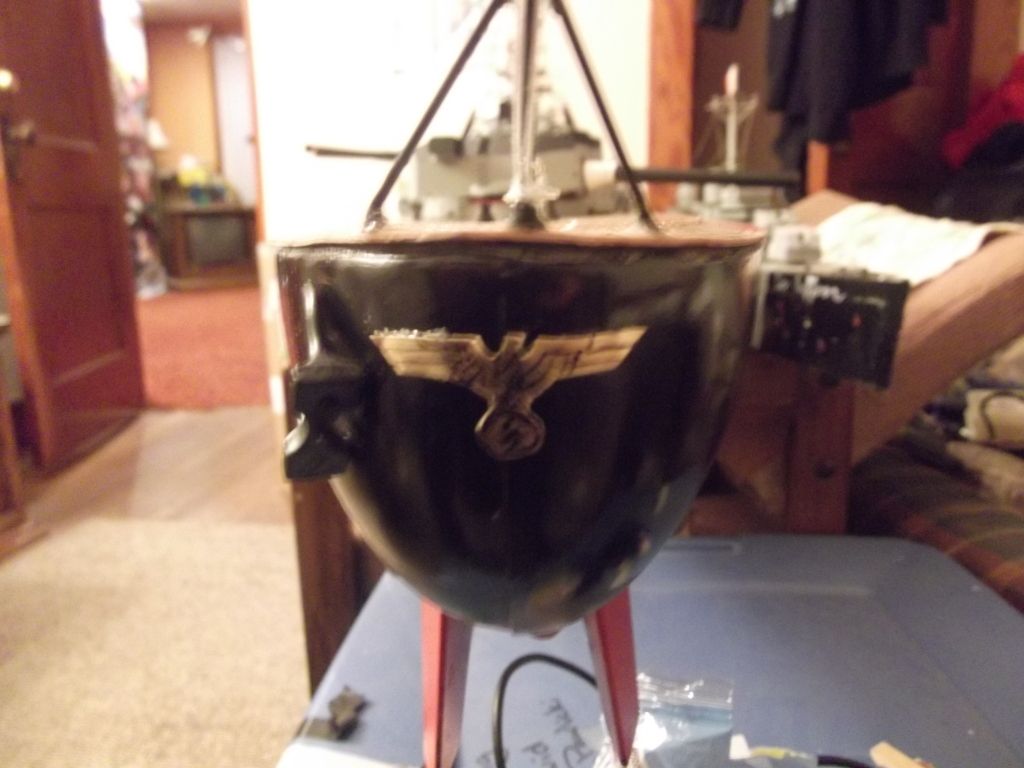

    I am adding little more detail to the superstructure (thank you Curt for pointing that out for me) and i also added another peice i have been wanting to add for a wile to my ship but didnt know how to make it and make it semi detailed so here is a picture of it.[​IMG]
    sorry the best my camera could focus.
    5,754
    Looks good. Did you make that?
  13. gunsnrosesx
    gunsnrosesx Member
    Sep 11, 2011
    413
    yes i made that i coppied the picture on a peice of paper and i zoomed out on the internet so i could make it roughly scale. once i had my template i taped it on a peice of brass, then cut it out and put on all the details with a pen. But i knew pen would come off so i coated it with polyurithane.
