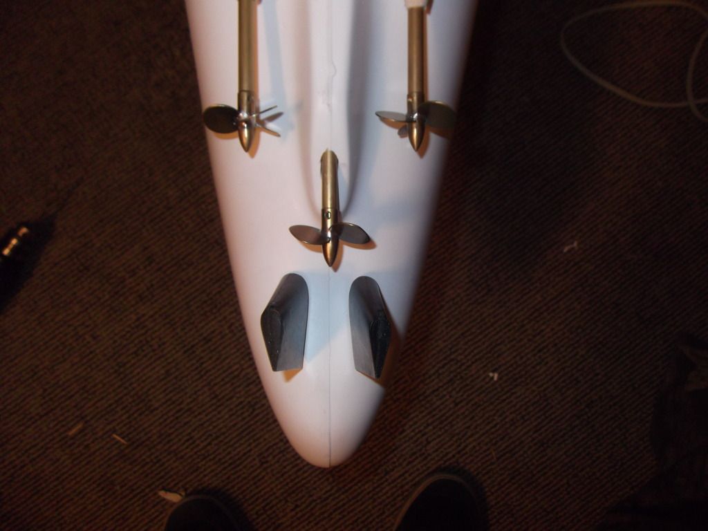

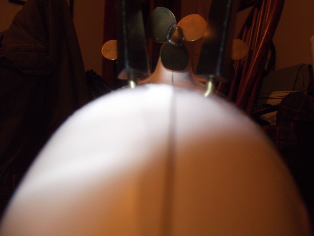

    Im aware that my one ruder is about 1/16 or 1/8 of and inch forward hopfully no one notices haha
  14. mike5334
    No one will see the rudders when the ship is in the water. ;)
    Nice job with the shafts. Very neatly done.

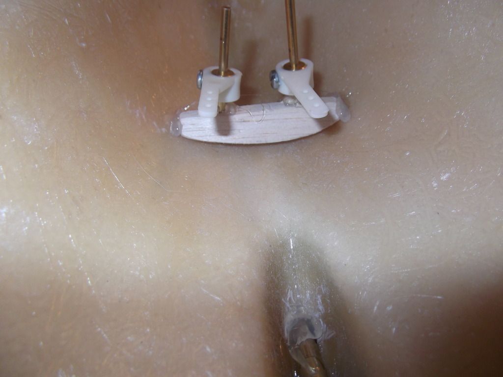

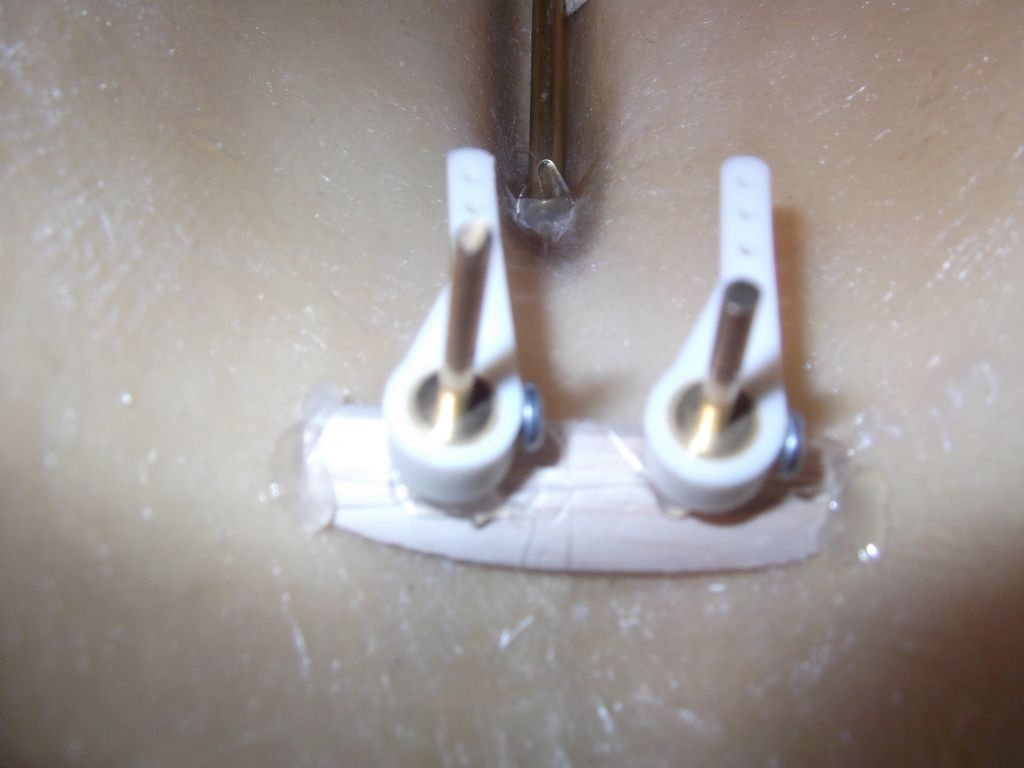

    The rudders themselves are just fine . It looks pretty close with the rudder posts inside the hull. This may present a problem using the arms to get enough space for the levers to move side to side. You will need a third arm on one of them to connect to the servo .You want to ensure you have space for the arm at top to swing .At this stage gears may work better but a test fit with them will tell for sure.
    The props themselves look good. Just make sure you have the posts aligned as best as possible.
    Looks good . Keep it going.

    i can always cut the arms down to a certain length cant i?
    Yes you can.
