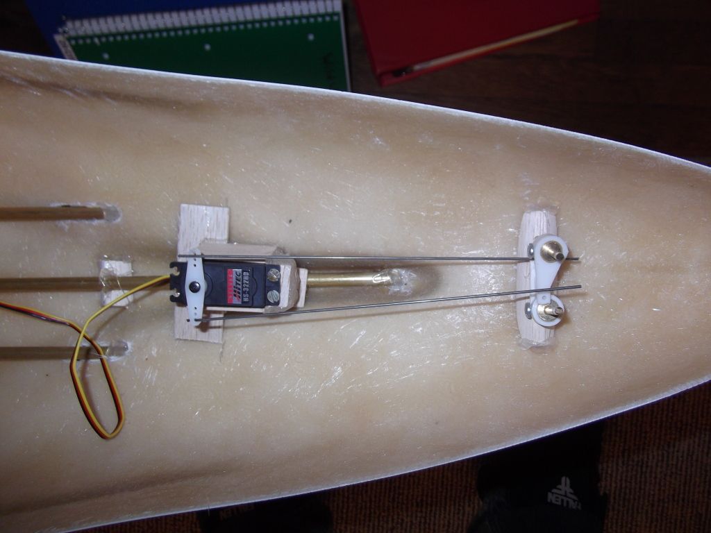

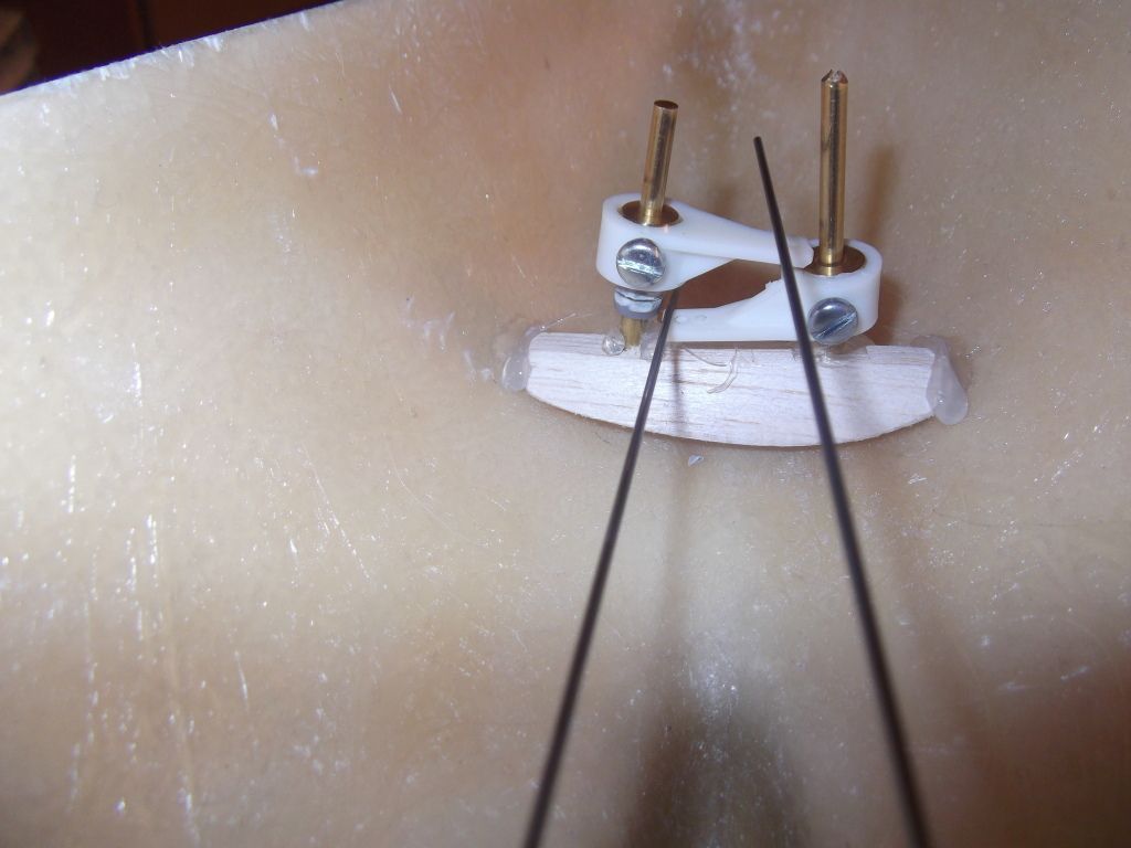

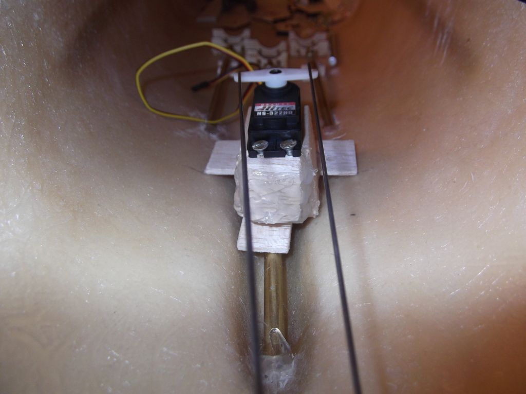

    pictures above are not tacked into place simply laying them out and making sure everything will work, hopfully it does
  13. CURT
    Looks good so far. You may want to make a larger support bottom plate for the servo to anchor too. The plate can be attached to the sides of the interior of the hull and secured that way. More support under the servo tray( plate) will keep it level and keep it from moving. Your getting the right idea. It may not be perfect the first time but as long as it works and works reliably then your on your way for future ship builds and improvements. I didn't get it perfect the first time and it's been a long process. It's evolving and I am still trying different things. That's what makes it fun. Make sure you test it first before securing it with your adhesives. Overall good job!

    is it better if the rudder servo is closer to the rudders with shorter rods or farther away with longer rods like my setup above, or does it not matter?
  16. NickMyers
    Shorter rods will flex less
  17. rarena
    Watch the clearance of the servo with the deck/subdeck That usually limits where it goes. In an armed ship, shorter would give more clearance for d turret guns also.
  18. gunsnrosesx
    gunsnrosesx Member
    Sep 11, 2011
    413
    thank you so prety much the longer the more turn of the rudders?
  19. rarena
    No, just makes it more flimsy,
    To adjust throw move out from centerpoint of servo. For example, mounted close in on the servo arms gives less throw than all the way at the end of the serve arm.
