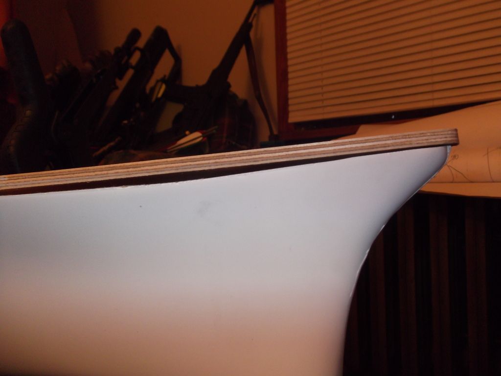

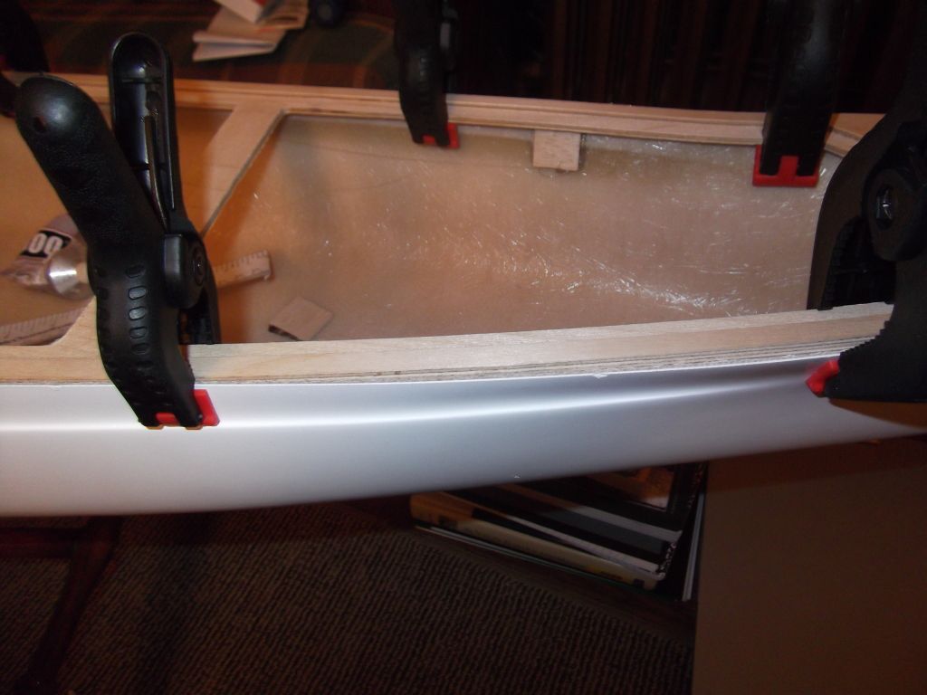

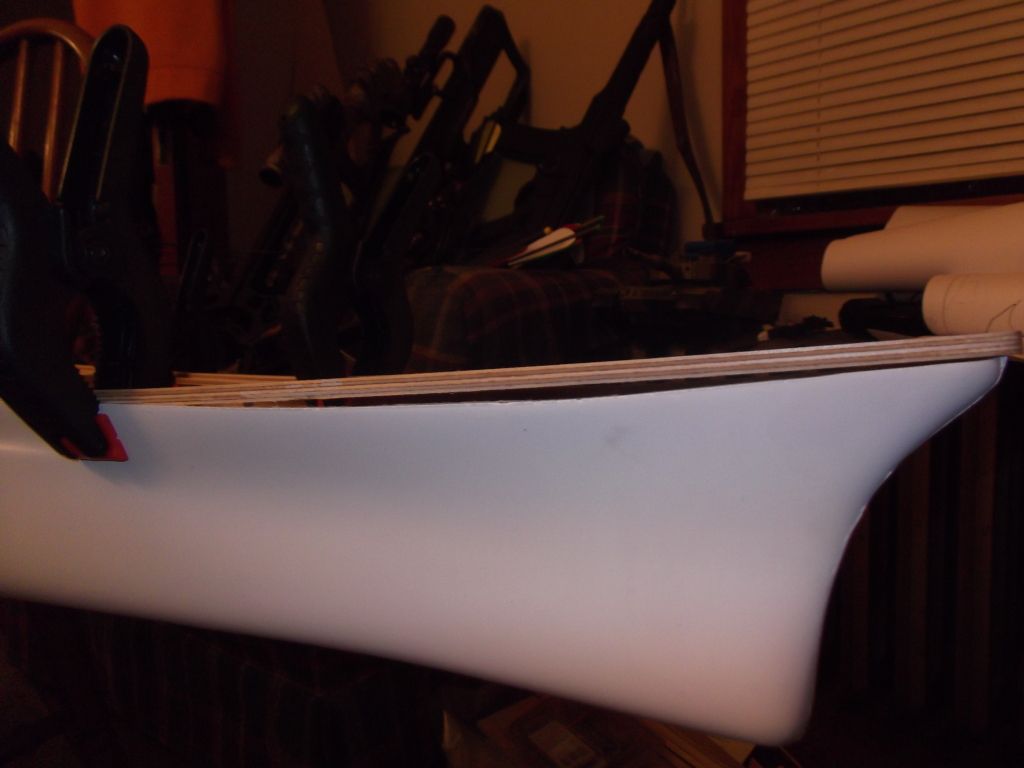

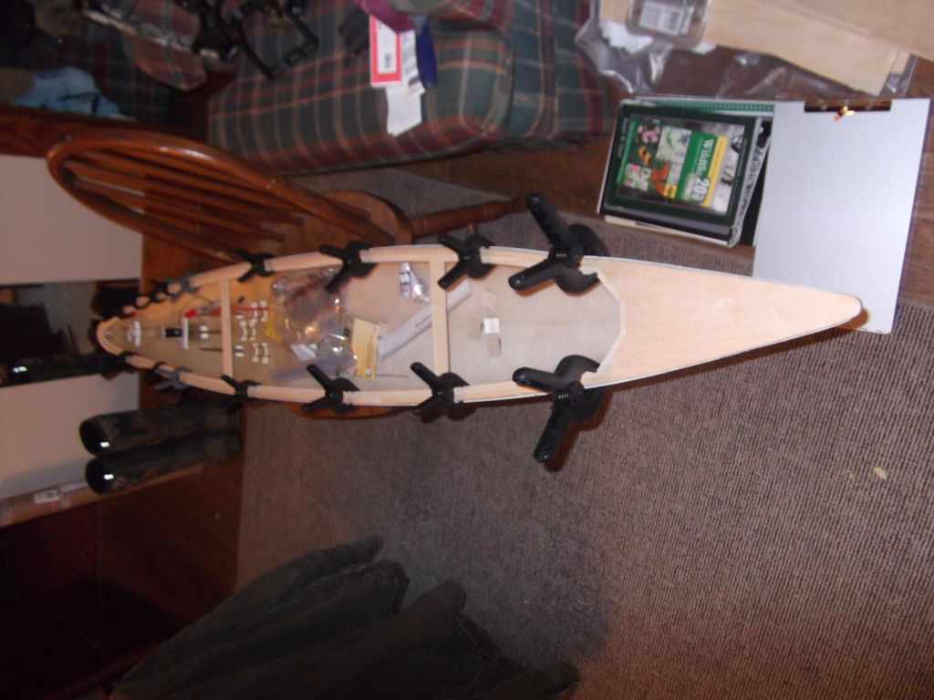

    Having some over lap, im just wondering if this is normal before i cut?
    And is E-6000 good to use for this deck? and im going to be reinforcing with hot glue as well

    There is more material in the sub-deck than I would have expected. At the stern, is the sub-deck sanded to shape and is it flush with the top of the hull?
    I'm looking at the second picture in the series. Has the sub-deck been beveled via sanding? That second picture shows the transision in the hull from being almost vertial to having a significant angle. I cannot tell from the picture if the sub-deck has been sanded. Idealy, the top of the sub-deck should be flush with the top edge of the fiberglass hull and that requires the part underneath be sanded down to conform.
    When installing the sub-deck (after everything is sanded to shape), I'll use either clamps (similar to what you have in the pictures) or a series of straps to secure the sub-deck in place. I'll then use spots of CA to tack the deck in. I'll then put masking tape in spots along the top of the sub-deck and hull before puting spots of epoxy along the back side of the joint between the hull and sub-deck. Turn it upside down and let the dabs of epoxy flow into the joint and let it cure (the epoxy will not stick to the glue of the masking tape for Scotch brand tape). After both sides are done, the clamps and straps can usually be pulled off, run a big long stretch of masking tape along the whole joint, and thoroughly epoxy each side up from the back so that the epoxy can run into the joint.
    I did this with a test hull I picked up while searching for a good fiberglass shop. This hull had bulged out over an inch out on both sides from where it should have been. It seems to be working fairly well, though I do not have it in the water yet. I've been using West System's G/Flex for my epoxy, as it is capable of a little more abuse than the normal epoxy they put out.
    It does look like the sub-deck might need to be shortened a little bit. Let me know about the fit in the aft and the conforming bevel done in the bow section.

  19. mike5334
    Yup, looks like the subdeck will require some sanded bevel edges to fit, especially the bow and stern areas. It is normal to have to bevel sand the edges.
  20. CURT
    Typical of sub deck installation. Mark the sections that need to be beveled and sand down , test fit again. You will do this several times till you get the fit just right. Don't bevel too much at a time. This part of the construction will require patience but the end result is a good fit. Any little gaps can be filled in with bondo putty and resin, or just epoxy resin.
