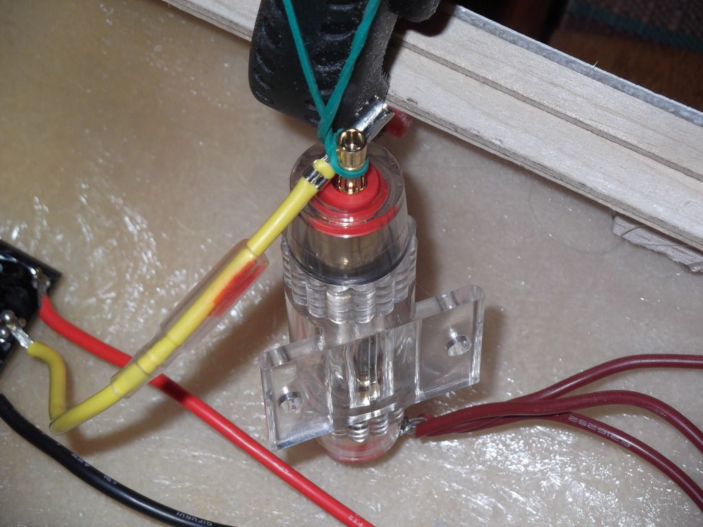

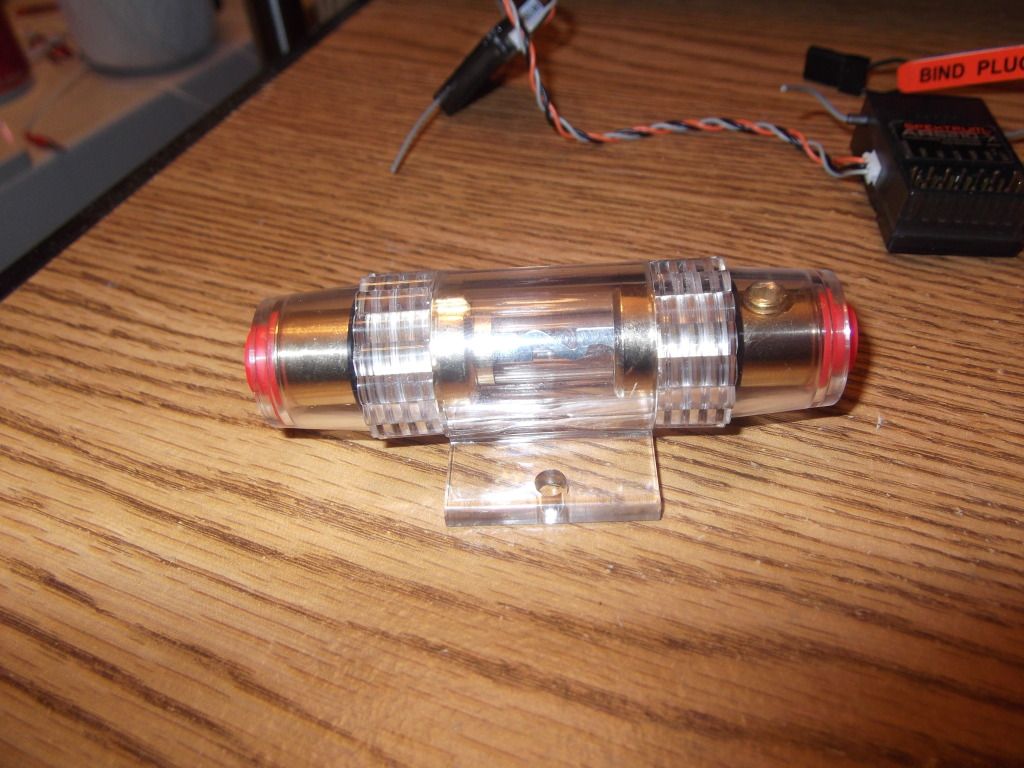

    fuse... idk where to put it, should i use it? haha i got no idea, help
  3. NickMyers
    Inline between the ESC and the motors.

    just the positives or just the negatives?

    Not a fan of fuses. I would be inclined to pay attention to the specs of what I install and skip the fuse. If you aren't worried about a competitive propulsion system then do geared smaller motors and a big amperage esc. Fuses have a way of popping for random reasons, IMO.

    so just by pass the fuse and run it straight, remember im just using as showboat, i do want the most speed and power out of my system
  7. NickMyers
    SHowboat or warship, it doesn't matter.
    You fuse to protect your ESC and other components. Stalling out a 550 motor can draw 60+ amps which could in theory melt your wiring and burn out your ESC if it isn't up to handling that much.

    ok thank you im just going to put the fuse on my positive wires that way ill be safe.

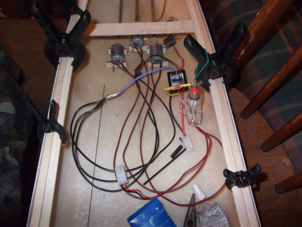

    Rc setup, just a test, all will be put in radio box when finished just testing works good ecept for a few things need adjusting

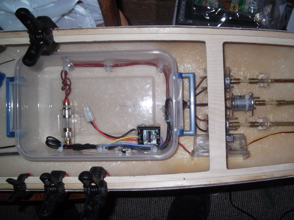

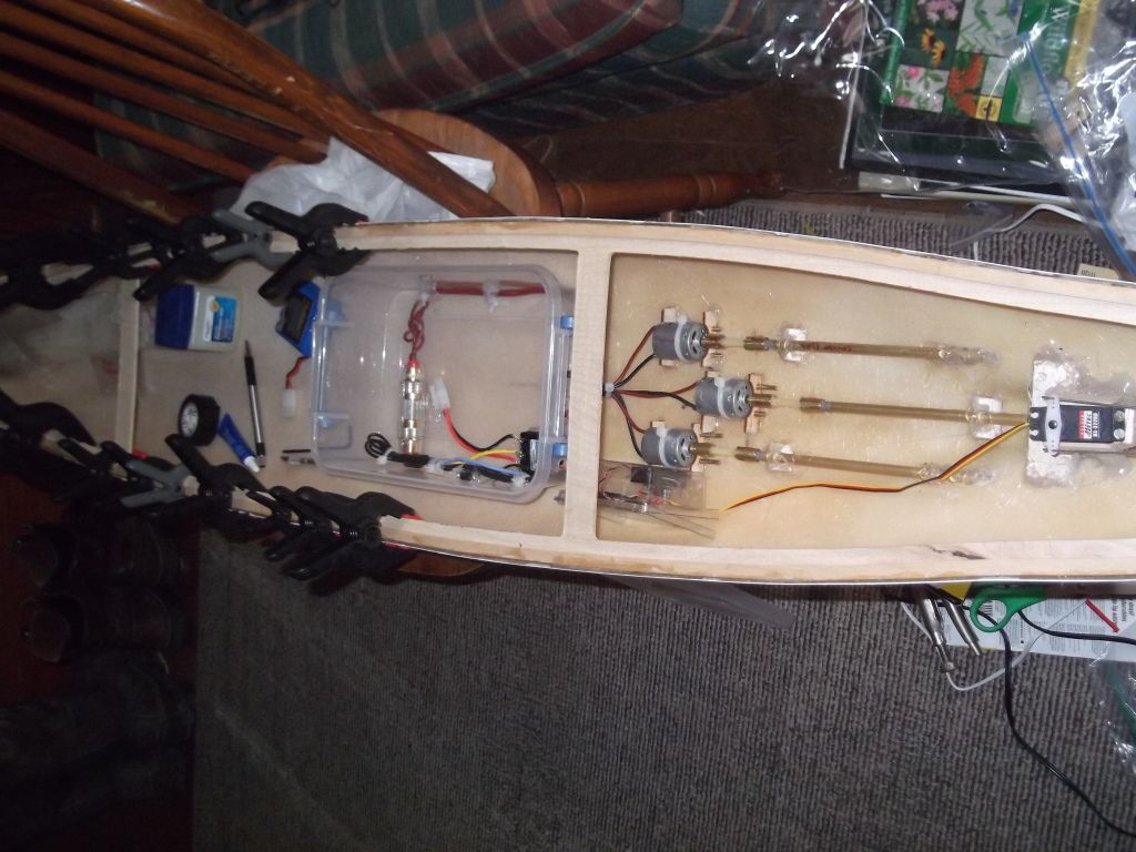

    installing sub deck
  18. gunsnrosesx
    gunsnrosesx Member
    Sep 11, 2011
    413
    installing subdeck and radio box's
  19. rarena
    Nice and clean install. Looks good.

    thank you had a test run an wow goes pretty nicly and turns great but i had to move the port side and midship motor mounts forward because the dog bones came out. another minor prob is the loudness it seems loud but that might be normal. oh and can my receiver pick up the transmitter through the tubaware container?
