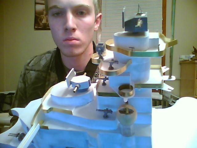

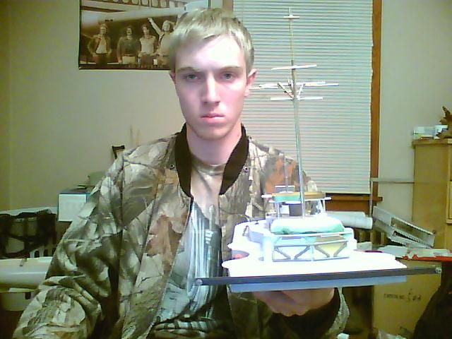

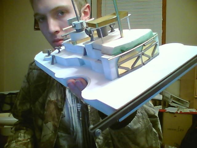

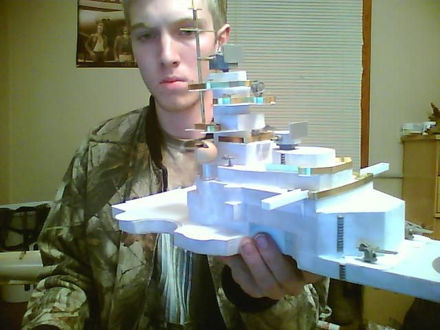

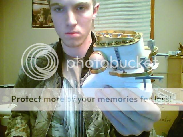

    thank you very much and it was difficult in some parts but i got it done. there will be alot more detail added i actually have a few blue devil destroyers 1/125 scale with ladders, small guns, and other many things and if u look at my radar thing at the top that came off the destroyer

    Cool way of finding scale parts. I made my masts of toothpicks. I was leary of putting weight that far up on a combat model. The mast did not last the season so I suppose sometime I will have to take another shot at it.
    Nice job so far!

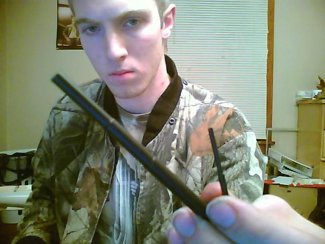

    Thank you and as for mass i have an excelent idea what you could use. plastic tubing, its very light and flexable and its cheap and i would recomend meltime the peices rather than gluing. i was going to use plastic but i wanted it sturdy and my ship is a show ship. i beleive in my local hobby shop at the train sextion there are loads of things u can use.
    Thanks for the pics. I see the rails look like thin brass strips. I have thin sheets I can use instead of the styrene plastic.
    The funnel looks like it's made of the same material. Good. I will use that too. Your smokestack carved or styrene kit?
    Cranes look good. Brass cranes will hold up to damage. Mine have mostly. Once a very large modern frigate hooked the crane and ripped it clean from the deck. I never recoved it.
    The radars looked familiar to me. I remember cannoblizing many parts from various models then using all kinds of house hold items and stuff to add detail.
    Loved it when someone would be concerned about the cost of the detail that it would be shot off , when infact it was very very cheap and expendable. Easy to replace too. I used to use hollow brass for the main mast and used solid brass for the yardarms. I would weld them to the main mast and each other. It makes it extremely strong to bb abuse. The hollow brass of the main support post would be dented from dings but you can sleeve it to add more protection. The dings and dents tell a story after battle.
    I will have the opportunity to catch up on the work of Bismarck this weekend so I will be taking pics.
    Keep up the good work.
  7. gunsnrosesx
    gunsnrosesx Member
    Sep 11, 2011
    413

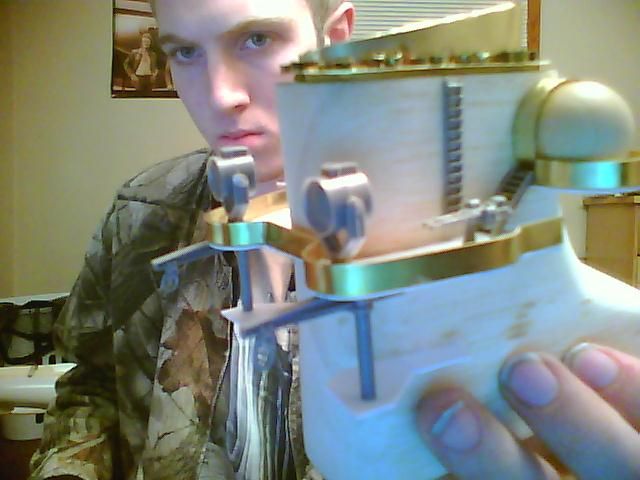

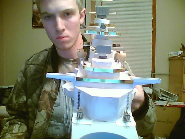

    Thank you curt, yes the smoke stack is balsa that i carved and rounded off, then i used the styrene for the small decks on the stack then used .032 x 1/4 in brass strips for the rails as for the cranes idk if i want them to like swing out for show or not considering my ship will be a show boat. and as for the detail items im just taking off of models that i dont really care about and they go good. also i found a few neat little things in the train section of my hobby shop that i might buy. as for your bismarck i cant wait to see the pictures....if you want u can post them on here if you would like too.

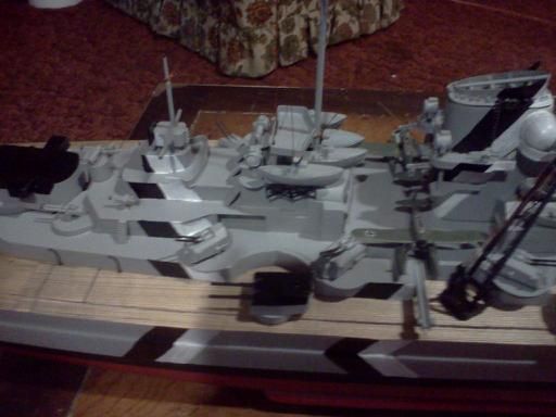

    UPDATE

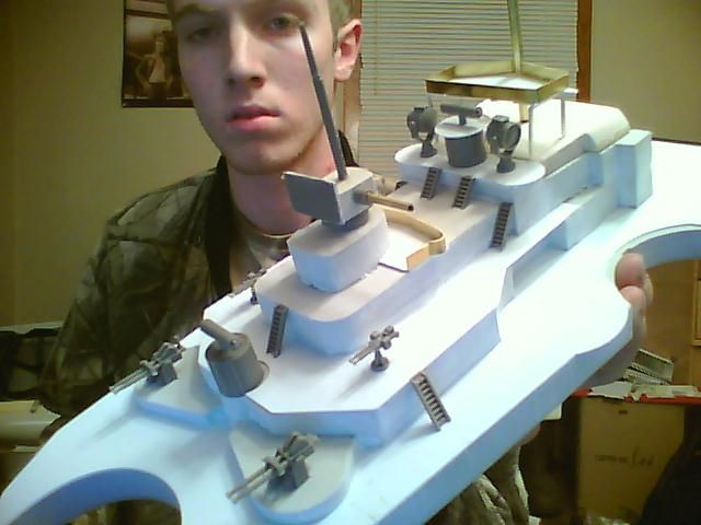

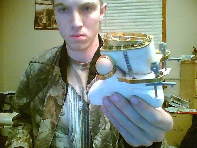

    So i pretty much finished up the small details im adding small doors right now....wont be in pictures below. but here is the updated bismarck, and i also finished painting the cranes and barrels to the turrets check it out.
    Looks fantastic. Are those AA guns from a kit or scratch built?
  16. gunsnrosesx
    gunsnrosesx Member
    Sep 11, 2011
    413
    i took all the detailed items from the 1/125 lindberg blue devil destroyer i have alot of them sitting around.

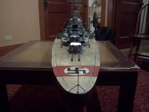

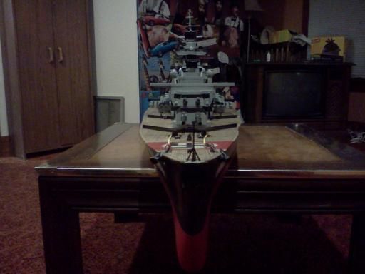

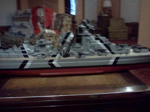

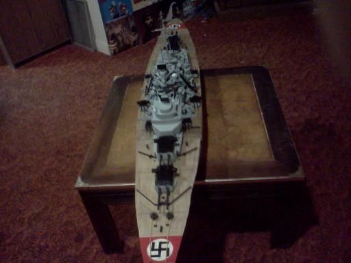

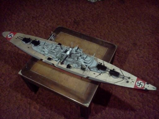

    here is the finished product, gona add a few small lights to is still and i ordered my cotton flags for it
