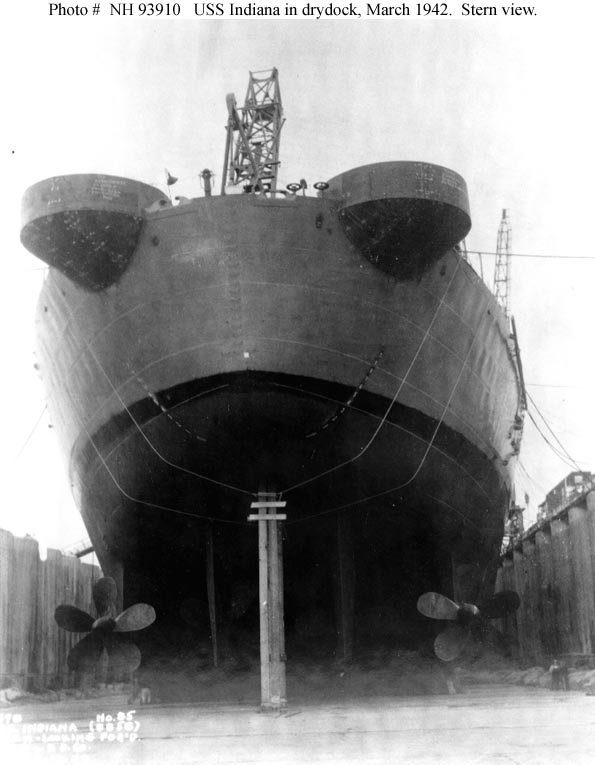

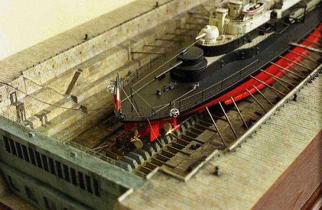

  6. djranier
    Now that's a different prop, rudder combo. I would agree power all 3, should turn going in either direction.
    The SD has a different layout also, but I have never seen anyone have their running hardware installed in it properly, but I like the Henry layout better.
    Builders model
  7. NickMyers

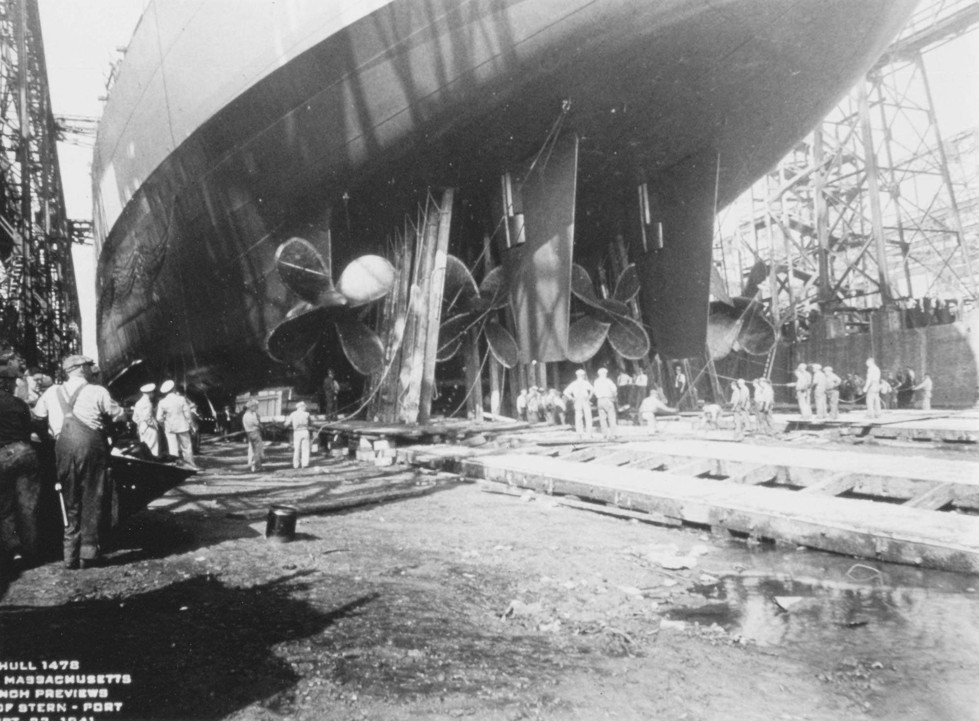

    Can someone explain why the SD is relevant here?
  8. Lou
    props past the rudder,
  9. Lou
  10. NickMyers
    ahhhhhhhh
    interesting
    hadn't realized they put those outboard props so far back
