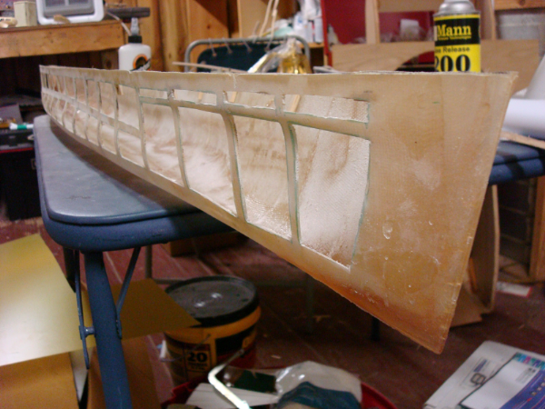

    This hull has some defects from my inexperience (second one is miles better). The chippy lok around some of the windows is due to my shaky hand holding the Dremel with insufficient sleep and/or caffeine...
    8" later after I get the wood backing on them.>
    Here's a pic of the bow area after cutting out the stbd side windows:

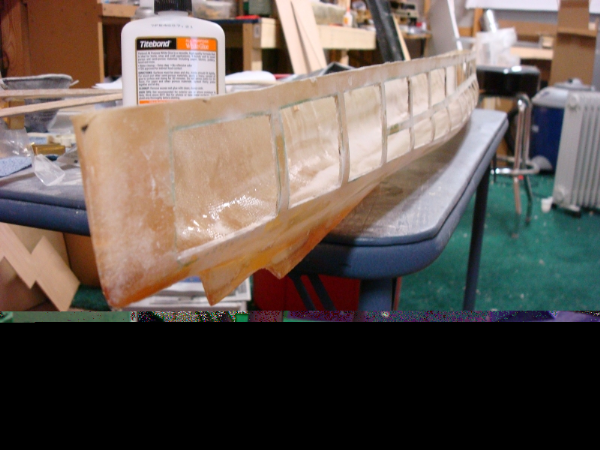

    Followed by a pic of the stern:

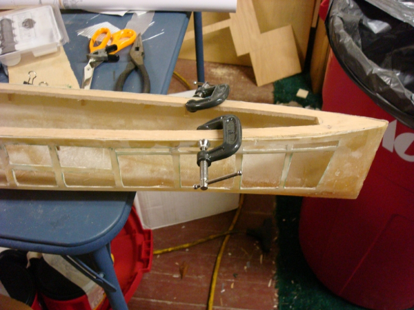

    This view shows the subdeck fitted with some clamps for fitting prior to a lovely epoxy-based wedding. The bridesmaids will wear balsa, the groomsmen chrome steel.

    For a first hull she looks real good Clark. The small imperfections like you said you cut most of them out, and anything else you can repair anyways.
    I do have a question, is the bottom cut from the waterline a inch, just from what I see it looks like you may of cut too much up forward, but hard to tell by the picture, no reference. You might of been asleep when you were cutting the bottom of the windows out, lol. But then of course without knowing where the waterline is, it could be right on.
    I may have gone a little further than I had to, but I've never had belows that far forward and that far down :) Plus, nobody can say I'm not in compliance with the rules :)
    The first hull, I didn't have some of the special tools, but came out okay. The second one I had the lil rollers to smooth it out effectively, and there aren't surface defects. Looks sweet :) Brian and Pete were appreciative of how thick the hull was when I was cutting the windows, so I'm doing well on that score. The second one also was a major improvement in eliminating air bubbles. Also on the plus side, I've been getting better with materials use, so I won't have to charge as much as I thought to make a reasonable profit, probably in the $100-$120 range for a Kent. When I have another one done, I'll put the "buy it" button on the website.

    Hey Tugboat. In the very top photo, in the upper left corner, is that what I think it is? Post some more pictures, please!
    I find it very interesting how large of a subdeck you use. For most of the fiberglass hulls in my club, the builder glues in a bunch of small blocks to support the deck, rather than making a whole subdeck and inserting it. Is my club just weird, or are you doing something new?
  8. SnipeHunter
    Ive used both methods, I personally like having a whole subdeck. Using just little blocks I was never able to get a good deck seal without screwing the deck down, maybe thats just me. With an entire subdeck I can run a bead of silicone around that the deck sits on and provides a much better seal. Most of the boats I see use an entire subdeck, maybe its an east coast, west coast thing? Eeeeeeast Sideeeeee
  9. Gascan
    I'm curious too. What is that, Tugboat?
    In all the fiberglass hulls I've seen in the WWCC, the subdeck is built up with small blocks of wood. The wooden hulls have a large, one piece subdeck, but I haven't seen it in the fiberglass. One reason may be that wood is much more popular than fiberglass here. The other reason I can think of is because they haven't figured out how to stick a proper-sized subdeck into a fiberglass hull.
  10. Tugboat
    Most of the subdecks I've seen are the style shown in the pics. The big downside (for me personally) is that it takes more sanding and fitting than I'd prefer. I start with tracing the fiberglass hull top edge onto 1/4" ply and then cutting a shade inside of that. It still takes a mess of sanding to get it right, but with the way some people's guns fire these days, it's good to have the fiberglass backed up. (I think that the MWC is going to have to go with a foam test like many other clubs. I know many people who don't like having BB's chew through fiberglass!)
    I did do a laminate style subdeck on the HMS Lion I built years ago, building up a subdeck with strips of 1/4"x1/16" strip. I will probably do my next one (whenever that is) in the laminate style. I'll try to get Brian K to take a pic of it (I gave the ship to his son a couple of years ago and its lots nicer than when I first built it, altho my subdeck still remains) Regardless of method, I like to have a good tight seal between deck and subdeck. Aussie's back deck will not need to be removed to reload the twin sterns, so it'll get sealed with a thin layer of RTV for extra protection.

    I spent a few hours on my own stuff today, got the rest of the windows cut, and the subdeck partially fitted.
