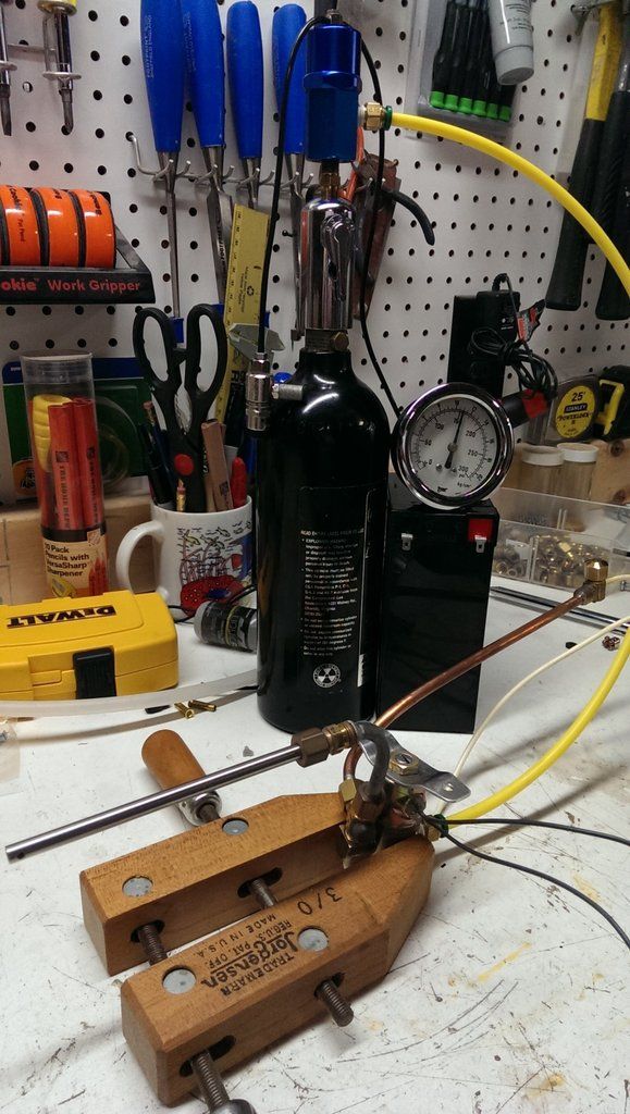

    Testing the cannon just built. Found an issue with it. Couldn't get anywhere near full tweak without excessive double feeds. Could only punch through one side of a soda can at the lower tweak! :( Think I might need to lengthen the piston a bit.

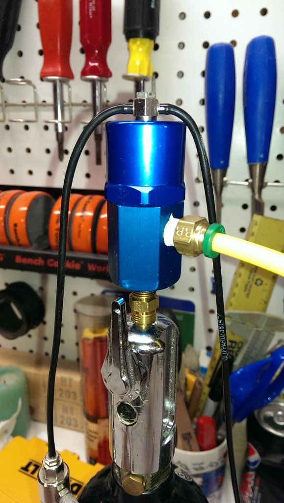

    This blue beauty is a Holly nitrous oxide injection regulator. I picked up two off of eBay for $20 (regular $80 each). It was a speculative buy since the reg comes in 50, 100, and 145 versions (depending on spring supplied) and the seller didn't know which ones he had. They turned out to be 100psi and I was able to shim it up to 150 easily enough. This is half the weight of my old brass reg. Just need to get a compact bottle adapter from Palmer Pursuit to finish it off.

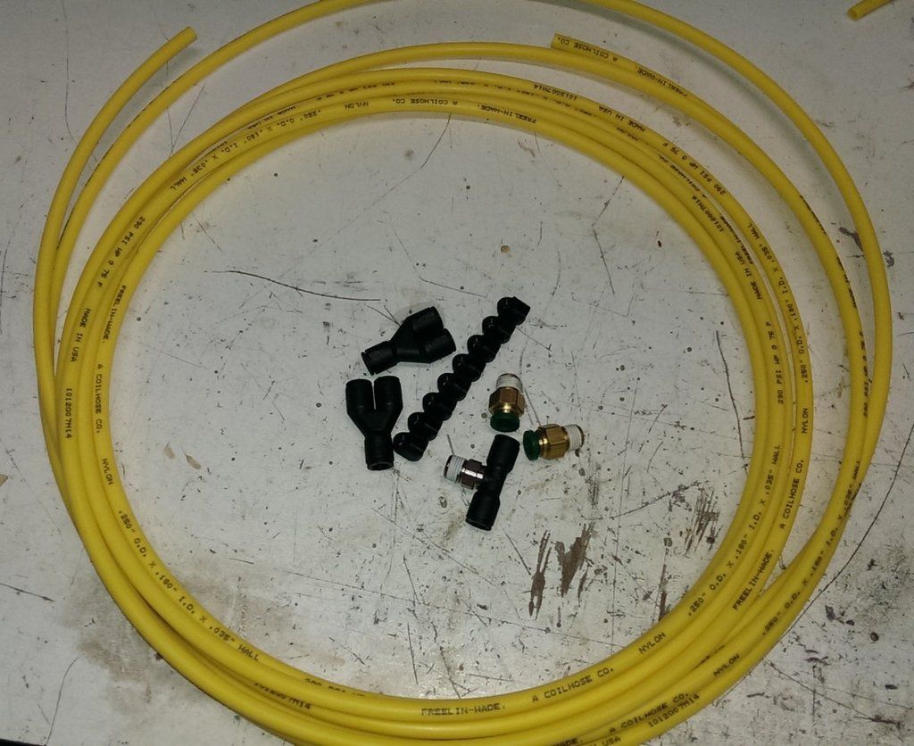

    Cool stuff from McMaster

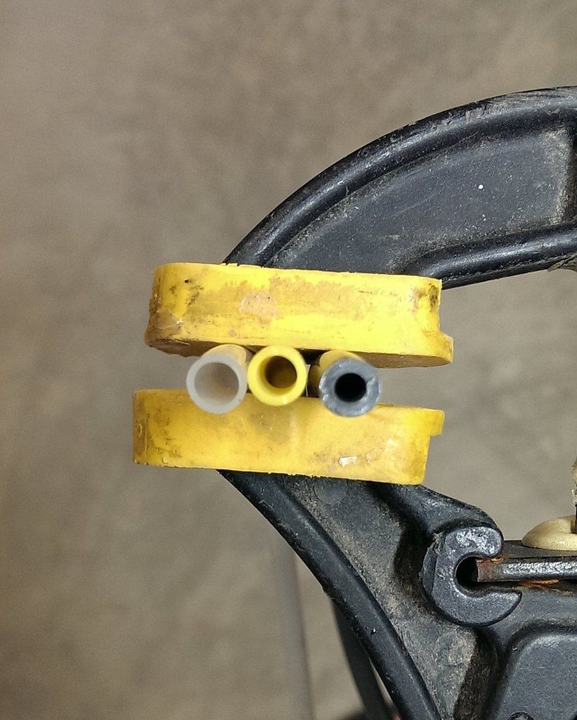

    These are three different types of tubing I've been playing with. The grey 1/8" ID on the right is the old standby Clippard polyurethane tubing. The yellow stuff is nylon .18" ID rated at 250psi. The white stuff is a stiffer nylon .19" ID rated at 550psi (bb's flow easy through it - hint, hint ;)). My thinking is that an adequate length of the bigger ID nylon tubing will give as much of a gas reserve as the various reservoirs I've seen in use for less effort and expense. Coupled with the matching ID push-to-connect fittings, a clean and smooth gas path to the solenoid is achieved.

    Good build, Steve. Do you have the part numbers for McMaster stuff you purchased?
  4. SteveT44
    • Push-to-Connect Tube Fitting for Air Wye for 1/4" Tube OD - 5779K44 - Each $4.75
    • Brass & Nylon Push-to-Connect Tube Fitting Straight Adapter for 1/4" Tube OD x 1/8 NPTF Male - 51025K177- Each $1.79
    • 8 Clip Strip for 6mm, 3/16", OR 1/4" Tube OD Push-to-Connect Tube Fitting for Air - 5779K429 - Each $3.58
    • Choose-A-Color Flexible Nylon Tubing .180" Id 1/4" Od, .035" Wall Thickness, Yellow, 25 Ft. Length - 5548K65 - Each $11.00
    • Push-to-Connect Tube Fitting for Air Swivel Inline Tee for 1/4" Tube OD x 1/8 NPT Male - 5779K174 - Each $4.61
    • Vacuum-Rated Nylon Tubing, .190" ID, 1/4" OD,.03" Wall Thickness, Semi-Clear White, 25 ft. Length - 5173K94 - Each $7.25

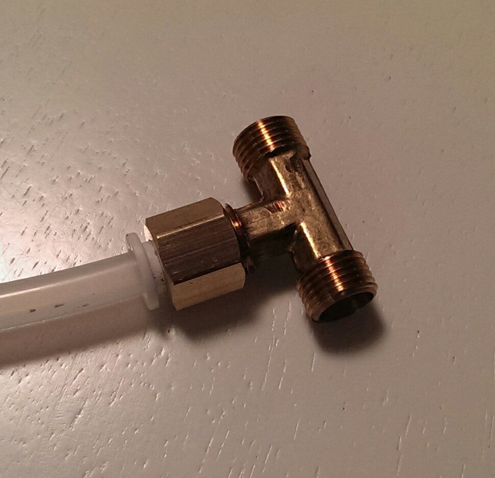

    Think I finally perfected a solid plastic to 1/4" compression connection. Flexible mags and up-tubes? o_O Hmm........

    Would love to see the details of those mags. Hard to tell from the pics but it looks like he used tube inserts and compression fittings. Also, if he's using 3/16" ID x 1/4" OD PTFE, that stuff only has a max rating of 175psi. Not much of a safety margin. I'm not using an insert so there's nothing to inhibit bb flow. Also, the nylon tubing I'm using is rated to 550psi. Pics will be up in a couple of hours.
